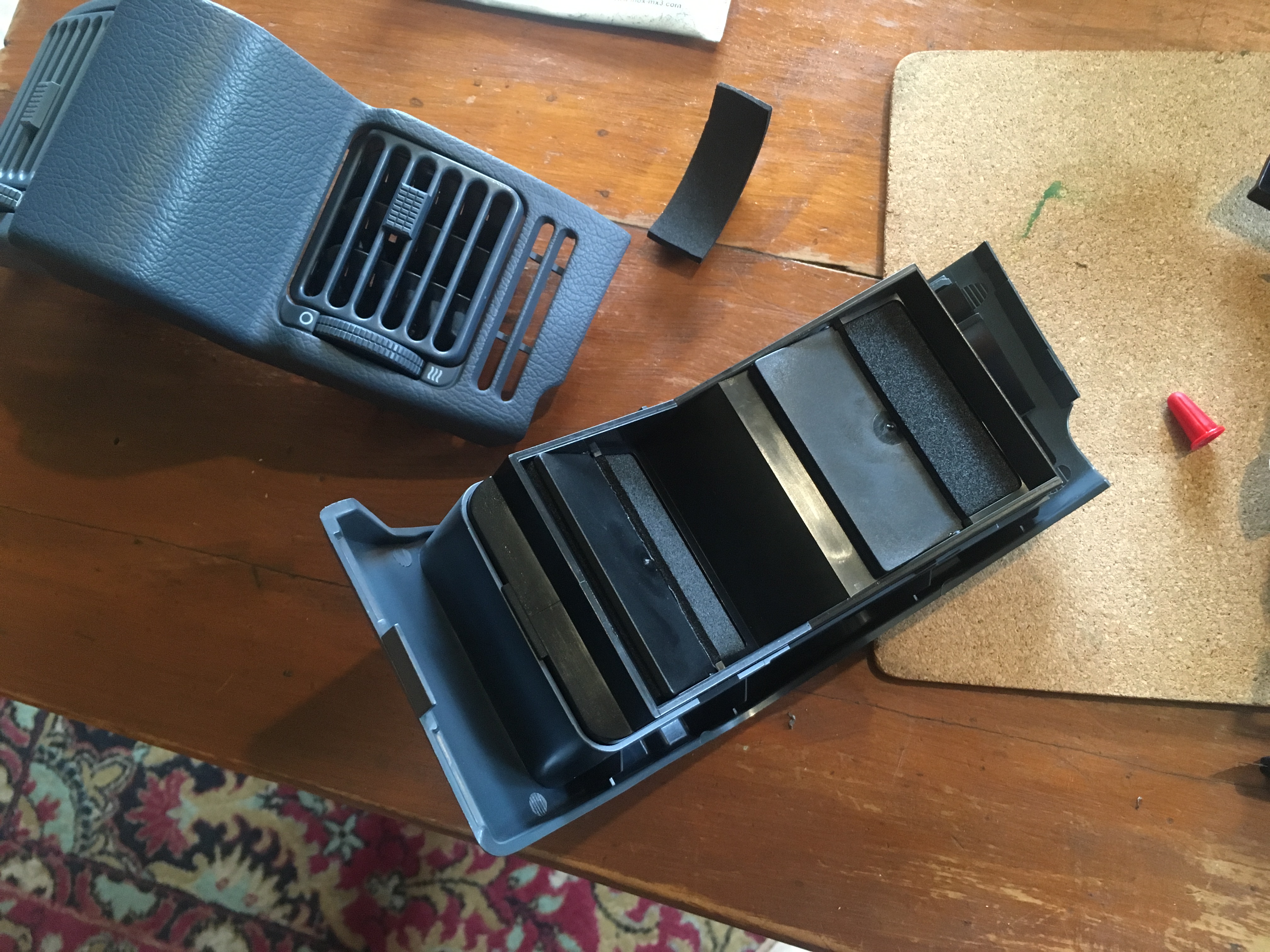

Rebuilt the side vents, new internal seals, clean, lube and ducting foam seals done.

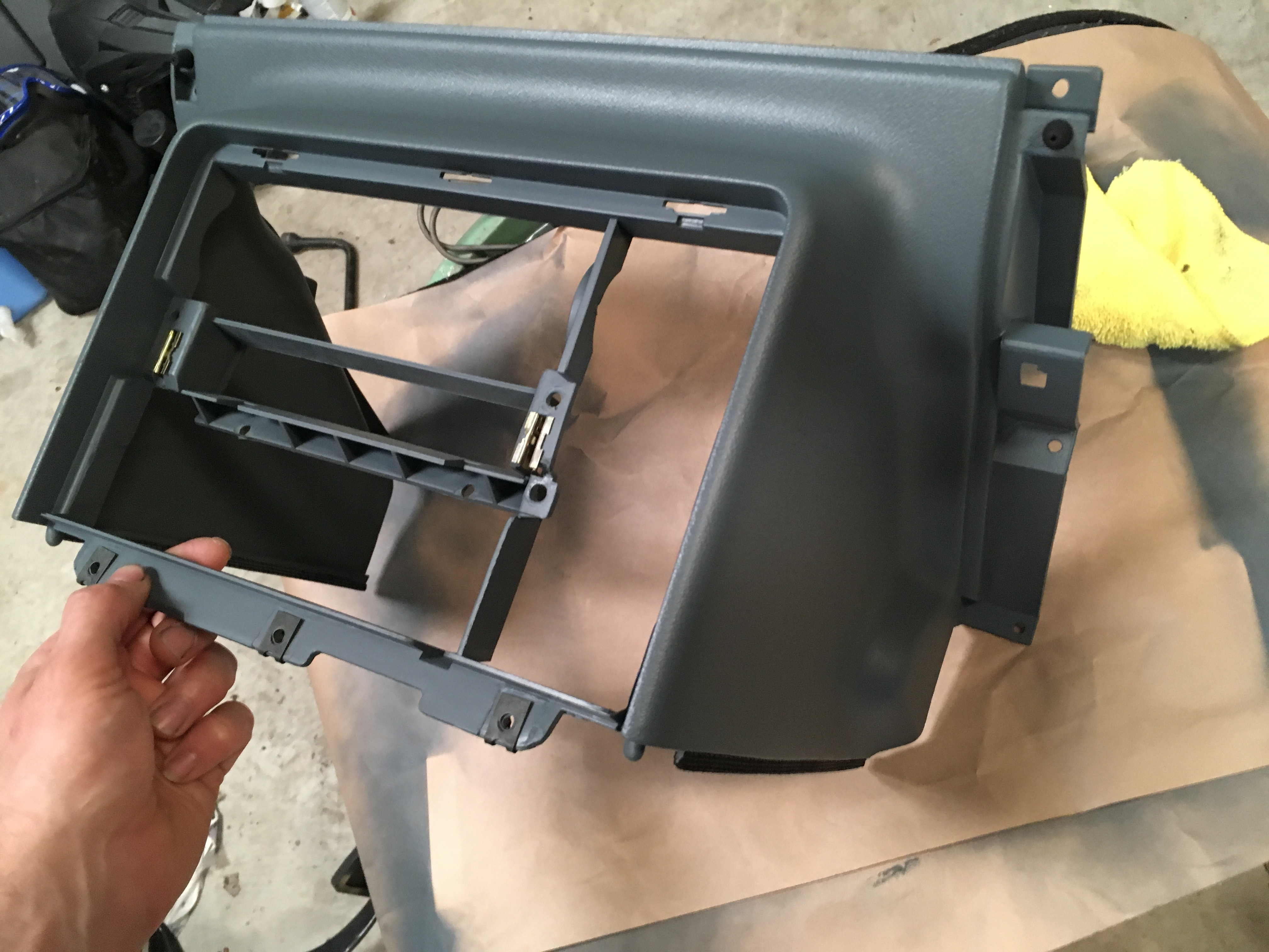

Then I gave the console/radio surround a once over. Re-dyed it to with custom to original spec vinyl dye.

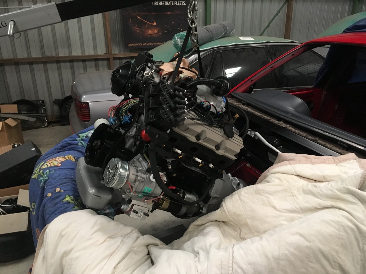

Q helped me install the engine. Damn is was so much easier and no damage by installing engine/box in from the top and then bolting the K-frame in underneath with PS rack and hoses already done with the unit still suspended by the crane and trans cross-member already bolted up. Met them up in the middle and went without a hitch.
We were done in about an hour if that, we maybe longer as we were talking shit as usual.
I put blankets around not to scratch or chip the paint and also protected the rad support as I climbed in and out of the bay.
Engine in but something wasn't right, it was on an angle, left header wouldn't fit as it hit the floor and the shifter was way off to the right.
Found the tuff mount was too tall and with stock genuine mount on the other side the whole engine was tilted by a heap.

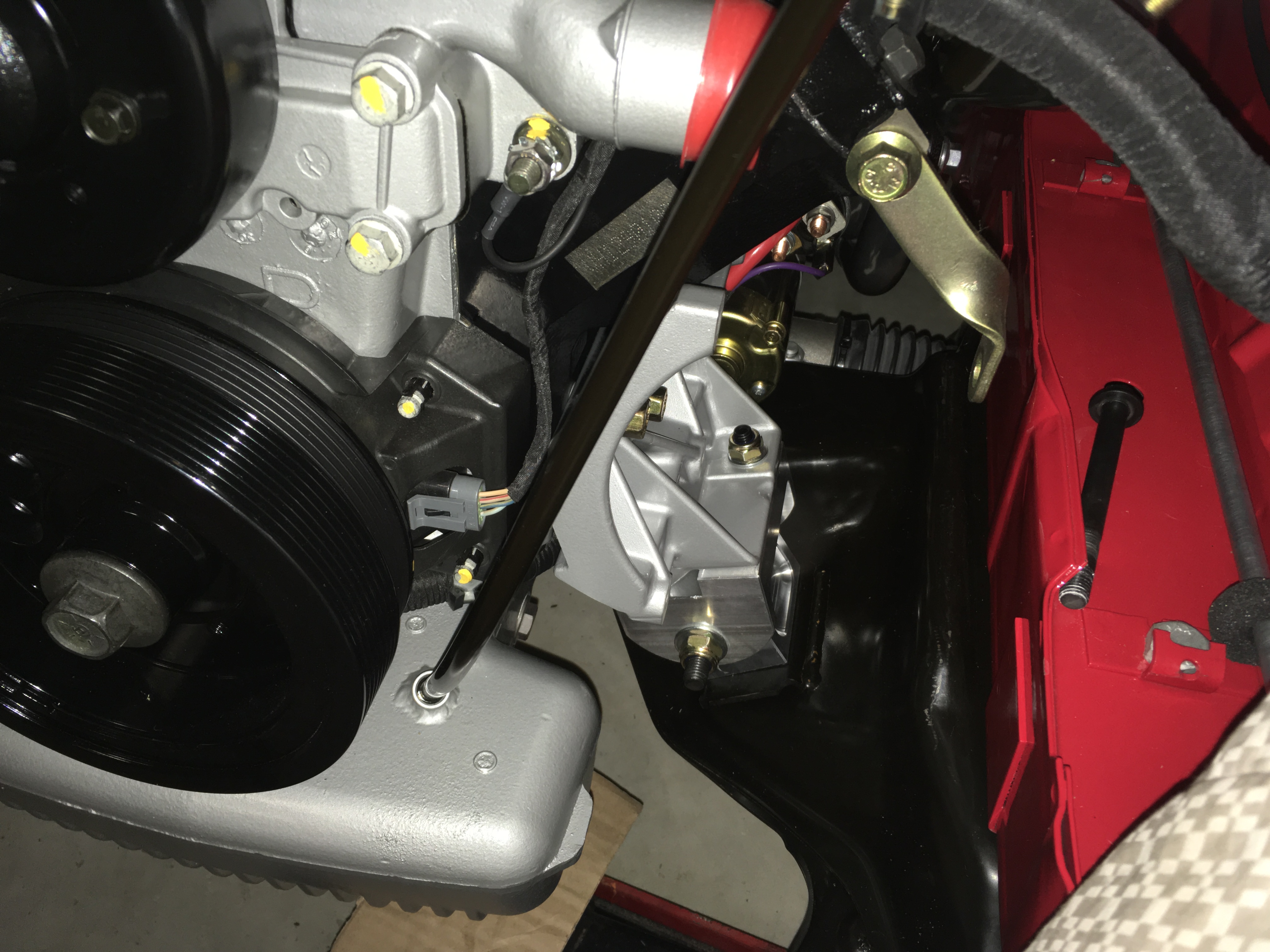

While I had it out I took the opportunity to fix the corrosion and flaking paint problem I found after I put the engine in on the AC/engine mount bracket as originally this was only done in VHT silver paint and that was over 2 years ago now, started to corrode as its not a well sealing paint. Finally I got that blasted and painted in rust bullet, my fav of course and also the DFI bracket as it was the only other item not rust bullet'd , also VHT spray can.
So every alloy part on the whole car is basically blasted and painted in rust bullet. Fuck off corrosion!

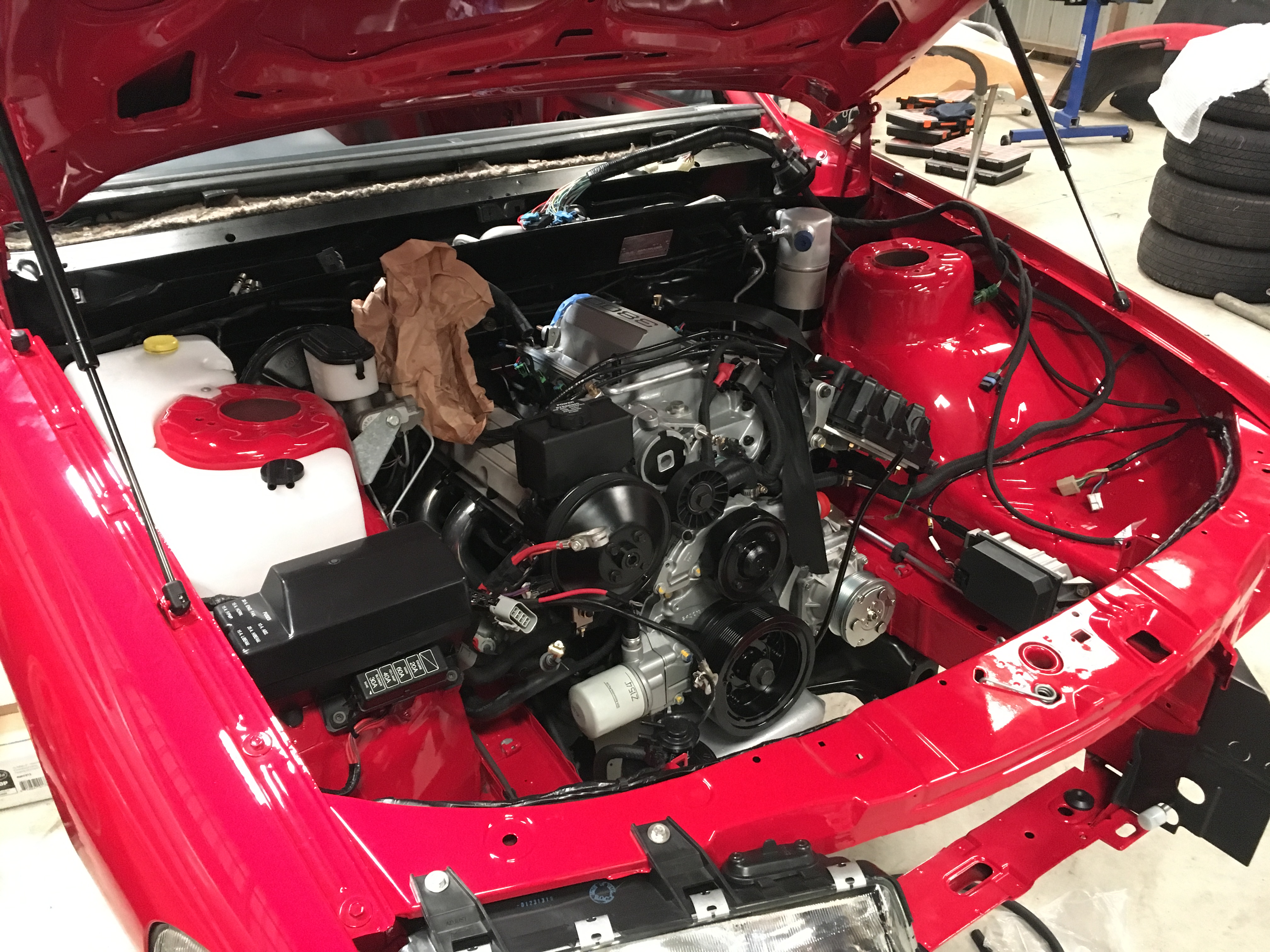

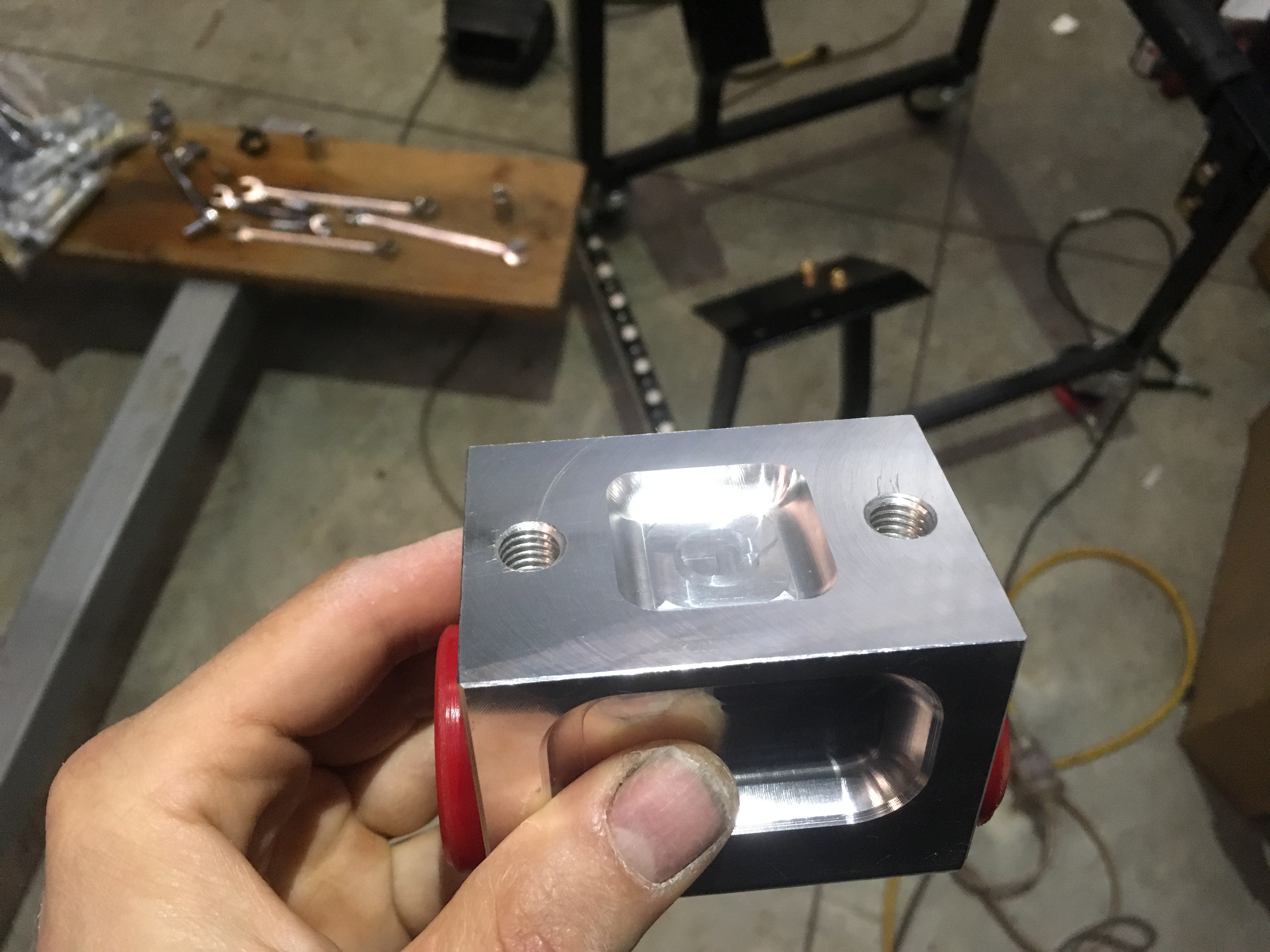

Dropped the lower section of the tuff mount and adjusted the height of the engine and measured the difference. I got 5mm on the front of the mount.
So I got it fly cut down 5mm and the threads for the studs extended by the same amount.

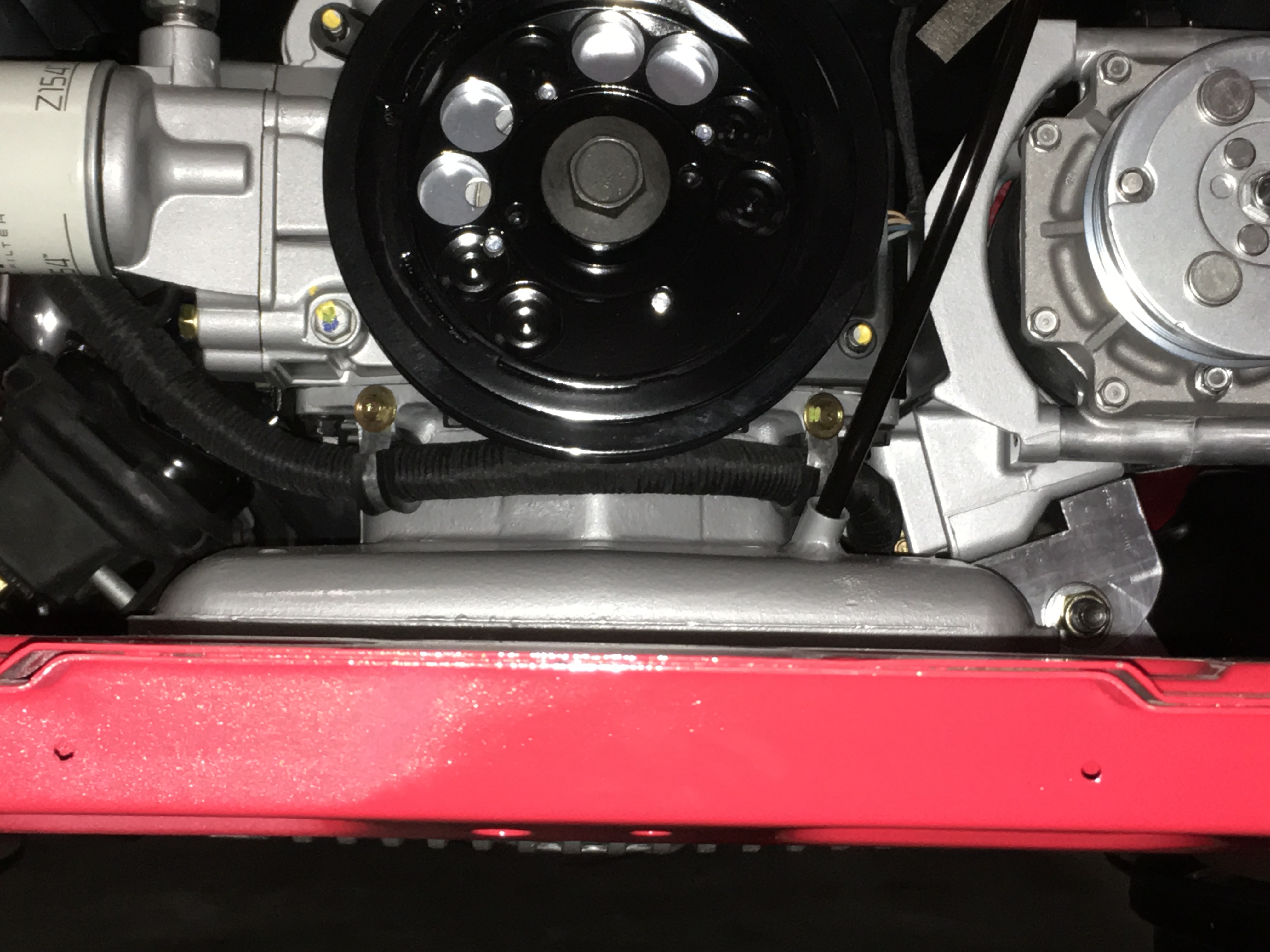

So with the mount machined shorter by 5mm it was way better! Still not 100%, should of went for 6 or 7mm as it would be dead lever if not little lower which would accommodate the OEM mount sagging over time. But it was close enough for an aftermarket go fast bit so I will call it done!
I have been working with the manufacture of the Tuff mount to let them know of these issues when using in the older chassis, header clearances and mixed mounts as some people do.
They are going to be correcting this for future mounts so that's good news.
You can just see its a tad high still but barely, it was a large amount, 5mm at the mount was like almost 10mm on the outer parts of the engine.
Exhaust fits now!

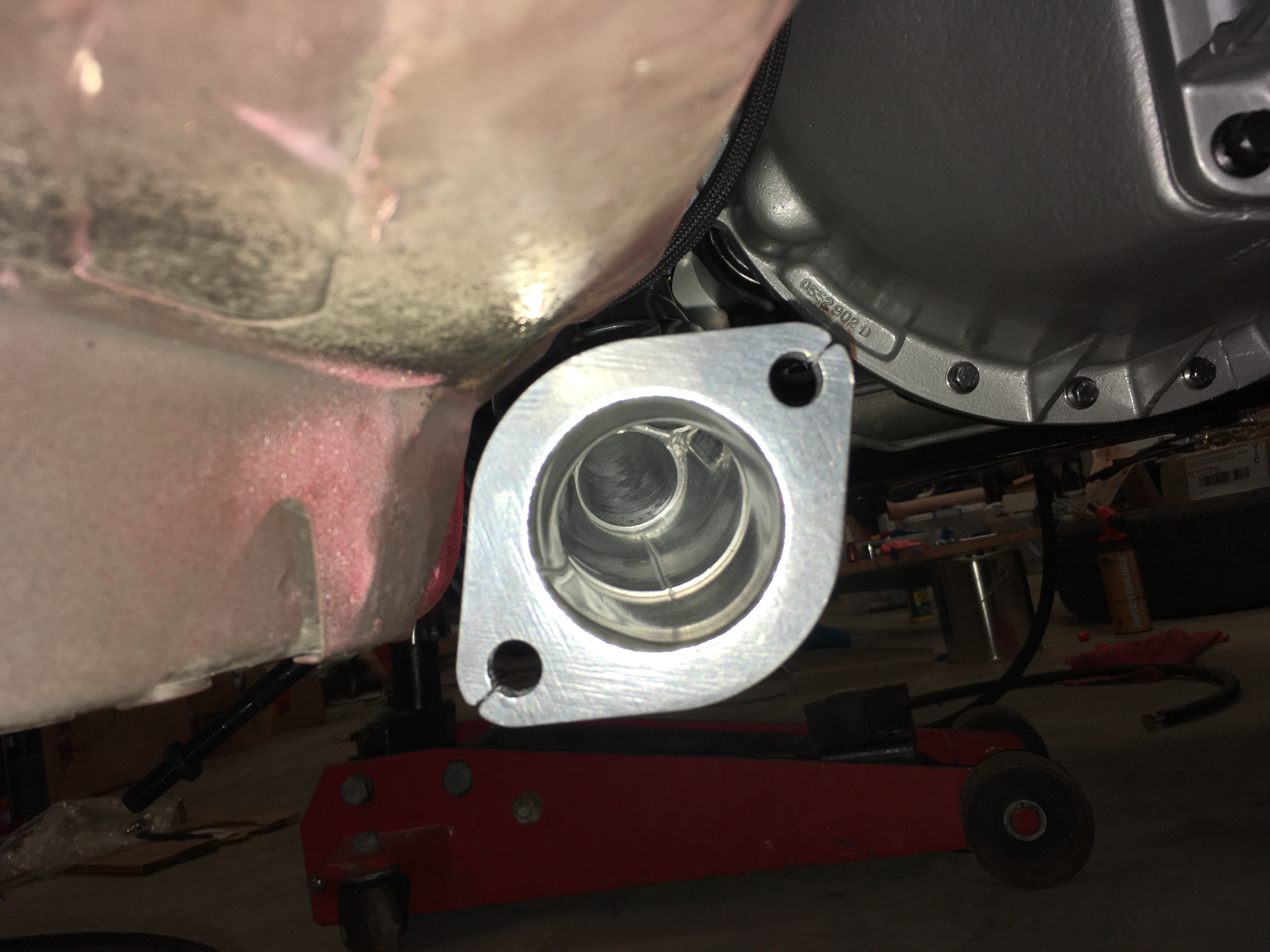

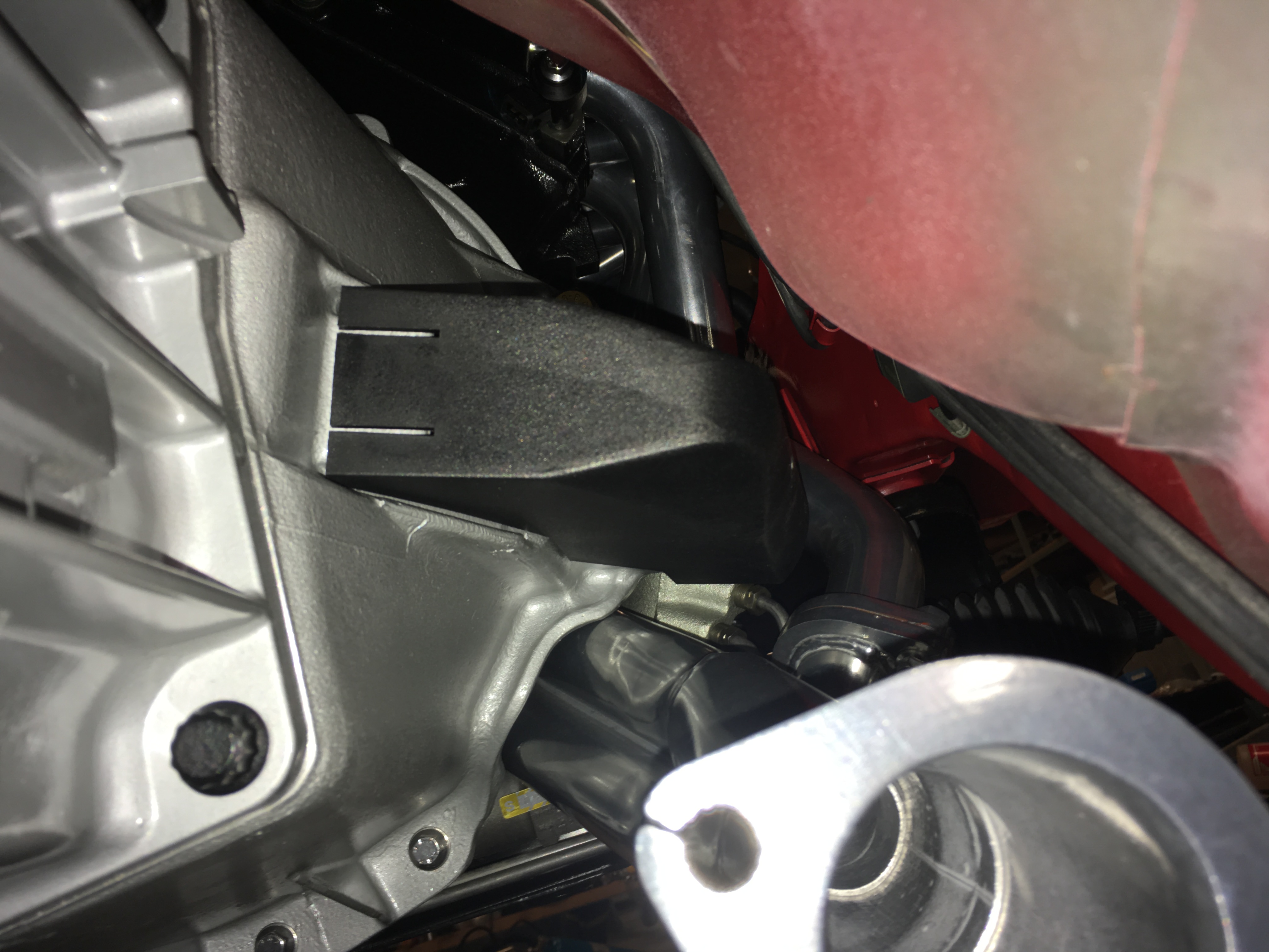

Speaking of the exhaust. These larger competition pacemakers actually fit way better than the smaller street version, ironically there is more room as they are routed better with the steering column piece of the header having it's flange moved to a better location and pitched at an angle instead of being level with and almost touching the clutch fork cover making it impossible to remove/install the cover without either removing the header or pulling the bell-housing and box back.
With these you can easily access the cover for service as seen in this pic. I adjusted the cable by hand in 3 min, on the VR it took me 30 min with pliers to turn the damn thing.
Another good thing is the cover wont get roasted as it's much further away, well the street version was like 1-2mm from touching. Here its like 15mm from he closest point.

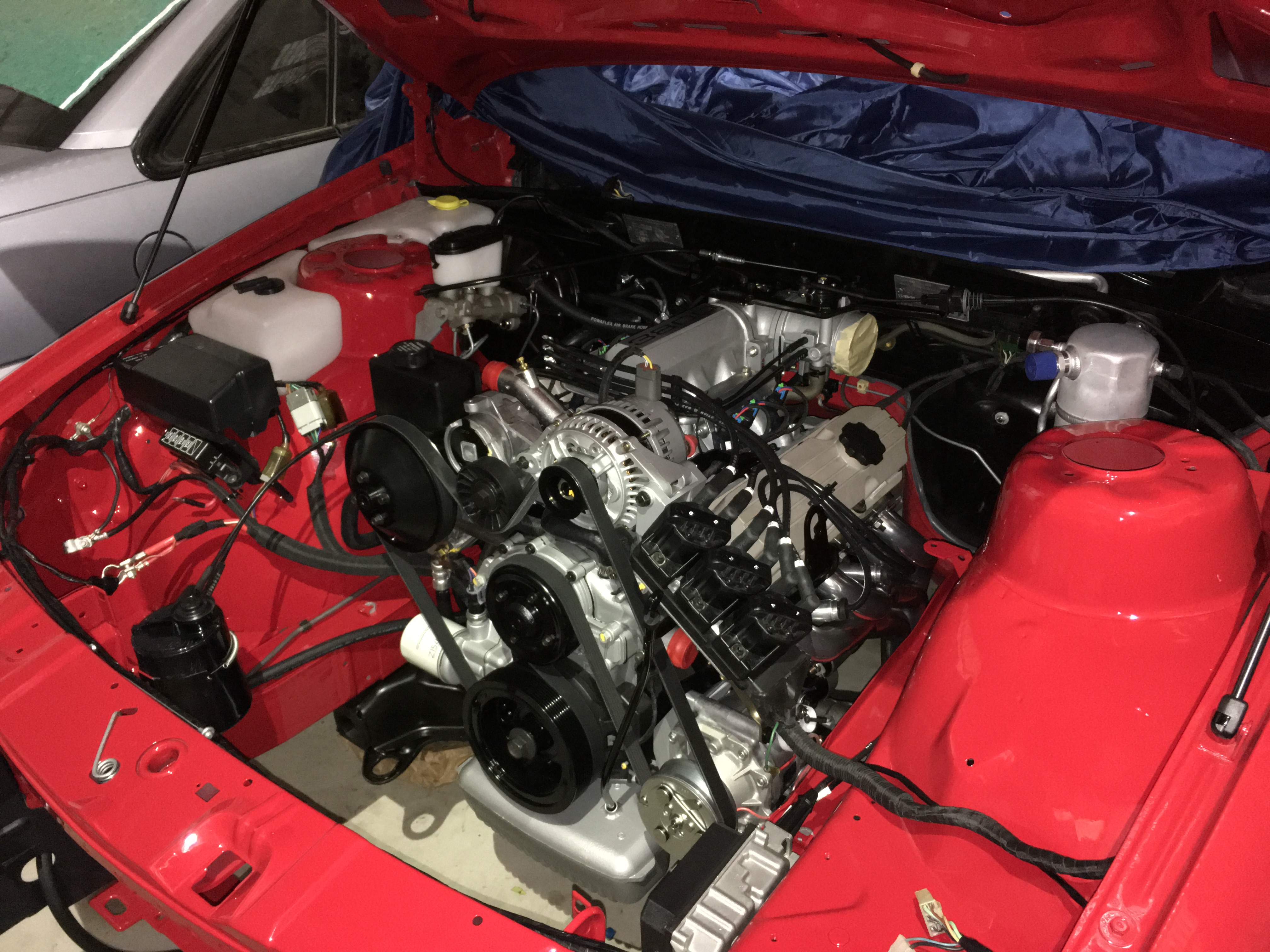

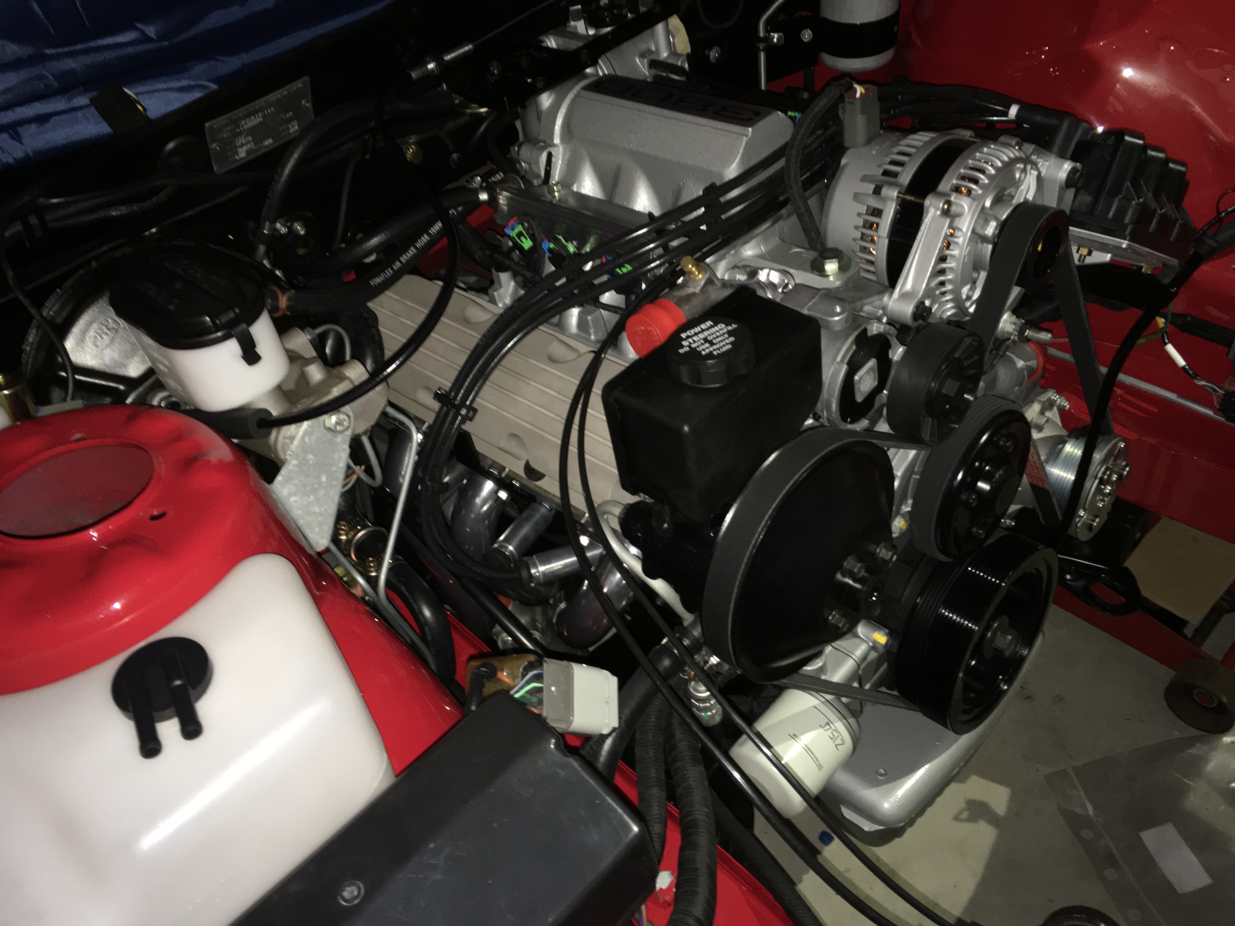

So last 3 days I got the throttle cable done, fuel lines, vac lines, wiring, MAP sensor, TB elbow, TB, brackets, clutch cable, alternator, belt etc etc...
I am running Gates barricade fuel line and Gates accessory belt if anyone is wondering. Sick of shit quality off the self lines and belts so I ordered these specifically.
So engine is basically done. Psyolent, get some towels before viewing these pics (Pr0n).
