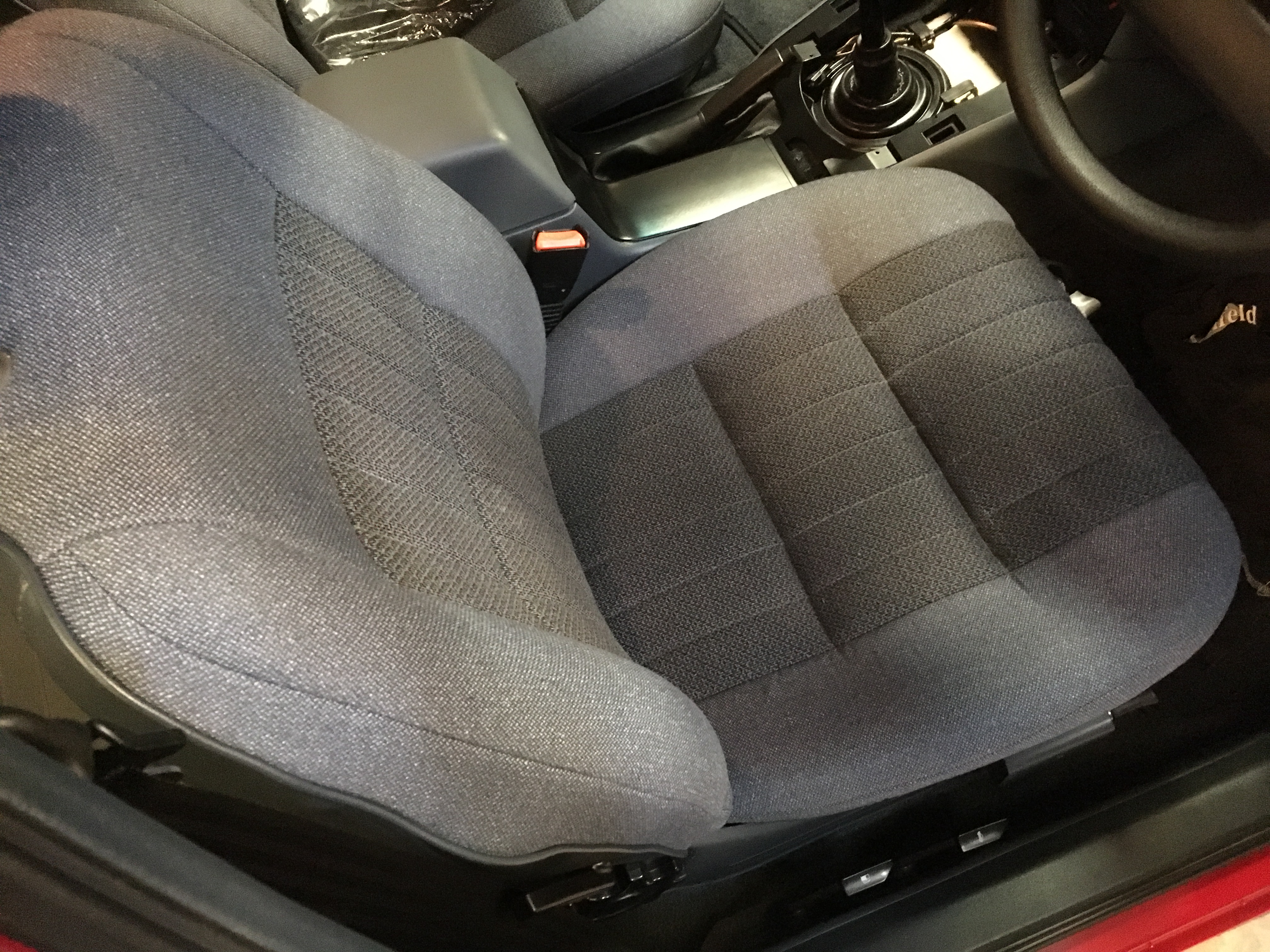

Posts: 6285
Postby vlad01 » Sun Mar 17, 2019 12:45 pm
Seat done!
Just need to get that rear arm rest fixed and I can install all of them.
One change I am going to make to the car it to get a thicker rear spring insulator to raise the rear by 10mm. Front has super low spring, rear has just lowered ones but with the aftermarket strut tops and gas shockers the front is raised a little so it ends up being slightly higher than the rear overall. Super lows weren't enough to compensate for that and ironically looks more like a standard height lol
Superpro make raising insulators of standard, 6mm and 12mm. The biggest at 12mm looks right when I jacked the rear up by that much. It's level with a full tank and should be ever so higher at the rear when low on fuel. factory VPs sit slightly lower up front.
Going to do this once I need to run in the handbrake and readjust the shoes, they have loosened up a lot already and only way is to remove the calipers and disks to adjust since no aftermarket disk has the adjusting holes, good excuse to change the insulators out for the thicker ones while I do that.

Postby psyolent » Sun Mar 17, 2019 1:49 pm
That seat looks pretty mint Vlad. Notice you’re missing electric windows though ;)
Even if the 12mm is too tall you could probably shave a wee bit off it to make it sit right.
Forgive me but isn’t the adjustment for the shoes for the parking brake in the rear thru the backing plate dude?
