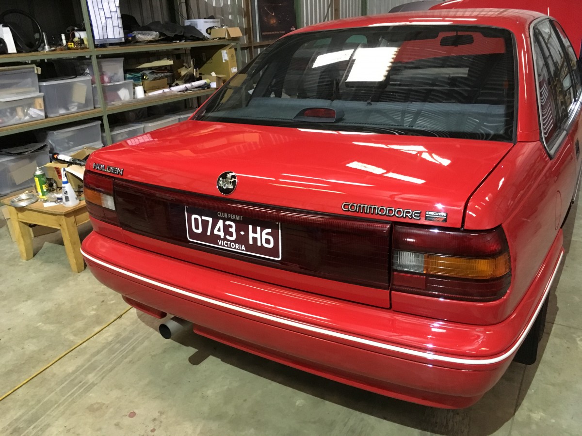

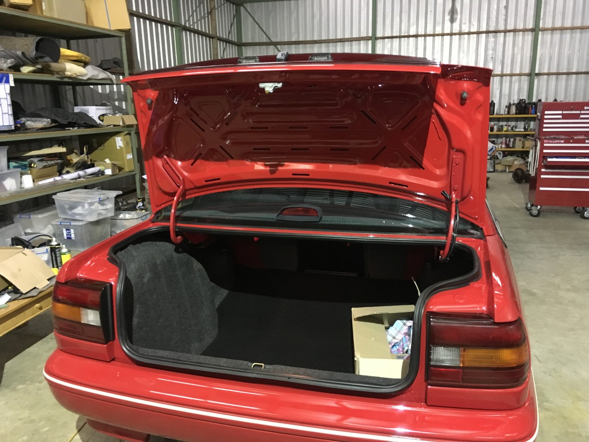

Been a while since I did anything on the car. I finally got the new boot lid back home and fitted it.

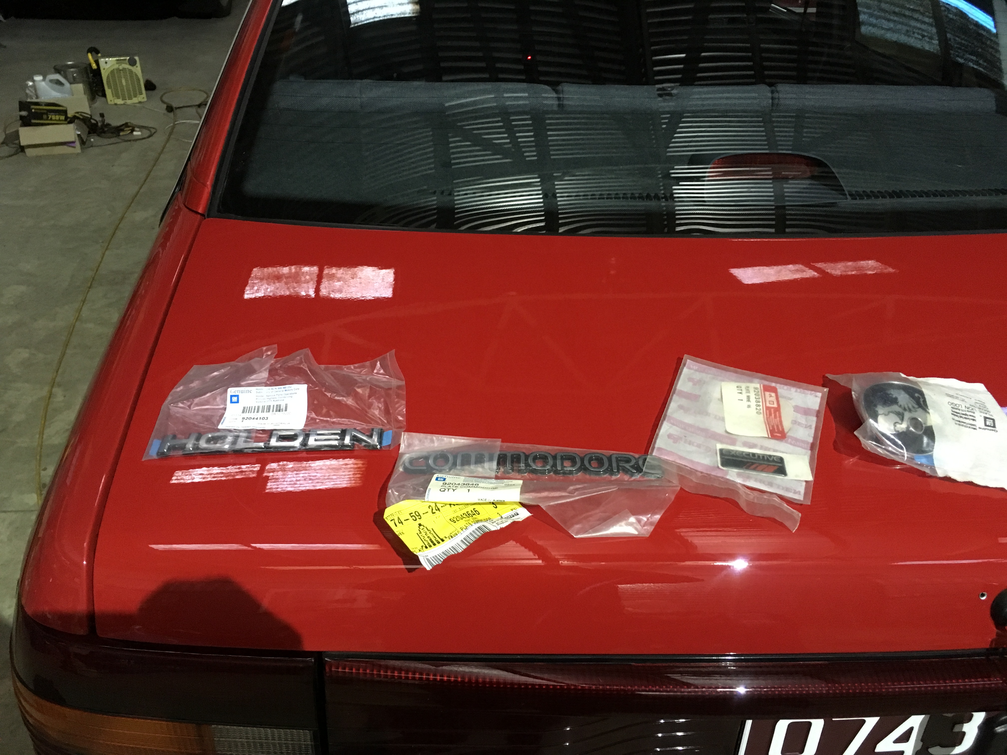

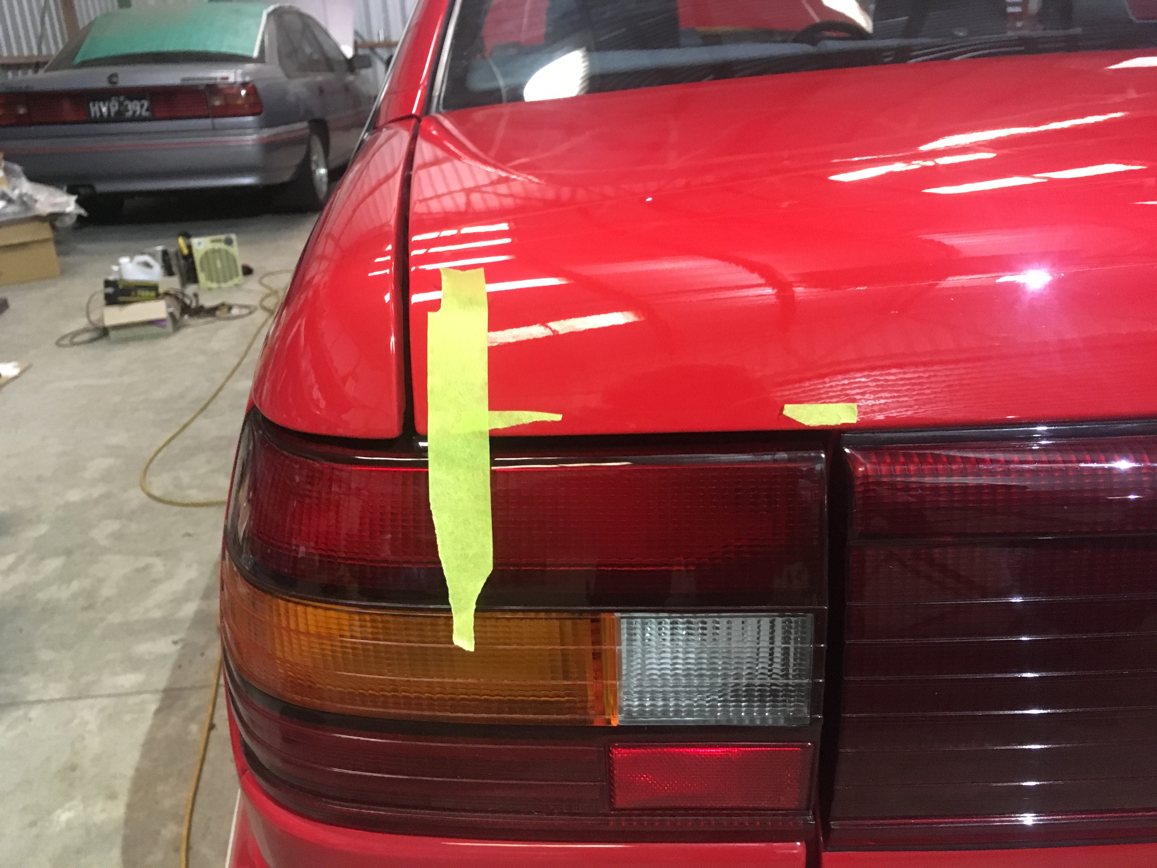

Today's task is to fit all these badges to the boot. Hard to imagine there is a cheap cars worth of value in these badges alone, scary seeing what they sell for now.

looks awesome mate, whats left to do now?
- Posts: 8125
Just to finish off the tune and get the AC gassed. Won't be doing anything until at least spring. So wet and muddy atm I nearly got a few of our cars bogged in front of the shed, wheels spinning on the spot idling kind of bogged
