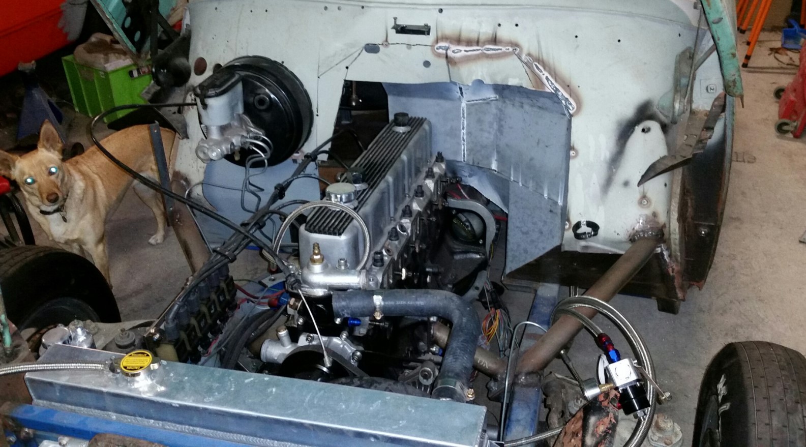

So i've gotten to the point where i needed to take the motor out for a few reasons, rear main seal leak, finish steering mounts, finish firewall from engine bay side and a few other things, so i started stripping the bolt ons to get this thing out.

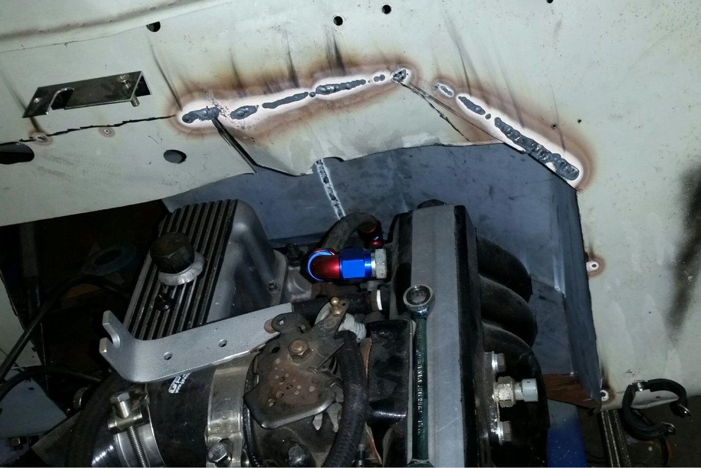

Firstly this is the clearance on the manifold to firewall, just enough to get it off the studs before it hits the firewall! - the cream panel will be cut off where the weld is along the top of the firewall.

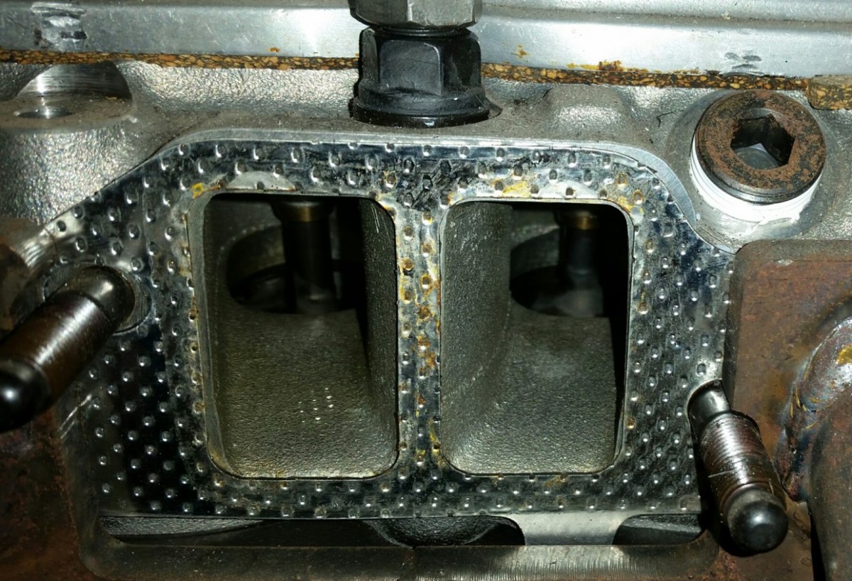

This is what the inlet looks like after a few hours running
almost there, lots to remove but nice and easy to work on without guards!
