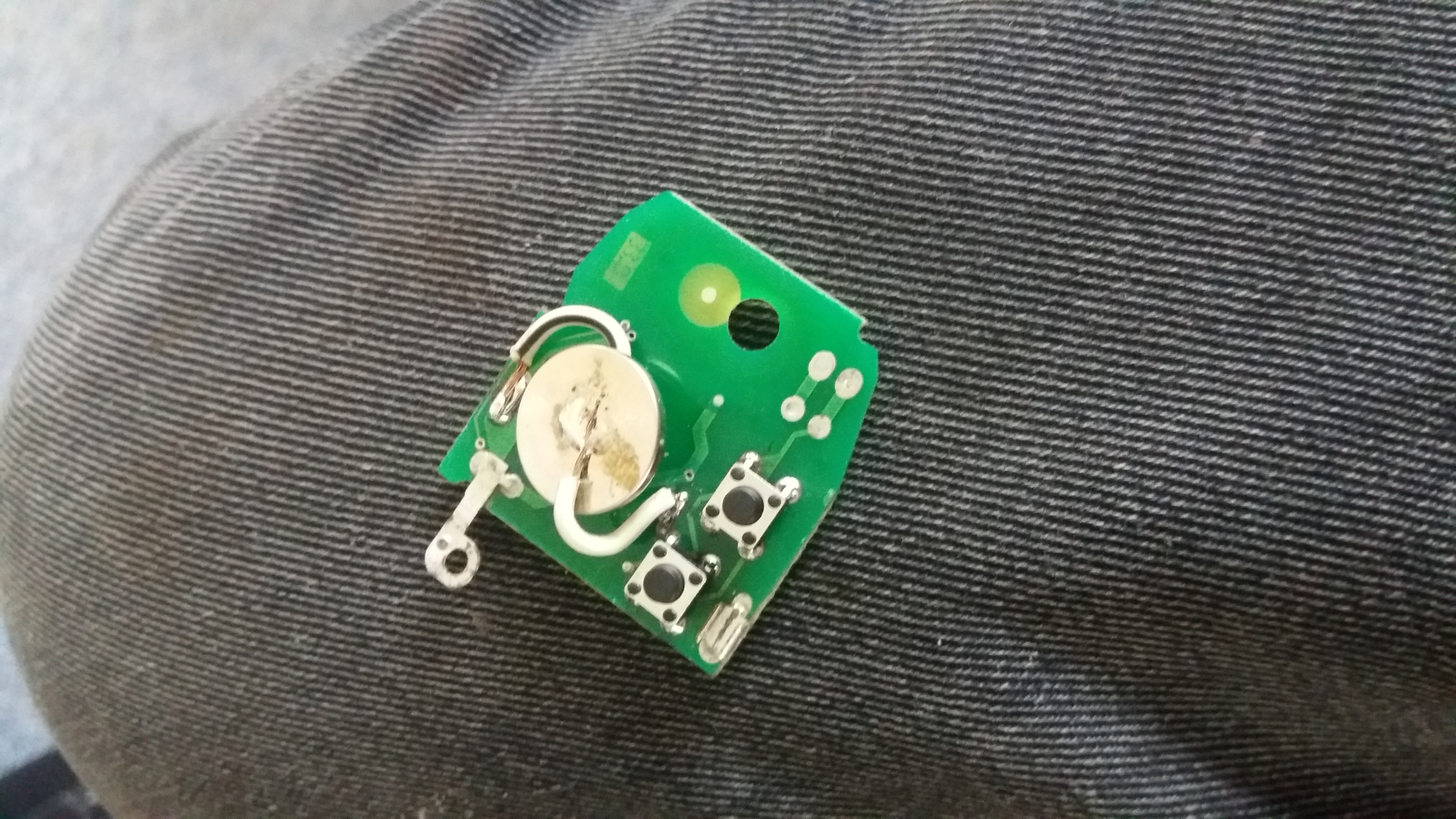

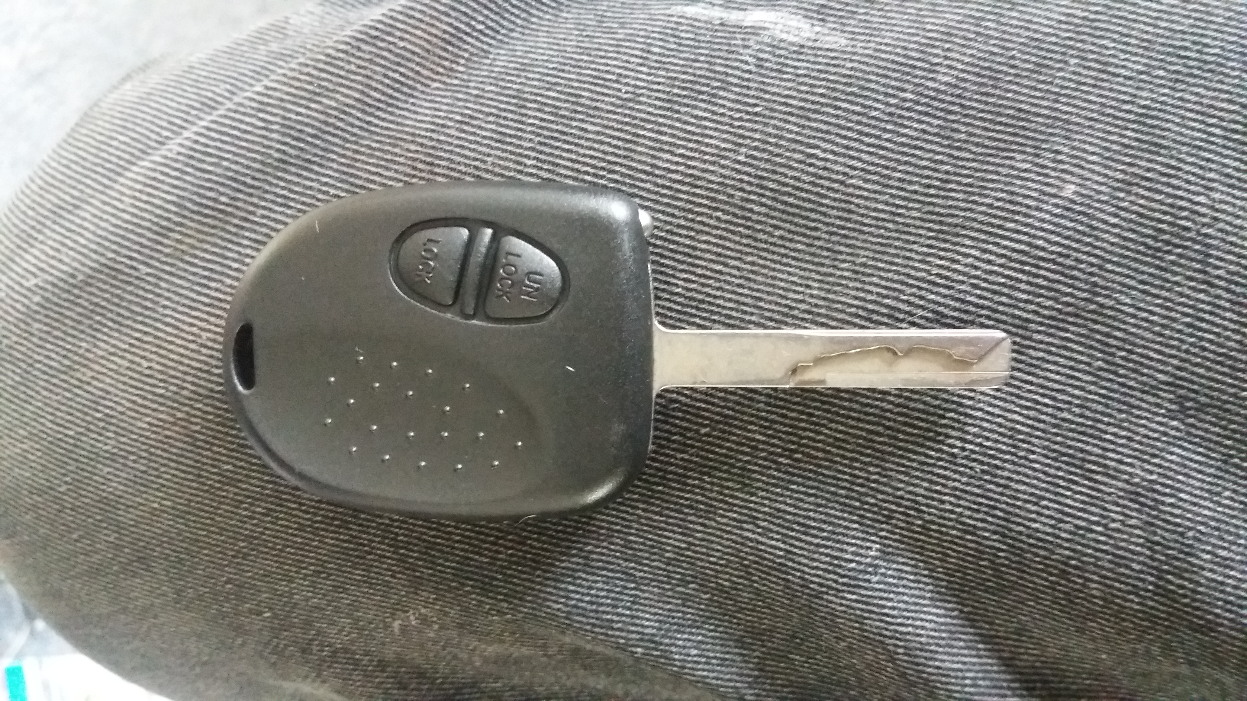

Drowned in bourbon hehehe maybe you preserved it!
- Posts: 5638
Re: DELCOS NEW RIDE
Haha maybe she's a mint key now 2 new tactile buttons and a 20 dollar case weird have rubber buttons I've never had rubber buttons lol
Re: DELCOS NEW RIDE
like new!

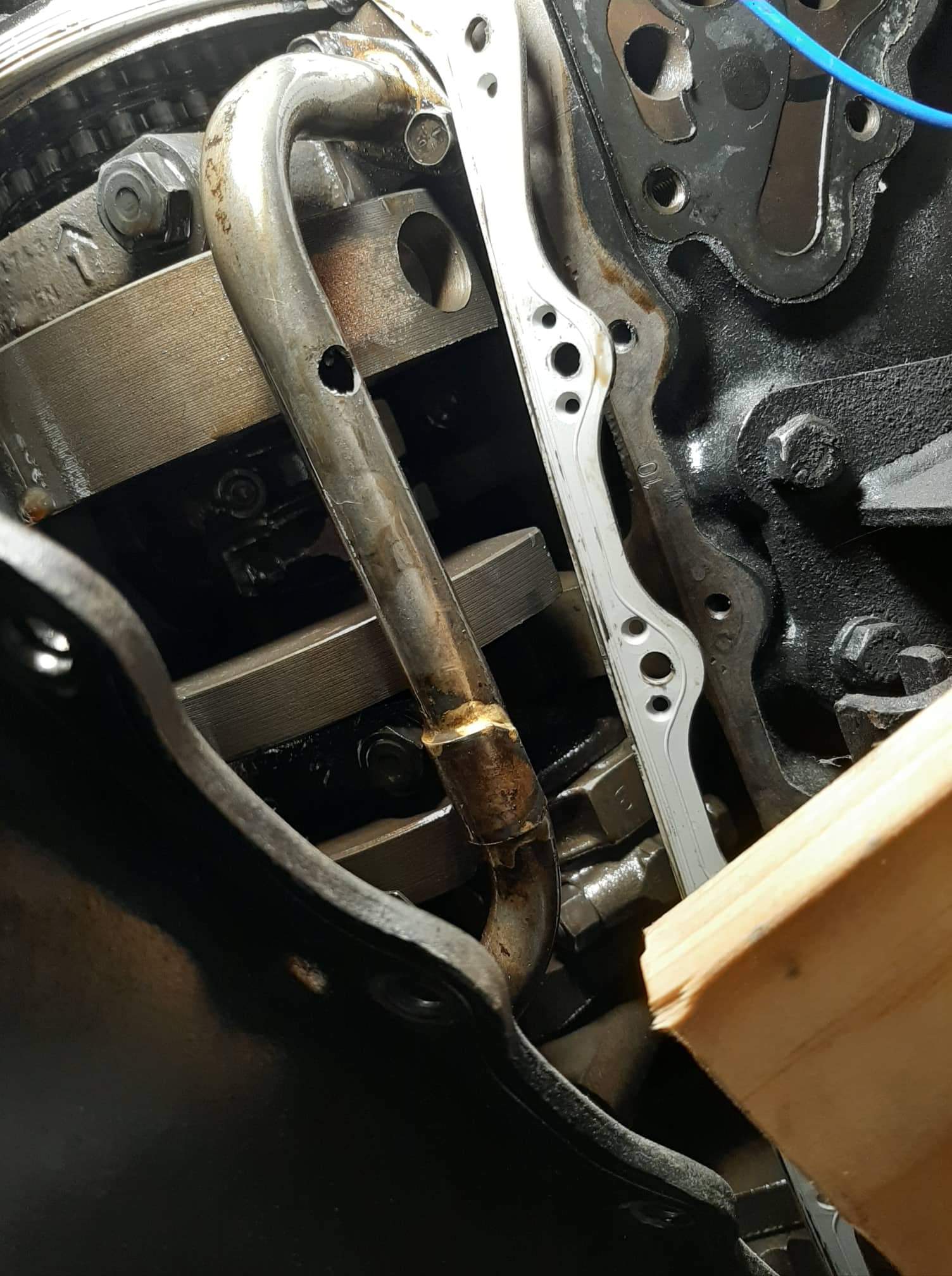

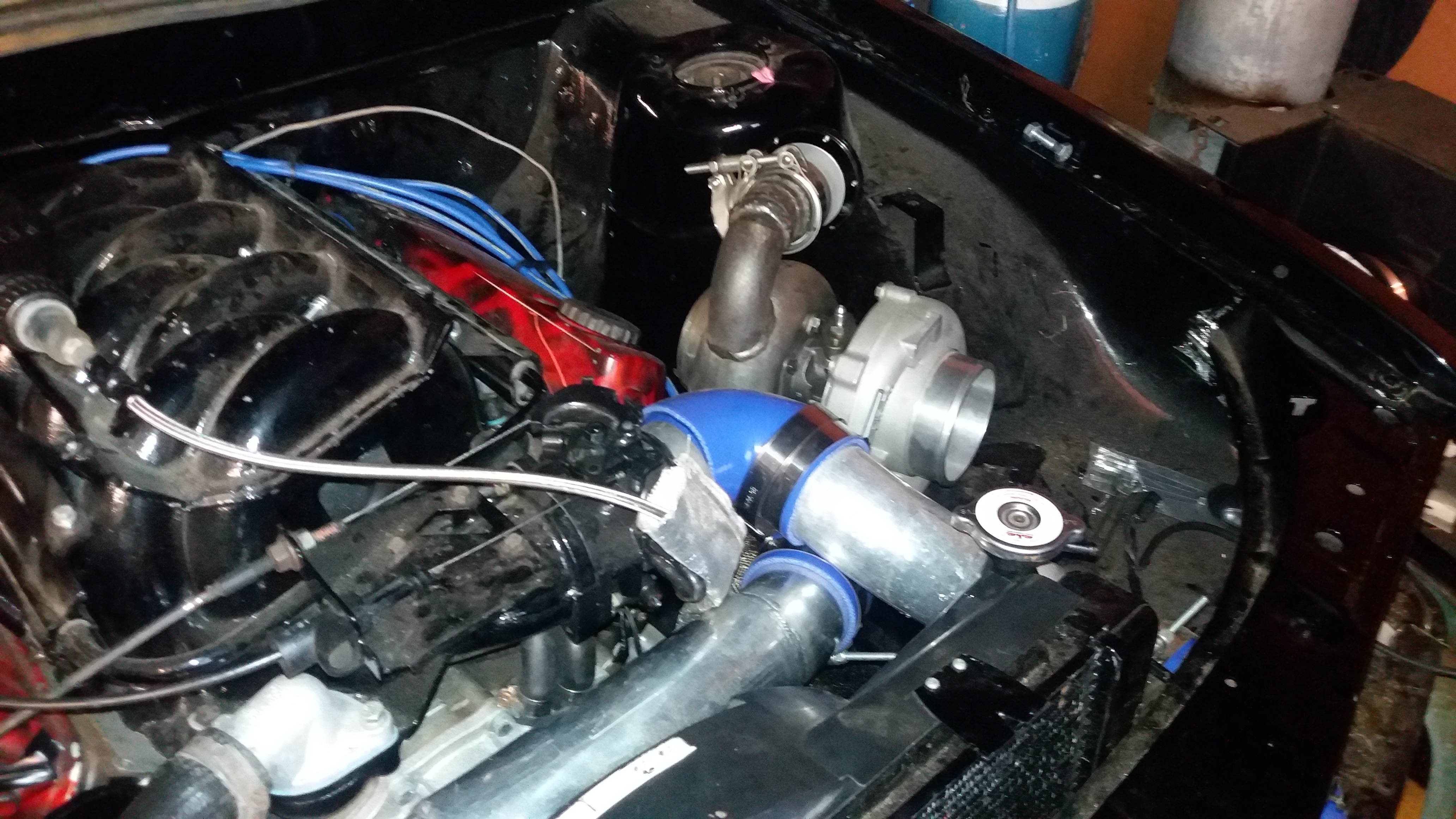

304 turbo oil pump wouldn't prime found the issue some idiot drilled straight into the pickup tube drilling the sump for the oil drain fml some people just shouldn't touch cars hahaha

Re: DELCOS NEW RIDE

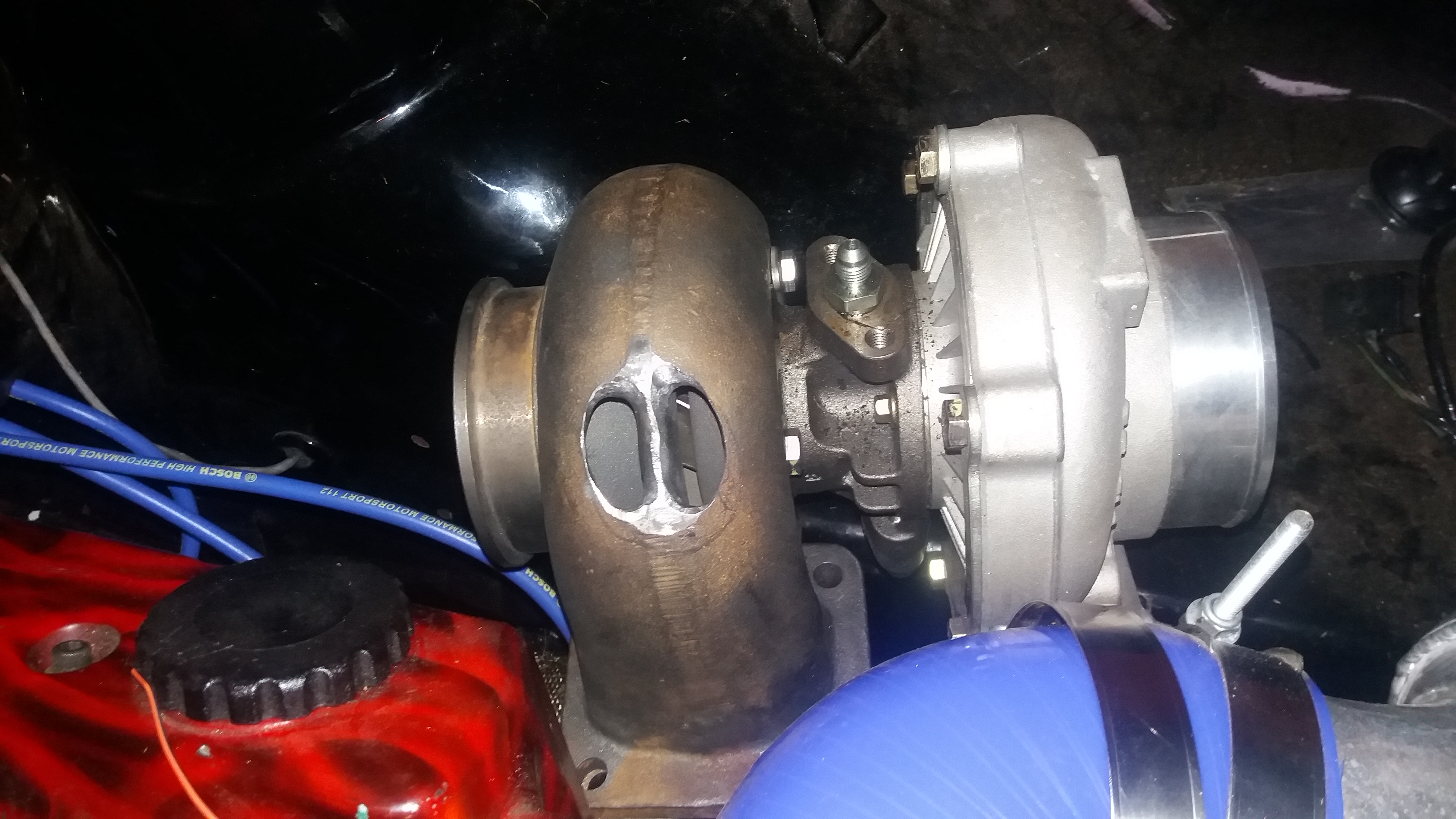

What is the rest of the turbo kit like?
- Posts: 5638
Re: DELCOS NEW RIDE
My mate made the manifolds so they are good I had to cut the wastegate off and move it cause where the guy told him to put it meant no room for a turbo drain and no way to plumb it back into the exhaust .I got it with just an engine in the hole and manifolds and had to finish it after the guy doing it had no idea lol and had to rewire the link ecu to fix all the fuckups lol fixed the pickup and fired it up today instant oil pressure and then fitted the turbo and blew the oil filter was a small z160 have a z30 on the way it's heaps bigger and will flow substantially more oil through the media whoever built the engine must of blocked the bypass valve

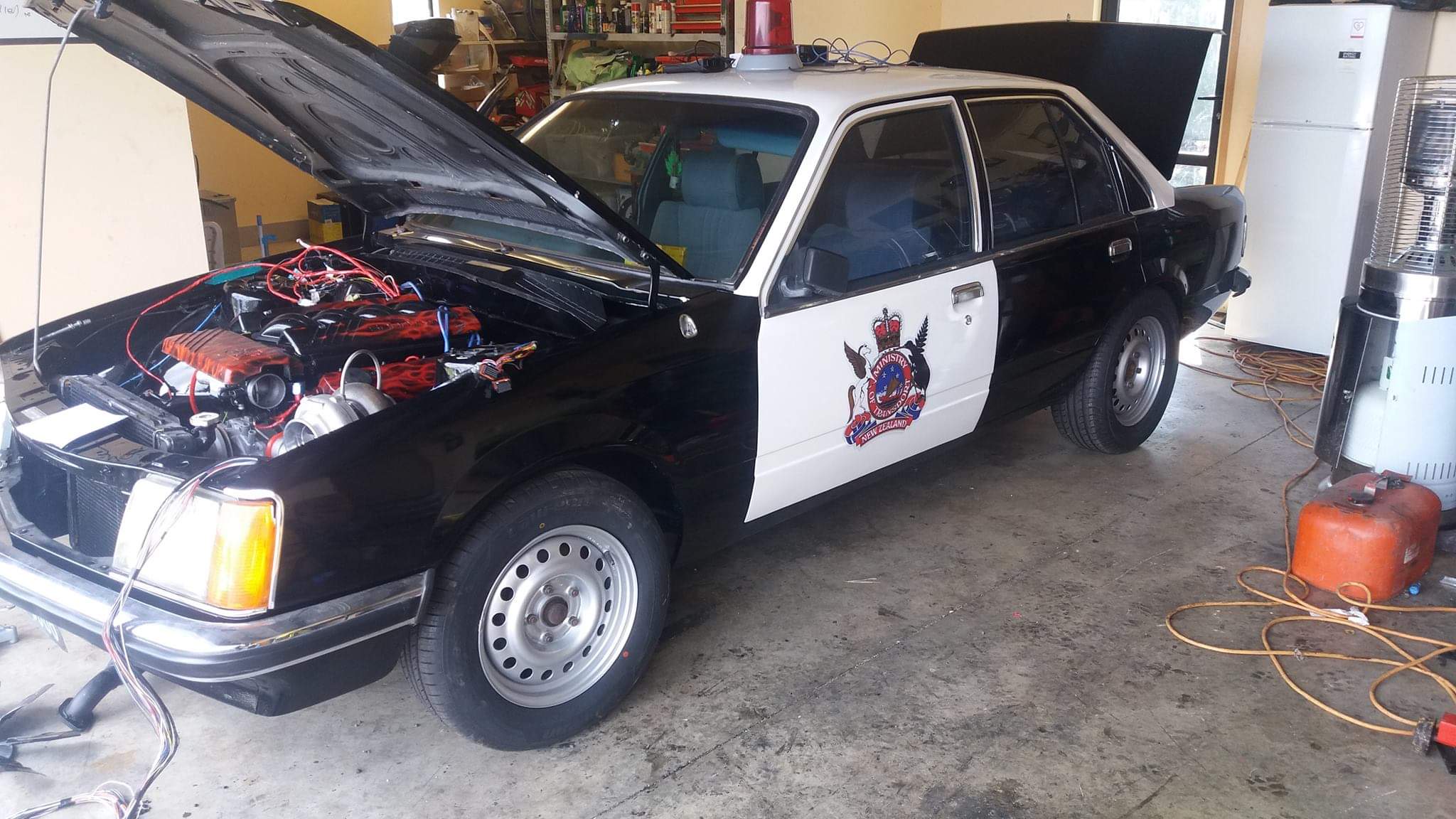

i think its going to need some better tyres than that!!
- Posts: 5638
Re: DELCOS NEW RIDE
Haha yeah
