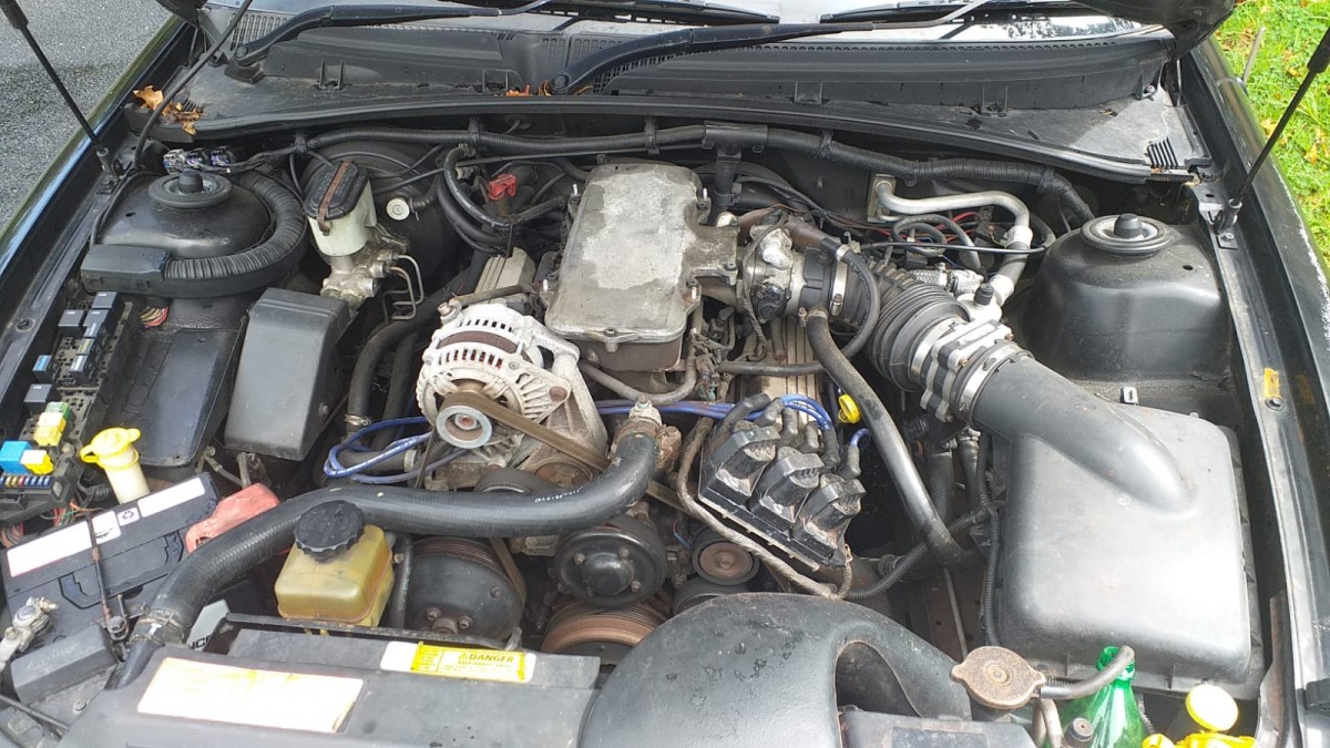

Well I got it home... Good she's rough, a true Sth Auckland car....
As I expected, stuff radiator cap that doesn't hold pressure. Thermostat was stuck partially open but not enough to stand a chance of keeping it cool so it came out. Topped it up and started her up..... bubble bubble bubble. Yup, probably a head gasket or worse?
Bleed it as best we could and headed home (it was pissing down with rain). Decided to stay off the motorway and avoid the tunnel as that would be the worst place to break down at get the attention of the boys in blue.
She stayed mostly cool but lack of airflow in traffic and she eventually started to climb and not stop. Factory bloody tune not turning on the thermofan till 105°C. Topped her up and headed off again. Once past the tunnel we jumped on the motorway and temps came down and stayed steady until we hit the end of the tail on the Sth Western motorway, got off and went the rest of the way on the back streets. We stopped and topped her off one more time but it never overheated again.
Bought it off a reasonably young girl with a 3month old baby. Apparently it was her uncles car and didn't know much about it.
Trans was a bitt clunky but then the lack of trans fluid will do that. Power steering about as low as it can go without not working, oil.... yes. Brake fluid? it stops.

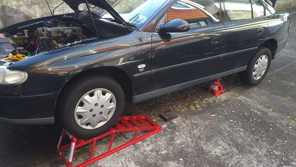

So she got her first bath when I got home, firgured I may as well hit it as it's still hot!
It's surprisingly clean under here

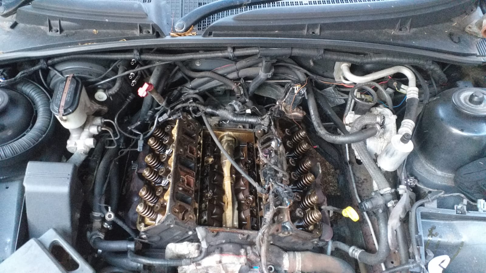

Surgery has begun.
Good signs, found this first off. Don't think it would have run well on petrol.
Got a back saver device to make this process easier,
About 2.5 hours later we ended up here,
Interestingly it's fairly clean inside, no major gunk buildup anywhere. Either this was well serviced for a good portion of it's life or it's been thoroughly steam cleaned of late. Push rods are clean, just high mileage wear on the end I've seen before, no oil staining, just a little rust from moisture at the rocker ends.
Made a start on getting the exhaust manifolds off but it started to get dark and the mozzies were eating me alive to decided to call it a day.
Only one small woopsie, forgot to disconnect the ECT sensor and smashed it. Woops.
