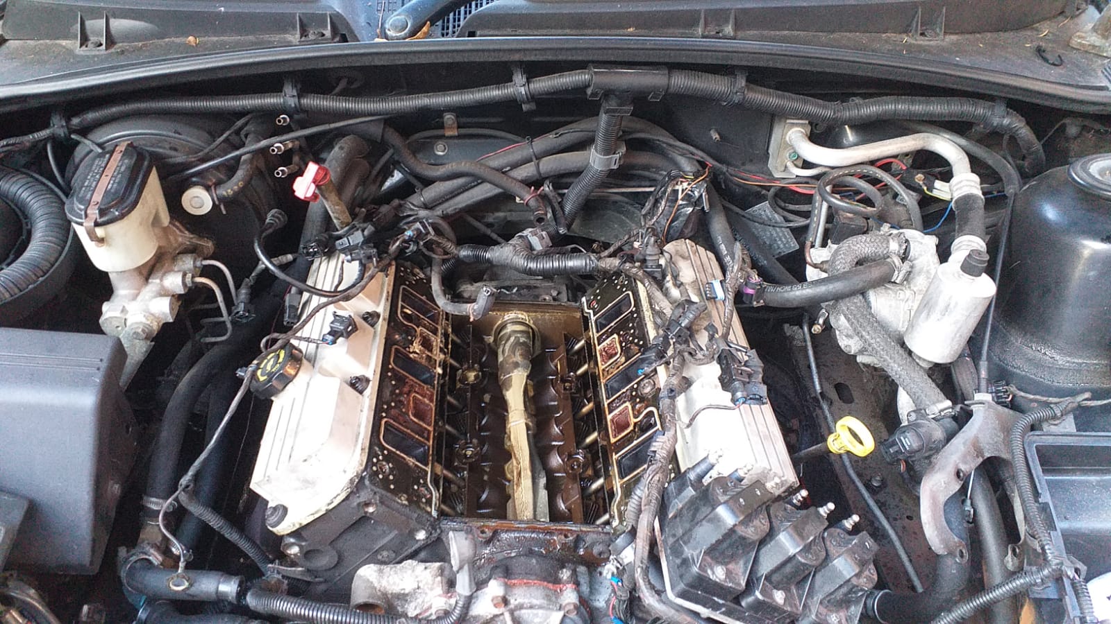

What did the inlet gaskets look like?
Posts: 3680
Re: Project Rescue
Not as bad as I thought they'd be. Definitely stuffed though.

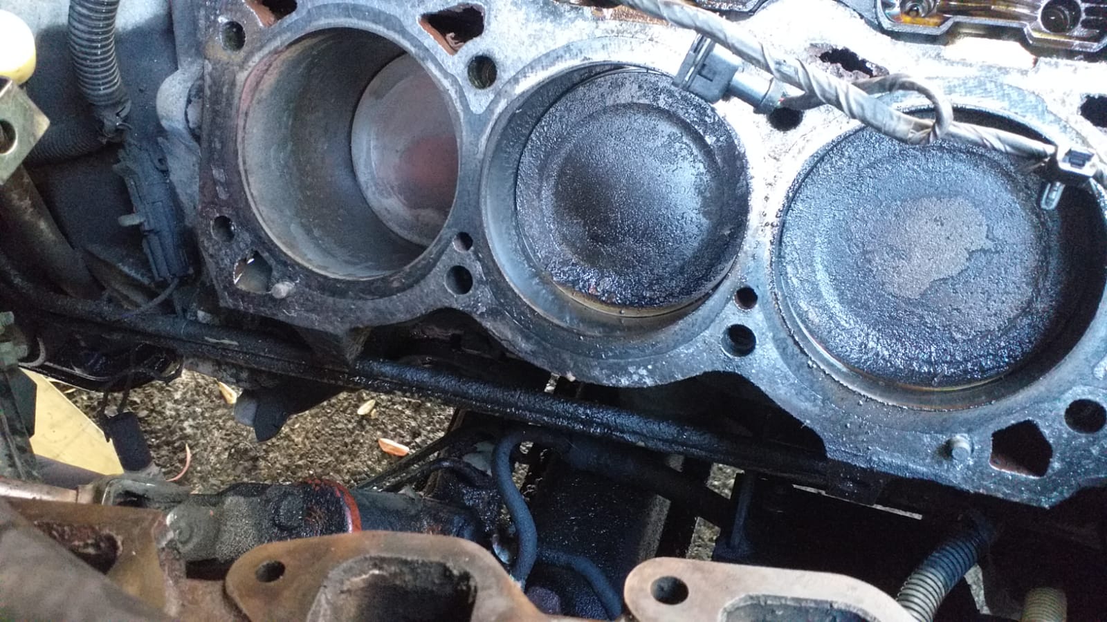

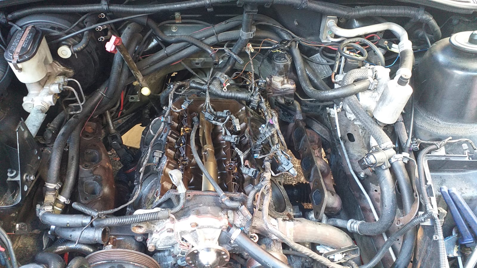

So finally got the heads off, those exhaust manifold gasket bolts area PITA with those securing straps on the 2 outer bolts on head manifold. Basically had to cut each one/destroy em to get the bolts out. Look like all original studs, no broken ones either. A good start. Had another look at the intake manifold bolt holes, orange gasket goo on some, did someone try and fasten em down again at some stage?
Bores look ok, a bit of carbon buildup around the top of the bore but no lip, bores look good, can still see a bit of cross hatch here and there
Last cylinder on the drivers side was full of water, a bit of surface rust but nothing drastic and should clean up ok. looks like a bit of water damage in the bore but nothing substantial, can't feel anything with your finger nail.

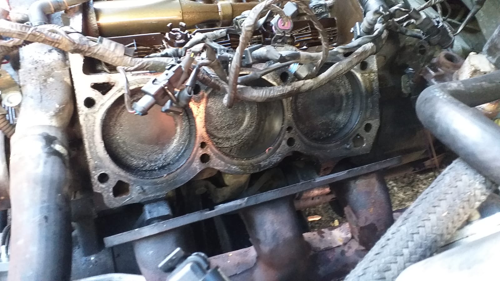

Passenger side looks fine.

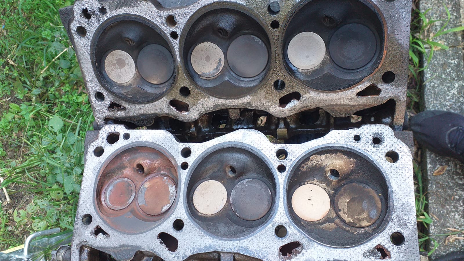

Heads look ok too. Nothing obvious other than a good coating of rust in the bad bore and some carbon buildup.

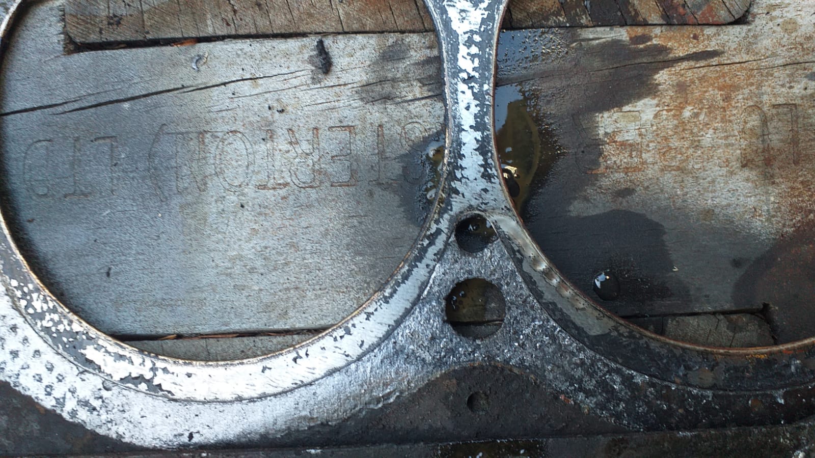

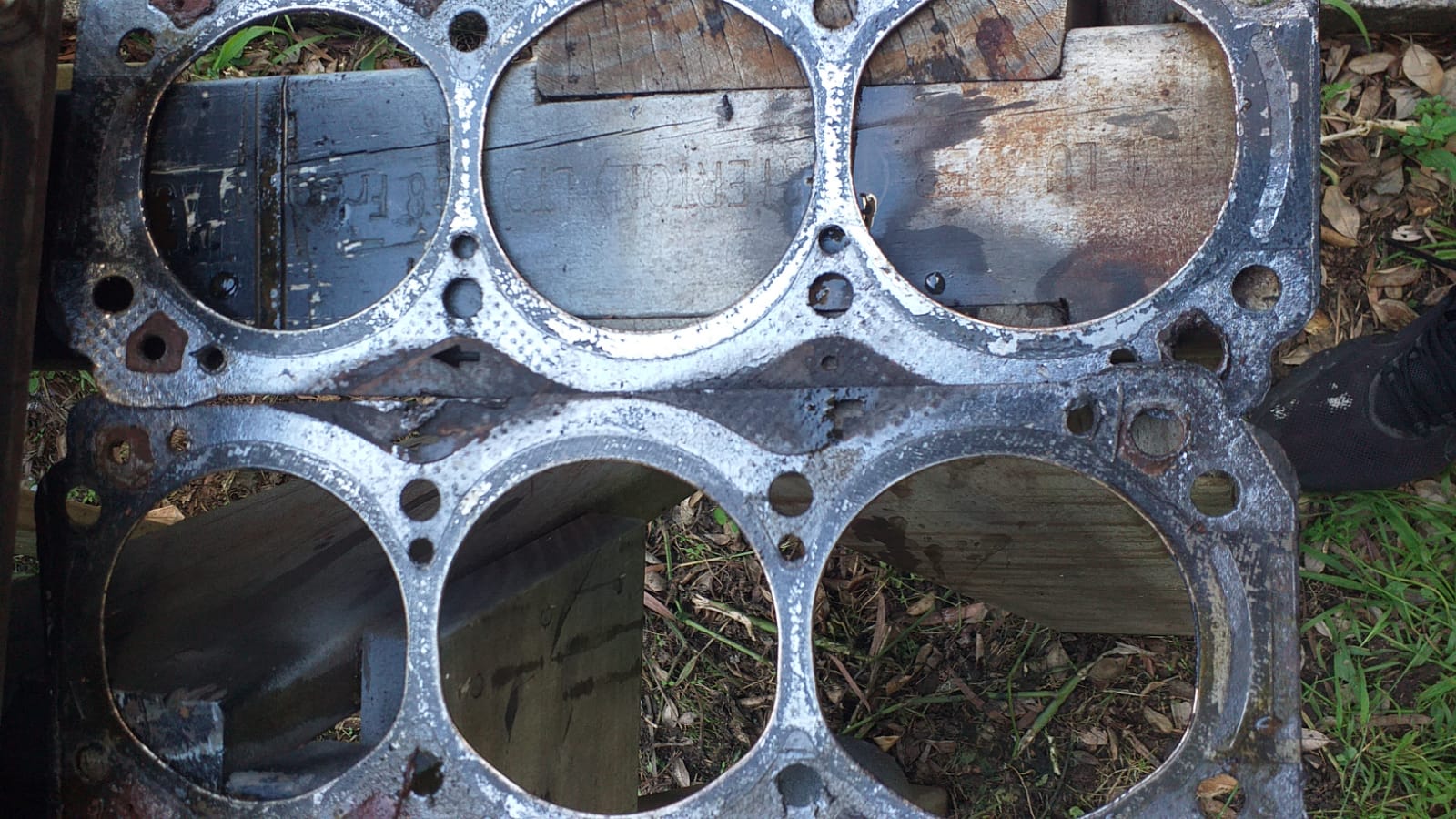

Time to inspect the head gaskets....
Posts: 3680
Re: Project Rescue
And I think we have a winner!
So I think the plan at this stage is to head into work this weekend, strip and clean the heads in the wash tank and inspect and then re-assemble. Might give the valves a quick lap and some new valve stem seals. Then start re-assembly. Still need to get some new head bolts, thinking I might go with cap screws rather than another OEM set of TTY head bolts and keep cleaning and re-assembling as I go.
The bad cylinder really does need a clean up of some sort. If the engine lives till the end of the year I think I'll pull it out, a quick hone, file the rings and she's ready for some boost.
