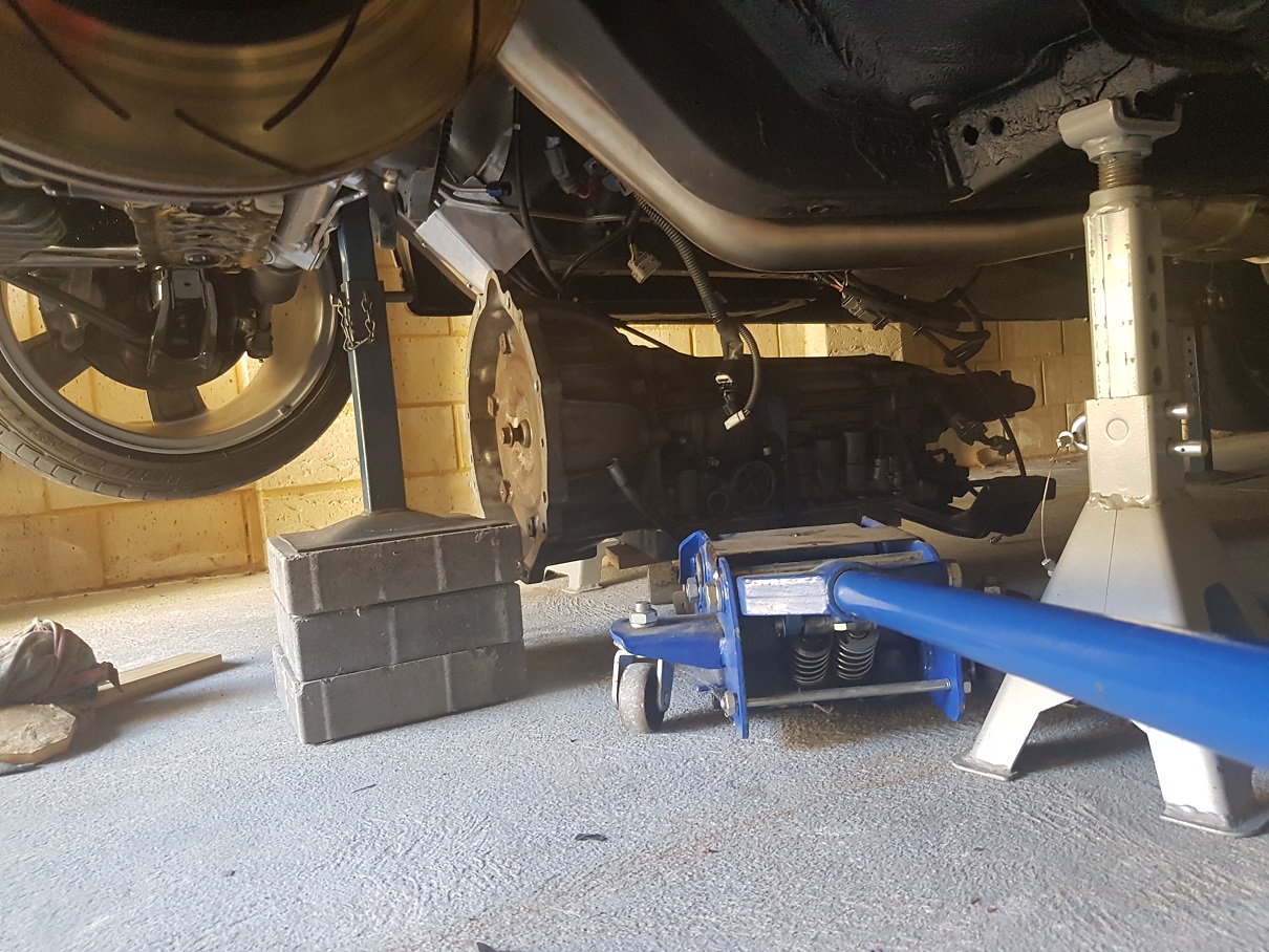

Started getting some weird noises from the bell housing area and suspected the torque converter, so had the fun job of doing this using socket extensions from pretty much the diff over the top of the gearbox ...

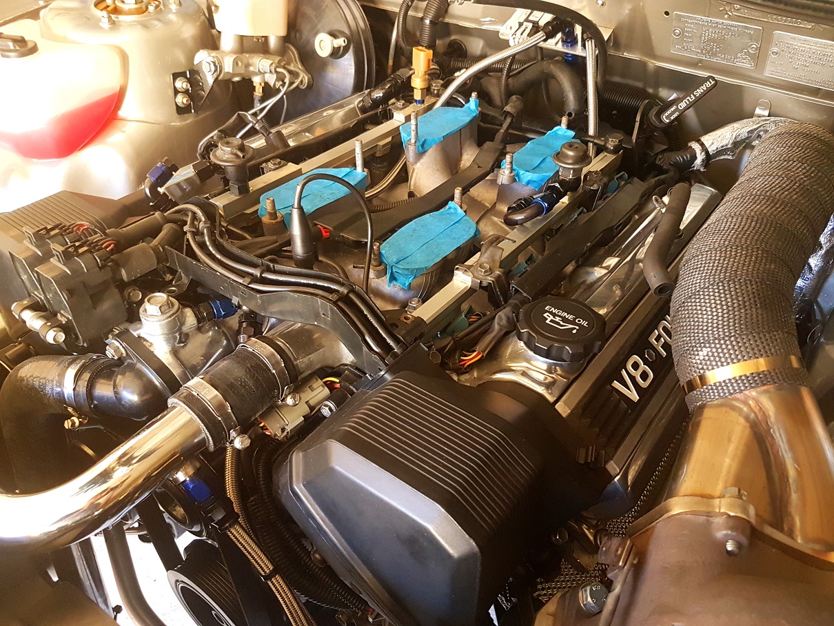

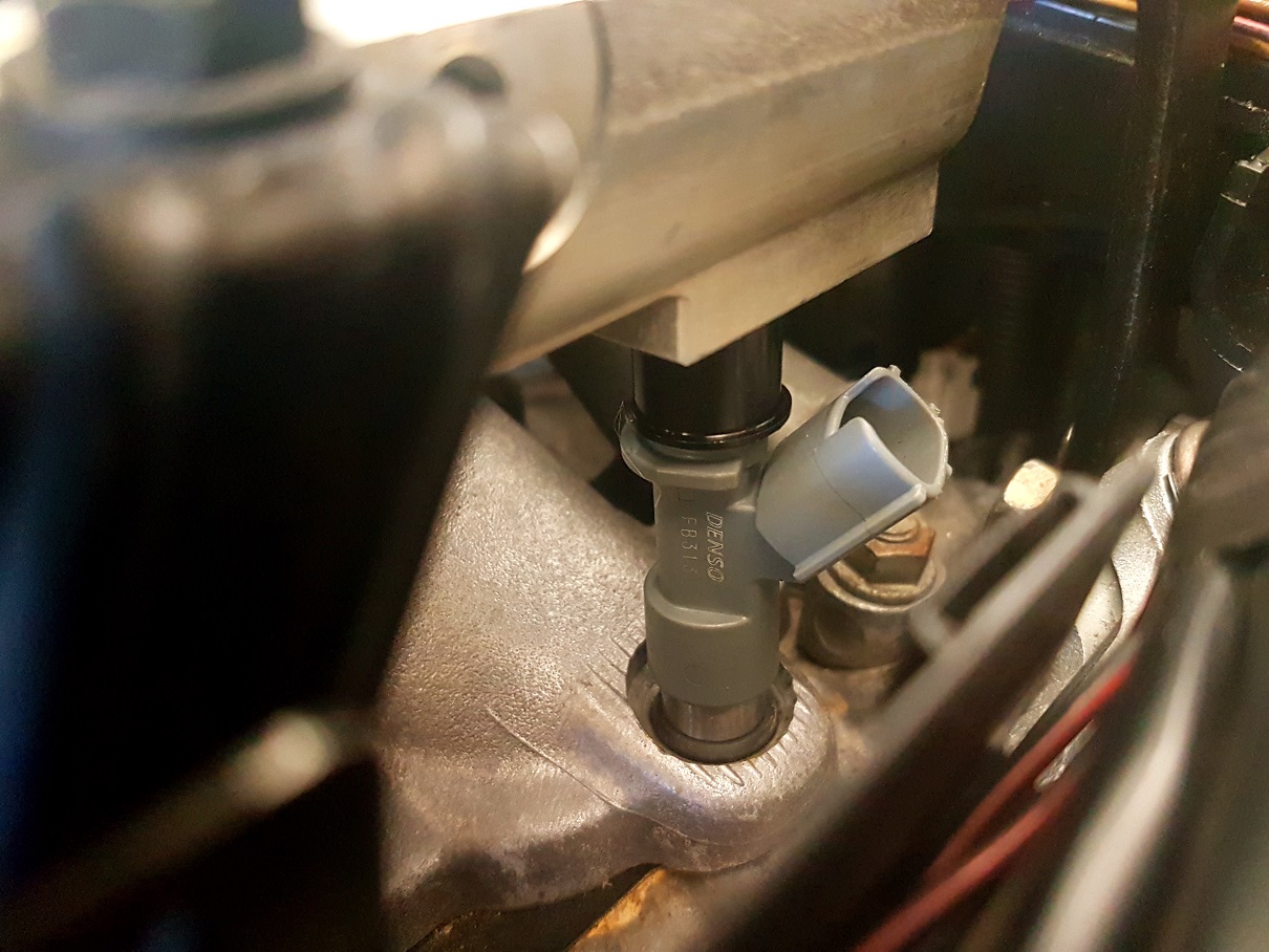

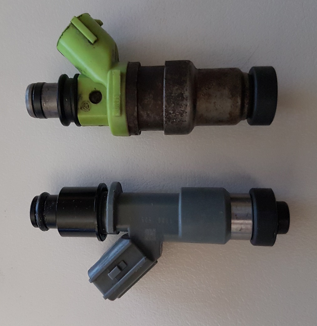

But got some bigger injectors from the1 and installed them. They are the 12 hole UC style injector, 3/4 length. Just needed 14mm to 11mm adapters and some 2mm shims in the factory mounting, then swap the loom connectors over to the later style these use. They should be around 800cc at 3bar.
Compared to the factory 1UZ style (this crusty unit is a 315cc from a 7MGE)... Pulled things to bits... And new HP adders installed...
Now to go and break the gearbox
Swapped to a spare converter, put it all back together and the noise is still there so looks like maybe the pump in the gbox? Not sure, so unless it gets really bad really quickly gonna drive until something gets chomped up to know what it was

Re: Toyota Powered VL Calais
Good times! Manual trans next time?
Gearboxes are right up there on the shit jobs, even with the right gear ! Can't complain though, always get a laugh at mates with 4wd's, they have twice the experience lol
yeah. remove engine. install gearbox to engine. install it all back in original hole.always get a laugh at mates with 4wd's, they have twice the experience lol
VL400 - does the torque convertor have a spigot bush in the back of the crank for it to seat correctly?
Good to see they fit up, keen to see how they go in your setup
No bush, just machined crank that the converter fits in to.psyolent wrote:VL400 - does the torque convertor have a spigot bush in the back of the crank for it to seat correctly?
They fit really well, just needed the manifold side o-ring retainer removed so the factory 1UZ large o-ring could fit.The1 wrote:Good to see they fit up, keen to see how they go in your setup
For a first start with just the cranking PW tables, kinjflow and opening values setup idle quality was very nice with 1ms fuel pulse for a AFR that was only about 0.3 richer than target. Transient fueling needs work, AE drowns it! They sound different to the stock injectors too, more of a solid thump than light ticking.
VL400.......they sound different as they are a fire hose type injector
