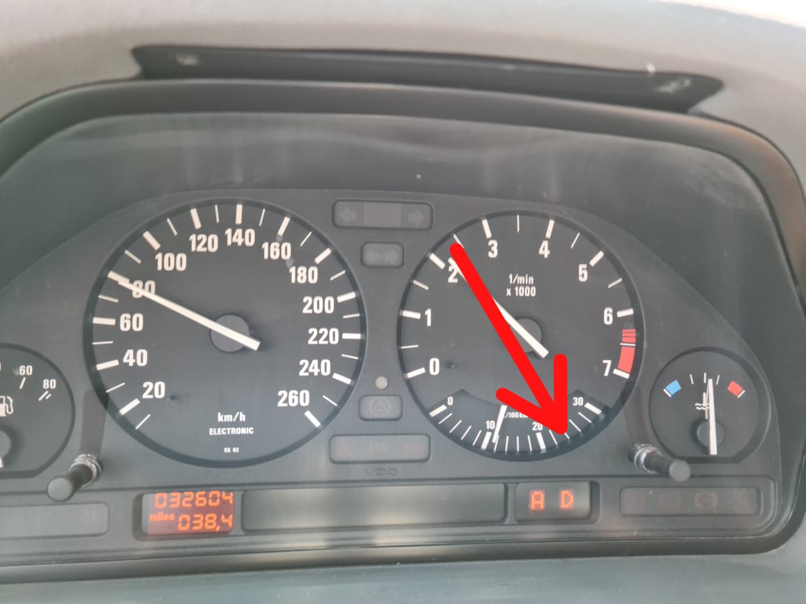

I just bought an E34 540I 1996. The car has just covered over 32k miles and my plan is to bring it back to its former glory. One of the issues I want to solve is that the odometer reads in miles even tough the car is Euro Spec and all the dials are in metric units.
I read the useful information provided by Antus and Gasplanet and I am ready to reprogram the 93C56B chip on my coding plug. But I also want to know if you could help me with other parameters.
I have noticed that my Tachometer is way off. It idles at just over 1k (which I think is high for the V8) and it goes up really quick, surpassing the 7k redline and going all the way trough an hypothetical 9k rpm (invading where the econometer needle is located) when the rev limiter finally cuts the fuel. I suppose this is because the plug is not programmed for an 8 cylinder car.
Also when I do the cluster test it shows no BMW part number or VIN number (0000000), just the code plug number, speedometer factor, Software version and update index. Is there a way to add the last 7 characters of the VIN?
I share pictures of the car, the cluster (showing where the tacho hits the limiter) and the BIN reading of the car-
Cheers and thanks for your help.

Posts: 9028
Re: Modifying a BMW E34 M5 dash (NMC9346EN chip)
I think you need to reprogram the code plug with the various files above and try them all. See if any of them have the correct setting for the tacho. If they do then cut the files in half and join two different parts together and re-test. Slice the files in different places and eventually you can narrow down which byte or which bits need to be changed to get the tacho to read correctly. Please also read and post up your original code plug and anything you learn. The more people have to play with the better. I believe this process, and many flash and test cycles was how gasplanet found the kms byte. To upload an image use the "post a reply" button at the bottom and on the reply page use "upload an attachment" -> browse -> (pick your image) / ok -> Add file. Then type your post in the box and click submit.
