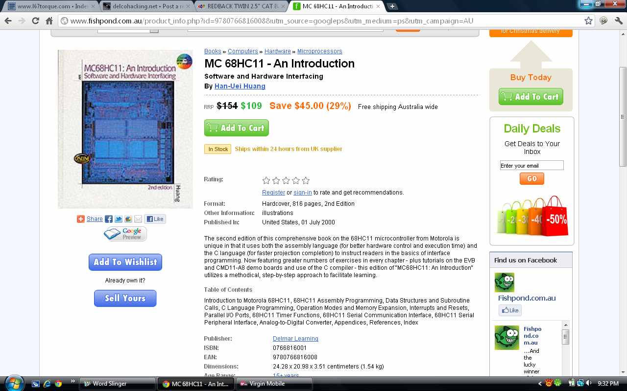

sprattzvx
Posts: 200
Joined: Tue Jul 05, 2011 11:29 pm
cars: Vxl67
Ke30 2door
Re: delco code related books
Post by sprattzvx »
hey all. looks like this is gonna be my chrissy present from the missus and ruggies :D
i had a look over a few sample pages, and it looks to cover most of the basics in a tutorial type format. bit pricy.
