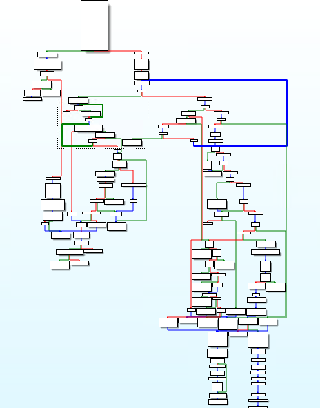

Ive been trying and trying and I think I might have found it. This is the largest routine when some chunks are disassembled as Intel 8051. Surely this has to be a real routine? I can see it is referencing hardware inputs. But having said that, some architectures just look better than others by fluke, too. I'll see if I can make any more sense of it, but I dont really know what the code should look like, and Im not familiar with the platform. Loops and multiple selective code paths that then join back together do look right, as well as small code blocks followed by conditional branches. But there are nops in strange places, and Im not sure if for example this could be a real routine with padding or not. Also 8051 is a pretty old platform to be used in 2006.
; CODE XREF: ROM_27B42-232↓p
ROM:2610D
ROM:2610D ; FUNCTION CHUNK AT code:000060AC SIZE 00000020 BYTES
ROM:2610D ; FUNCTION CHUNK AT code:000060D5 SIZE 0000000F BYTES
ROM:2610D ; FUNCTION CHUNK AT code:000060E9 SIZE 00000003 BYTES
ROM:2610D ; FUNCTION CHUNK AT code:00006103 SIZE 00000002 BYTES
ROM:2610D ; FUNCTION CHUNK AT code:00006114 SIZE 00000003 BYTES
ROM:2610D ; FUNCTION CHUNK AT code:0000615F SIZE 00000003 BYTES
ROM:2610D ; FUNCTION CHUNK AT code:00006701 SIZE 00000003 BYTES
ROM:2610D
ROM:2610D 20 30 A2 jb RAM_26.0, code_60B2
ROM:26110 00 nop
ROM:26111 20 30 98 jb RAM_26.0, code_60AC
ROM:26114 00 nop
ROM:26115 20 2F 38 jb RAM_25.7, code_6150
ROM:26118 00 nop
ROM:26119 20 30 A8 jb RAM_26.0, code_60C4
ROM:2611C 00 nop
ROM:2611D 20 30 A4 jb RAM_26.0, code_60C4
ROM:26120 00 nop
ROM:26121 20 30 AC jb RAM_26.0, code_60D0
ROM:26124 00 nop
ROM:26125 20 30 AD jb RAM_26.0, code_60D5
ROM:26128 00 nop
ROM:26129 20 30 E8 jb RAM_26.0, code_6114
ROM:2612C 00 nop
ROM:2612D 20 2E 80 jb RAM_25.6, code_60B0
ROM:26130 00 nop
ROM:26131 20 30 3F jb RAM_26.0, code_6173
ROM:26134 B5 FC 4C cjne A, RESERVED00FC, code_6182+1 ; RESERVED
ROM:26137 DC 26 djnz R4, code_615F
ROM:26139 00 nop
ROM:2613A 73 jmp @A+DPTR
ROM:2613A ; End of function ROM_2610D
- 8051.png (21 KiB) Viewed 7970 times
