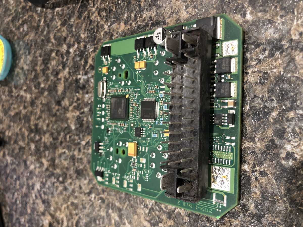

I wish your controller didn't use a BGA chip. My BCM used a QFP package, so I was able to trace out the JTAG pins. In your photo, there's a little 6 pin footprint that might be it. Do you have some hardware part numbers for similar controllers? Did the 1500s use the same hardware? I might see if I can pick one up cheap.

Before I setup the brute force attack, I'll probably take this newest one apart and see what I can see. I do agree, there has to be a JTAG port; it's just a matter of finding it. I have a feeling it may be under one of the solenoid valves.
Do you have hardware for dumping through the JTAG pins? I may need to buy that in prep for dumping it. I'm sure I can get the dump and post it so you don't need to worry about it- just need a little direction.

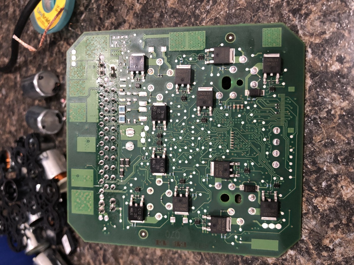

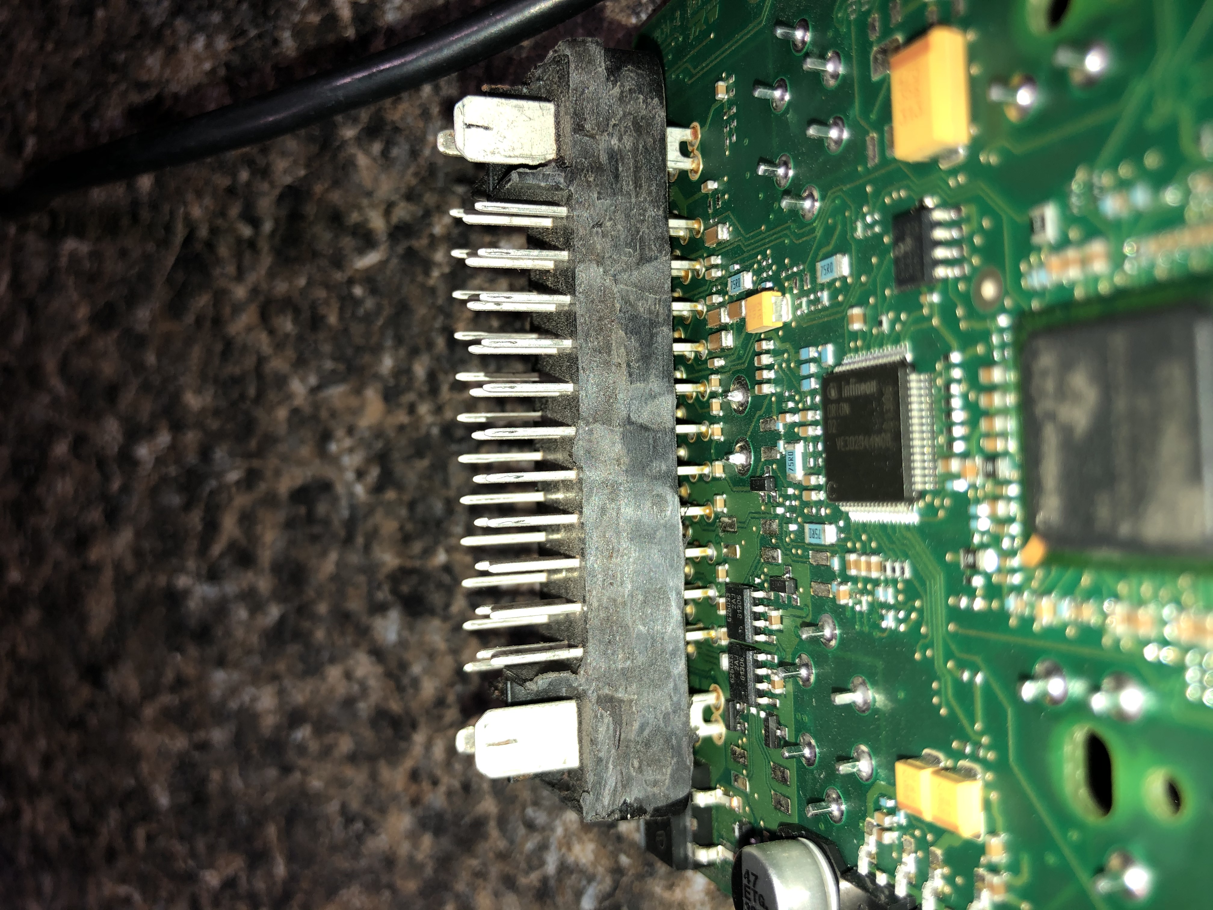

Re: Updating GM EBCM Checksum
cleaned the board from all the solenoids and connectors that are on the bottom. I was really hoping there would be an obvious JTAG header...but I don't see one.
attached some pics.
attached some pics.

- Gatecrasher
- Posts: 273
- Joined: Sat Apr 25, 2020 6:09 am
Mine wasn't obvious. I traced the pins back to vias and soldered wires to those. My chip was a QFP package, so I was able to trace the pins out. I didn't have to remove any resistors to make it work.
That unpopulated 14 pin pad near the main connector looks promising.
