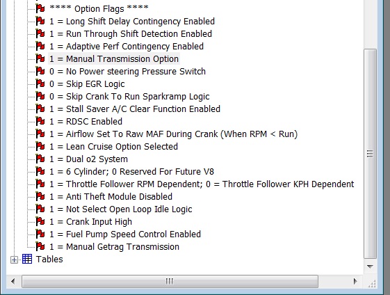

L67PSI
Posts: 178
Joined: Mon Dec 12, 2016 11:27 am
cars: L67 VT Calais
Re: The1's Enhanced Factory Bins
Post by L67PSI »
Just a question for VS V6 N/A with manual transmission. There are 2 flags one says "Manual transmission option" other is "Manual Getrag transmission"
Need some advise here please. (See pic)
Posts: 4814
Manual for t5 then tick manual & geteag for geteag.
L67PSI
Posts: 178
cars: L67 VT Calais
Post by L67PSI »
Just the info I was after. Thanks :thumbup:
