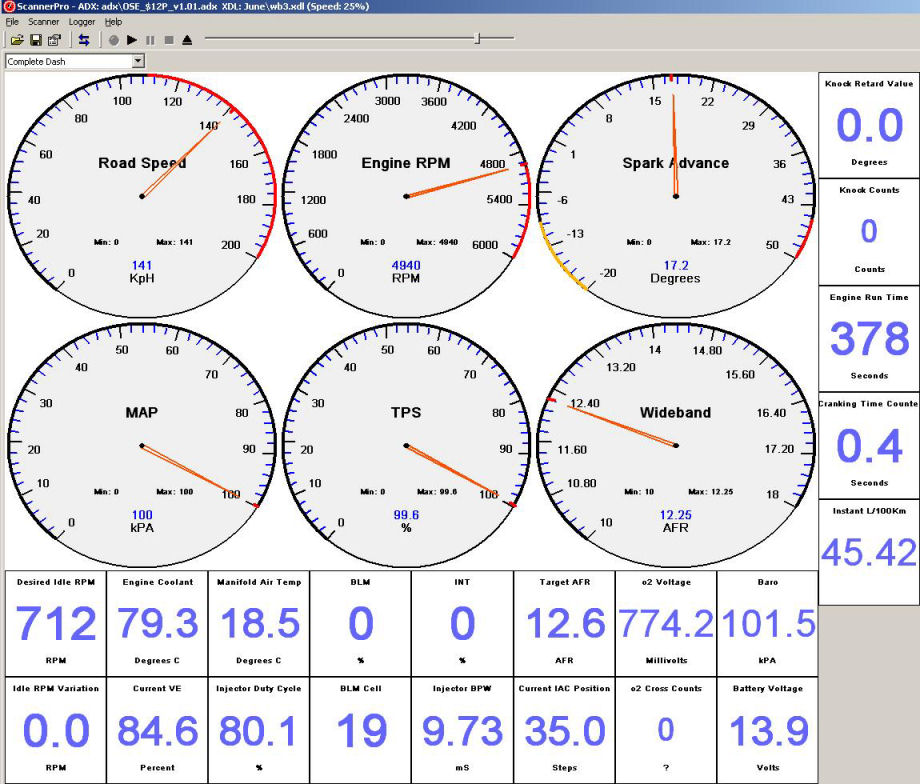

After some great work by VL400 i have been testing the $12P code for him .... heres a teaser for yas :) VL400 will be able to fill you in on its release date and feature set, some of which you can see from the teaser :)
$12p - wideband log.JPG (150.61 KiB) Viewed 10959 times
Re: OSE $12P Teaser
After some good testing from holden202 (should be holdenecotec now!) it looks like the integrated wideband logging is working well. The $12P bin that he is running has a few extra features but is still in its early days with lots more to be added.
So far the additions from the $12S code are....
Spark Output For All Ref Angles Between 0-90deg - Camira module support
ID Memcal Number Of Cyl - Can now tell you what memcal you have plugged in or the jumper config on the NVRAM board
4, 6 or 8 Cyl - Added 4cyl support
Added Knock Counts, Current VE and L/100kms To ALDL Mode 1 Message 0
VS or VR Anti-theft Option - One bin for VN to VS
Wideband Integration - Raw 0-5V Wideband A/D Is Part Of ALDL Message 0
Map Switch Function Using Pin B9 (only does dual rev limit data so far, but wil be spark and afr tables soon)
Soft Touch Rev-Limit - Based on the formula holden code with extra spark retard function, drops injector events as RPM gets closer to upper limit.
There is no release date yet but am slowly getting through the things I want to add. Will keep this thread updated with whats happening :D

WOW is all i can say thats some pretty cool additions there :mrgreen: going to be good when you get it finished think its time to find a new car so im ready for the release LOL

Just a quick question the wide band o2 is that just for easier logging or does the ecu use the data for closed loop control.
Top work by the way can't wait to try the code out.
