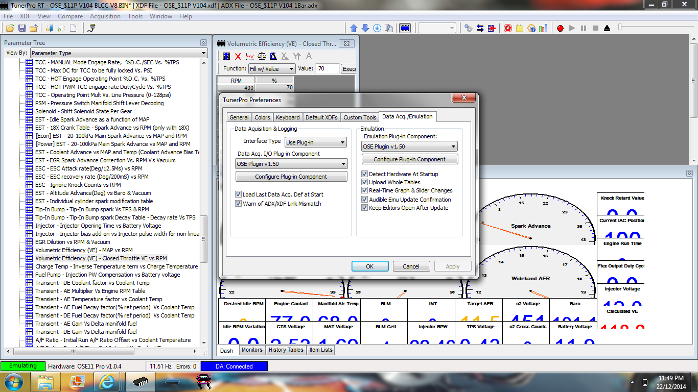

The upload failed at the bottom of the screen is my fail lol
tp fail.png (245.84 KiB) Viewed 18429 times
Posts: 5637
Re: OSE 11P V104
maybe load an unstacked bin in tunerpro its only stacked to fill the nvram without people messing with stacking etc .

delcowizzid wrote:maybe load an unstacked bin in tunerpro its only stacked to fill the nvram without people messing with stacking etc .
Yeah I thought as much. Tried it anyways and still no luck with uploading hmmmmm
Posts: 5637
Re: OSE 11P V104
cant remember if vr auto ecu allready has the write line wire or not plus i presume you have the plugin for tunerpro installed

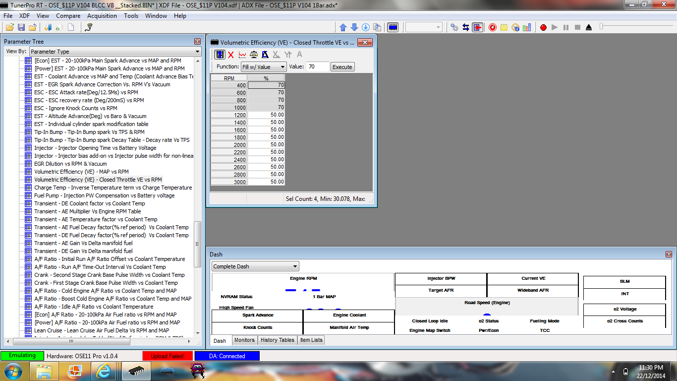

Posts: 5637
Re: OSE 11P V104
untick upload whole tables will make uploads faster will just upload the changed cells only i never have that ticked .
while logging goto items list veiw and choose message 0 status flags only and see what nvram status says

Post by krusty »
Ummmmmmm...nvram read only ffs :cry:
I'll now go n swap that on the board whilst self administering some slaps to the head :afro:
Posts: 5637
Re: OSE 11P V104
haha must need the write line wire added under the ecu main board or write protect jumper is on i presume you using your own gear LOL
