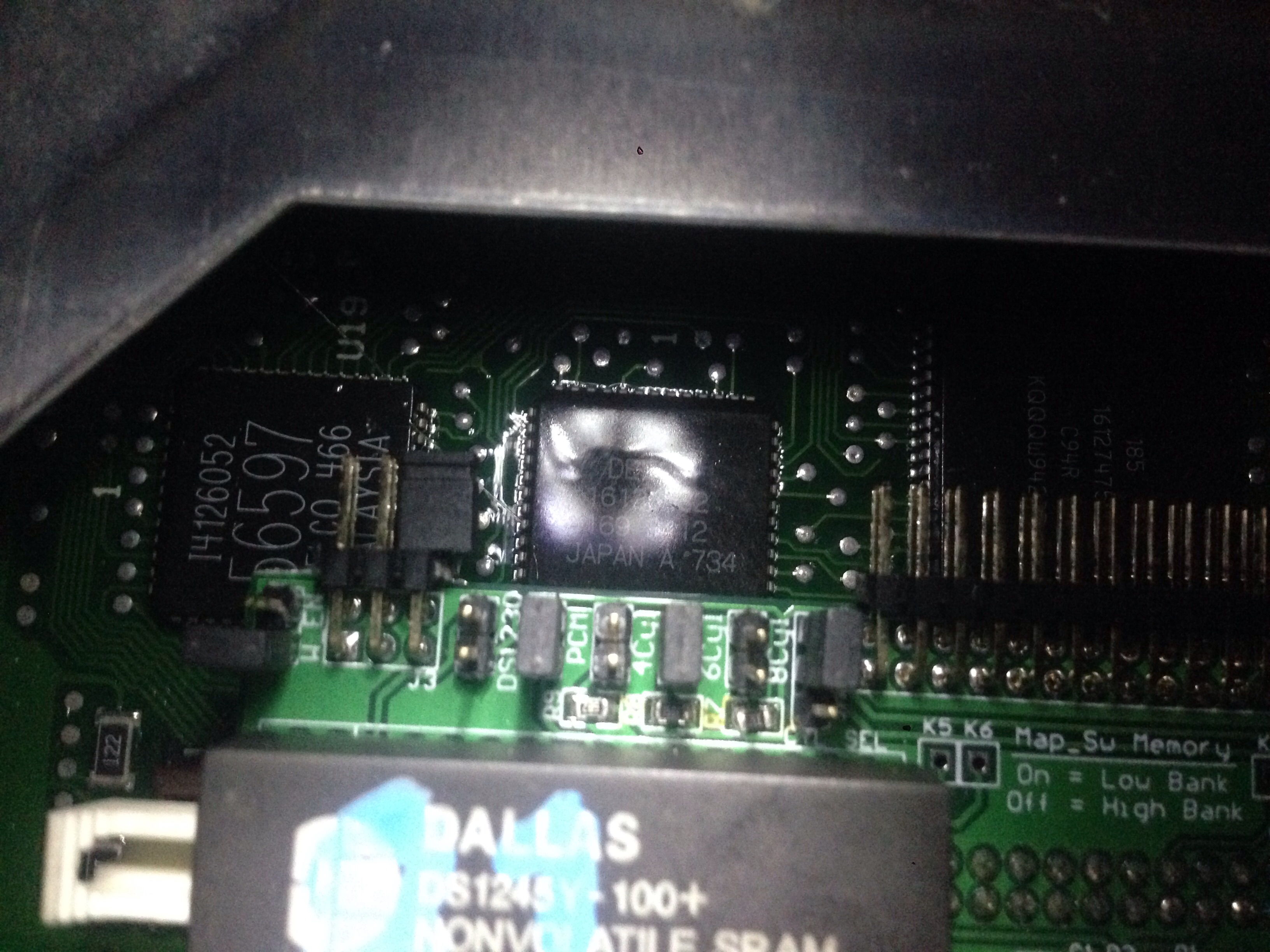

delcowizzid wrote:haha must need the write line wire added under the ecu main board or write protect jumper is on i presume you using your own gear LOL

Soldering on the 424? Unsure where to target as Ive got no info for that
This is my jumper config
Re: OSE 11P V104
There is a pic in the NVRAM instructions on where to solder the wire to the '424 PCM. Like the '808 it needs a wire added to the PCB.
Let me know if you dont have the PDF and can send you a pic.

VL400 wrote:There is a pic in the NVRAM instructions on where to solder the wire to the '424 PCM. Like the '808 it needs a wire added to the PCB.
Please semd me a pic mate. the drop box from ages ago is no longer working

jumpers look wrong .on 6 cylinder and no write enable jump

delcowizzid wrote:jumpers look wrong .on 6 cylinder and no write enable jump
Yep, just picked that lol. Lucky it's nothing more than idle n was on stoic
