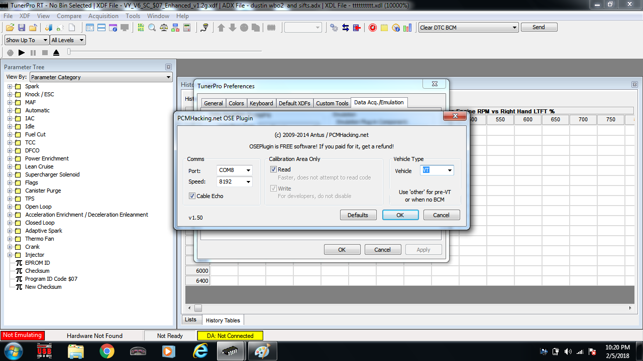

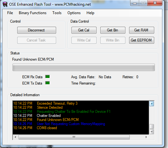

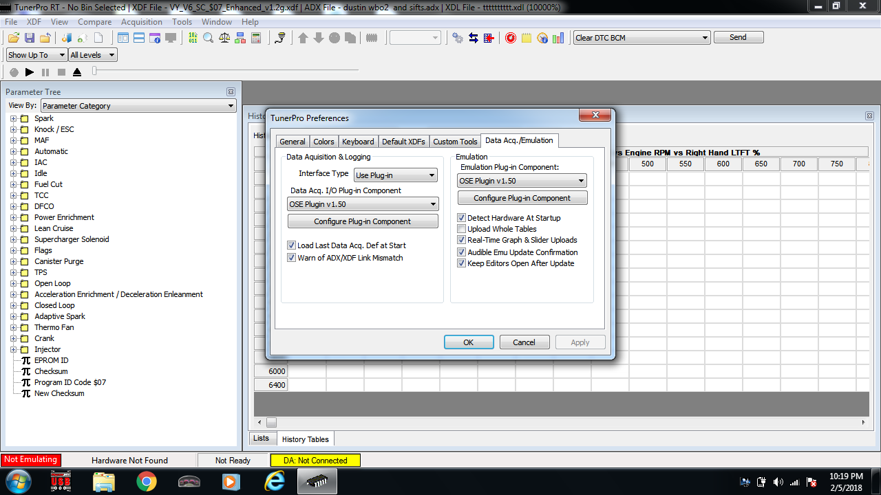

I can connect to the Ecu with either the NVRAM or the old Memcal in there with the OSE turned off, in tunerpro, but the flashtool when it finally gets a heart beat returns ECU unknown
The screenshots are not mine
both jumpers are on VT and the R/W
i only get the memcal error when the NVRAM is fitted,
all the settings and plugin etc are all per the guide ose1.5
ive attached the Bin file that i am using ive tried using my spare ecu still no love and also different cables ive had over the years,

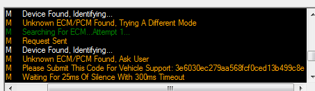

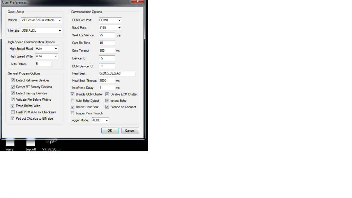

ive uploaded some screens and log

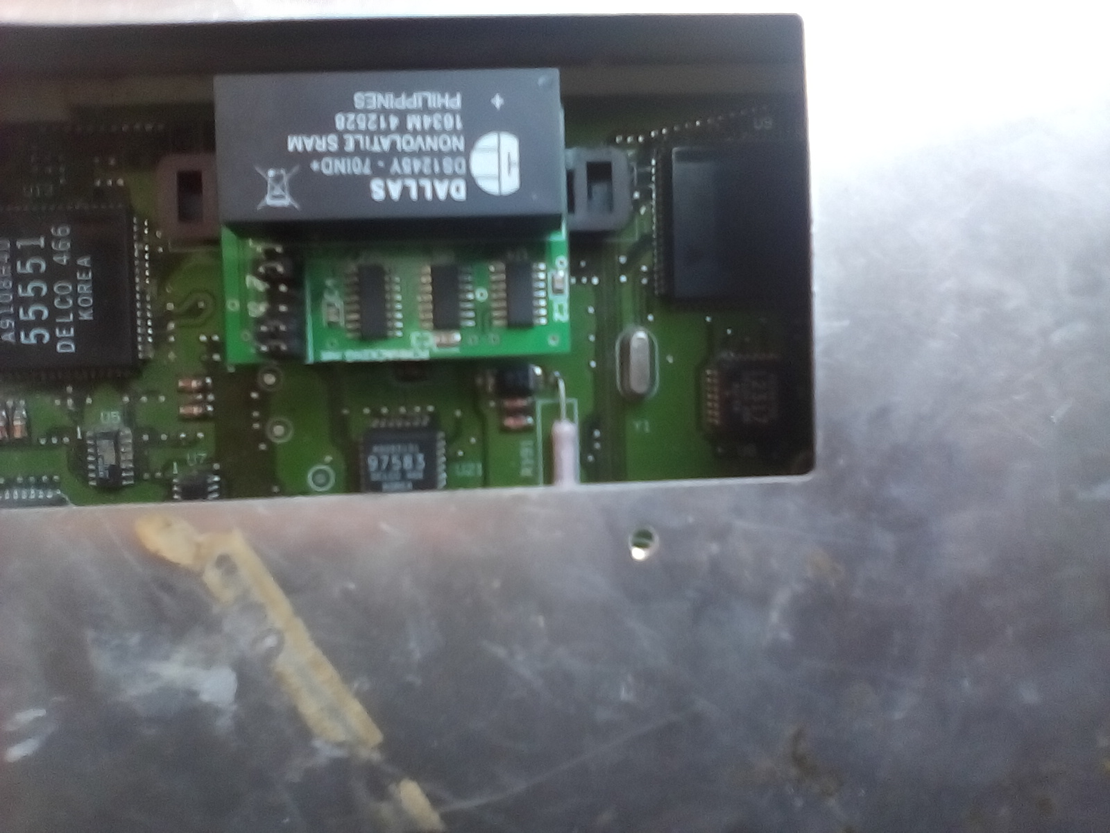

Photo of the chip and jumper settings, these have been unchanged since i revived the chip from bigvl
[attachment=0]IMG_20180205_181735.jpg[/attachment
i fitted the nvram with the ecu unplugged from car

when i put in the original memcal (The1) i can connect to the PCM on the logger v2 mode, it lets me download the BIN and all the other things there
but it just wont connect to the NVRAM and even on logger v2 mode returns the unknown ECU. the cable is the one i got from envious customs so i could calibrate my fuel guage and set the airbag system etc, he made point that a cheaper cable may not stay connected and that could potentially brick your dash or other things you where flashing with it, so i doubt the cable is the problem nor none of my wiring or my current bin,, so no memcal error on my old memcal, same bin but slightly different timing tables, so shouldn't really make any difference to this problem, but as soon as the nvram goes in its memcal error 51
has to be a dodgy NVRAM?

Yes, the NVRAM does sound corrupted. You can get a minipro tl866cs programmer pretty cheap from ebay and fix it yourself. This is recommended as you can use it this time and in the future should you need it agian. Failing that biggvl should be able to fix it up, or I can. I'd also recommend keeping RW unset until you have everything working as it can prevent this from occurring while plugging the nvram and/or if the wrong file is accidentally uploaded to the car or the wrong xdf is used etc.

- Posts: 9026
Re: NVRAM problems
