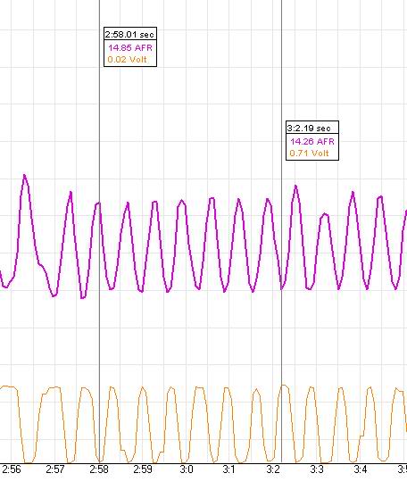

The narrowband should be more accurate for showing stoich as it basically swirches either side. Here is my narrowband and wideband during closed loop...
v8hilux: your better off getting the wideband to read correctly than trying to fudge it. Or tune off the wideband display and not TP display.
