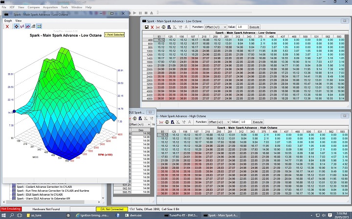

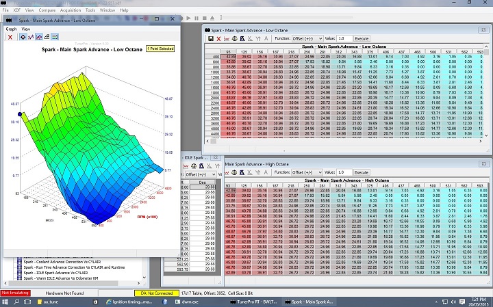

The factory code for the VS SC CKUM, even with the transmission flags disabled- is shit to drive as a manual. It pig roots and carries on at light throttle and low rpm.
Probably no surprise to anyone really. I converted over to 'The1's version of my memcal for later upgrades.
Some time learning and investigating, with the aid of the memcal tool (unmolested bins to study)
I've discovered the primary reason hiding in the spark tables.
I've found heaps of different things like the IAC tables, and RDSC, and IDLE spark- most of which I've copied over with some level of guess work.
then its related by birth auto version

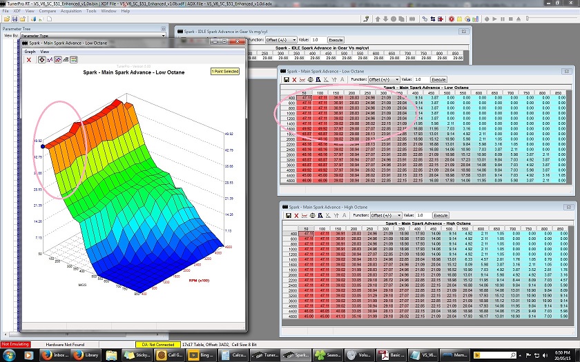

And the similarities to CKUM / $51_VS_Enhanced - Autos have a lot of timing dialed in down low, torque converter load probably.
So, I've gone and transfered the cells up to 1800 rpm, and 250gr/sec like so, and shaved *10 more degrees in the first two impossible columns.
And the difference is incredible. I picked these cells after watching/replaying the log trace bubble while driving at low rpm and seeing crazy advanced timing on almost no throttle. Car park and traffic light crawling type stuff.
These is still a long way to go to finish my tune, but I feel a lot closer to the end than at the start.
Thoughts?

looks like your on the right track!
- Posts: 10014
Re: VS SC $51 Enhanced on T5
Thanks for posting such detail with all the screen shots. Well documented. I think I'll FAQ this.
- Posts: 3364
- cars: VR Commodore V8
I've noticed similair things on cars with large cam shafts and manual trans.
Less timing doen low helps with the pig rooting. A richer afr does help but I've found less timing is better.
Good work though always good to have a win.
