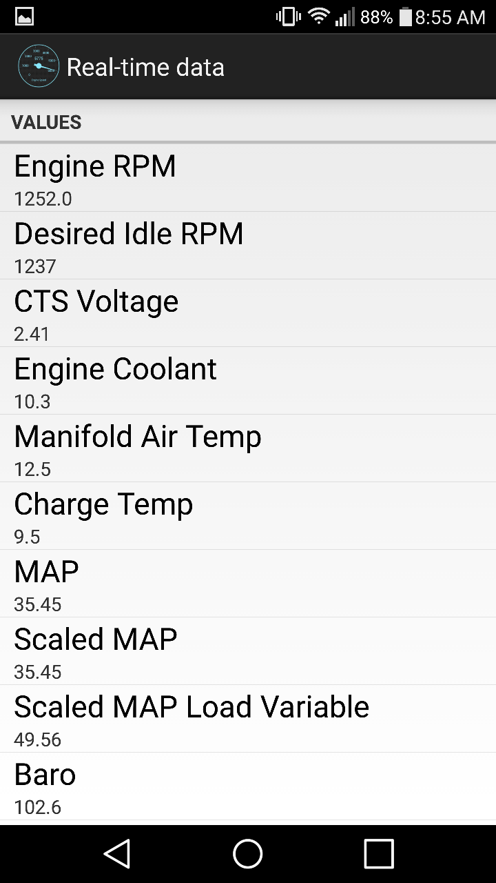

Re: ALDLDroid Android App
Did a quick data log using the above yoda adx.
Everything is screwy on the dashboard. Trying to figure out what is going on with my badly running VY n/a V6 atm.
This what I am seeing all the data is erratic. When using it on my old Hilux with Ecotec V6 , VT PCM & no BCM & correct adx it works fine.
Both screen shots are while sitting at idle after starting.
If only I knew how ?yoda69 wrote:I’ve never played with ALDLDroid but sounds like it will be to do with the rs232 echo settings.
Try changing to the opposite of what they are now.
In settings I don't see the choice ?
Do it in tuner pro and save the adx again maybe?
yep, plug the device into the PC, find the adx and load it in tunerpro, change the setting then save.
