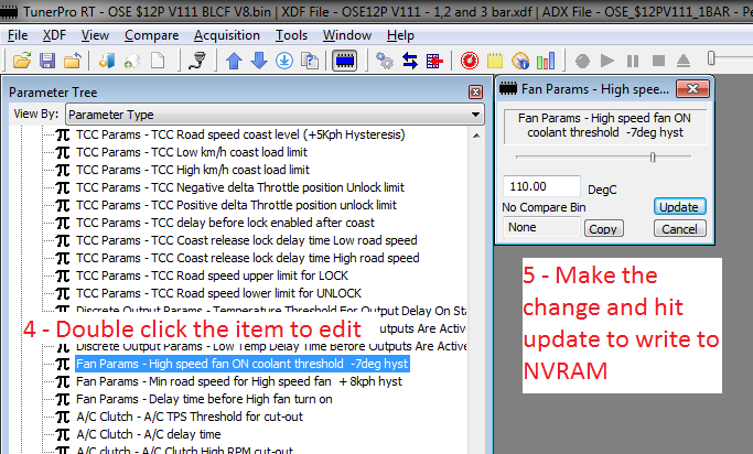

adjust fan kicking temp on a vn using vl400 nvram chip
Hi im new to this im currently run a vn series 1 in my 1962 ek and wanted to adjust the temperature that the themo start as the std seem a little to hot for my likings
i have the latest rt and pluging and wanted to knowwhat tables i need to edit to lower the temperature in using the os$12 adx
also and other adjust so the tune suits the motor better
please keep it simple picture would be even better lol

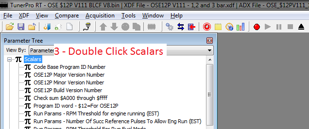

Re: Help with getting started
Pretty much like this to start making changes after you have loaded the correct XDF to match your bin, adjusting fan speed as the example...
ah thanks again Vl400 ypu have been a life saver today
