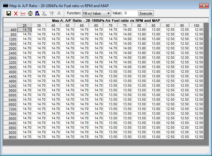

Petrol open loop afr table

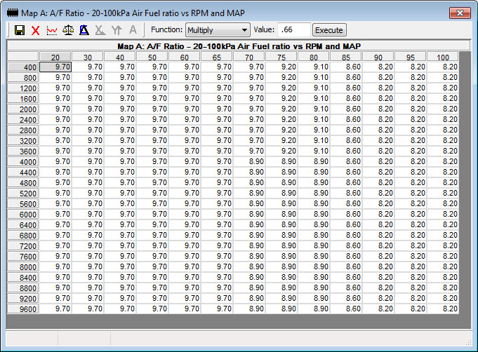

the same table offset by 66% (the difference between petrol and E85 requirements.)

now if you put any of the E85 afr numbers into the spreadsheet you will see that it will increase the bpw output by pretty much 66% more than the same given number in a petrol AFR table.

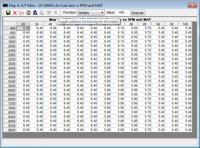

and if you wanted to apply the same theory to methanol it will similarly increase petrol bpw output to approx 2.3 times by simply changing the target air fuel ratio from 14.7 to 6.4 for methanol.
