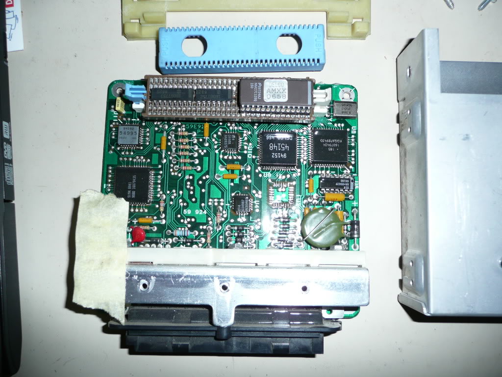

Ok this is the Delco that was running my 2.0L Isuzu Engine in my Gemini...
Can you guys recognise it ( meant to be off a VN) ??
what can you tell me about it , is it unlocked ??
For sale soon , whats it worth ??
What Delco is this??
GEMWRC

Memcal sticker is camira This link might help http://www.techedge.com.au/vehicle/1227808/fourbins.htm

That says its a Automatic Transmission one.. my car is manual ??
is this programable or just a Chip swap from a Camira engine with no tuning mods

You would have to read the tune off the chip to see exactly what it is
The chips are reprogrammable and the sticker might have been removed and put back on after being flashed with a different tune
I am pretty sure most auto tunes will run in a manual just some manual tunes wouldn't run in autos
The ecu is most likely an 808 delco

Thanks mate , i was looking for *808* all over it and cant see it

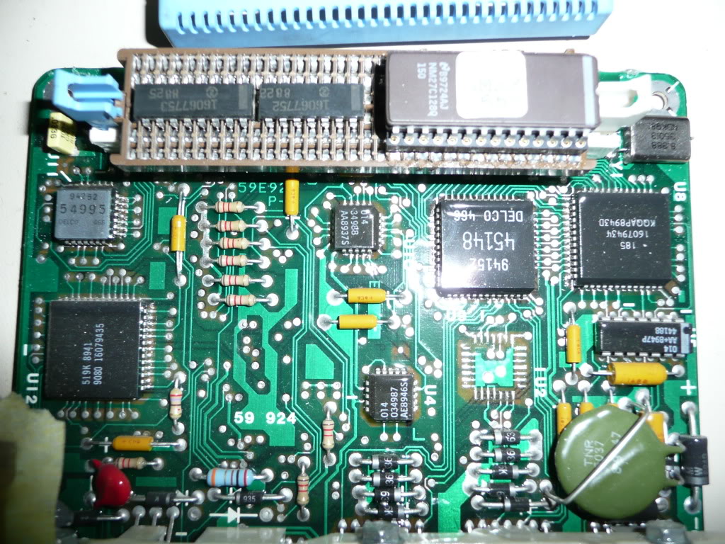

i dunno if its just me, but i've never seen a memcal with the sticker on that way, its normally 90 degrees rotated, this makes me wonder if its been removed and re-applied .... if thats the case maybe its been modded .... but like dec_head said, need to read it to know for sure.
as far as '808' have a look on the aluminium case there should be something like this:
the 1227808 is where '808' comes from.

Yeh that sticker is gone 202..
Still has a Barcode on the plug

Looks exactly the same as the 808's i have here and doesn't have the extra chip for high speed aldl like the vr vs 3082
And that site suggests they run 808's in camiras etc
Re: What Delco is this??
i'm pretty sure its an 808
