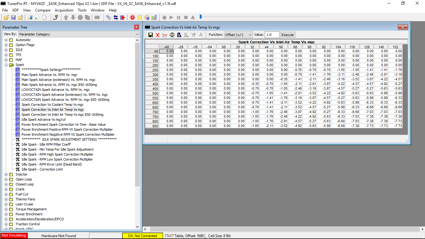

One thing I had though about was to try adding a little more timing when the AIT's drop. There is a table Spark Correction Vs Inlet Air Temp Vs mgc which is normally used to reduce spark timing as AIT's go up.

Currently I'm running the standard MAF and AIT sensor fitted in the MACE CAI box. Will be going to a MAT sensor in the LIM. The table that adjusts the spark in relation to air temp is all zero'd out in the lower AIT region and is only used to reduce timing as the AIT's rise.

I think so too. I'm looking at this tablevlad01 wrote:I'm pretty sure its been discussed before in another thread that the IAT sensor in a MAF system is just used to adjust ignition timing and fueling is entirely done via the MAF and trimming via the O2 sensors
