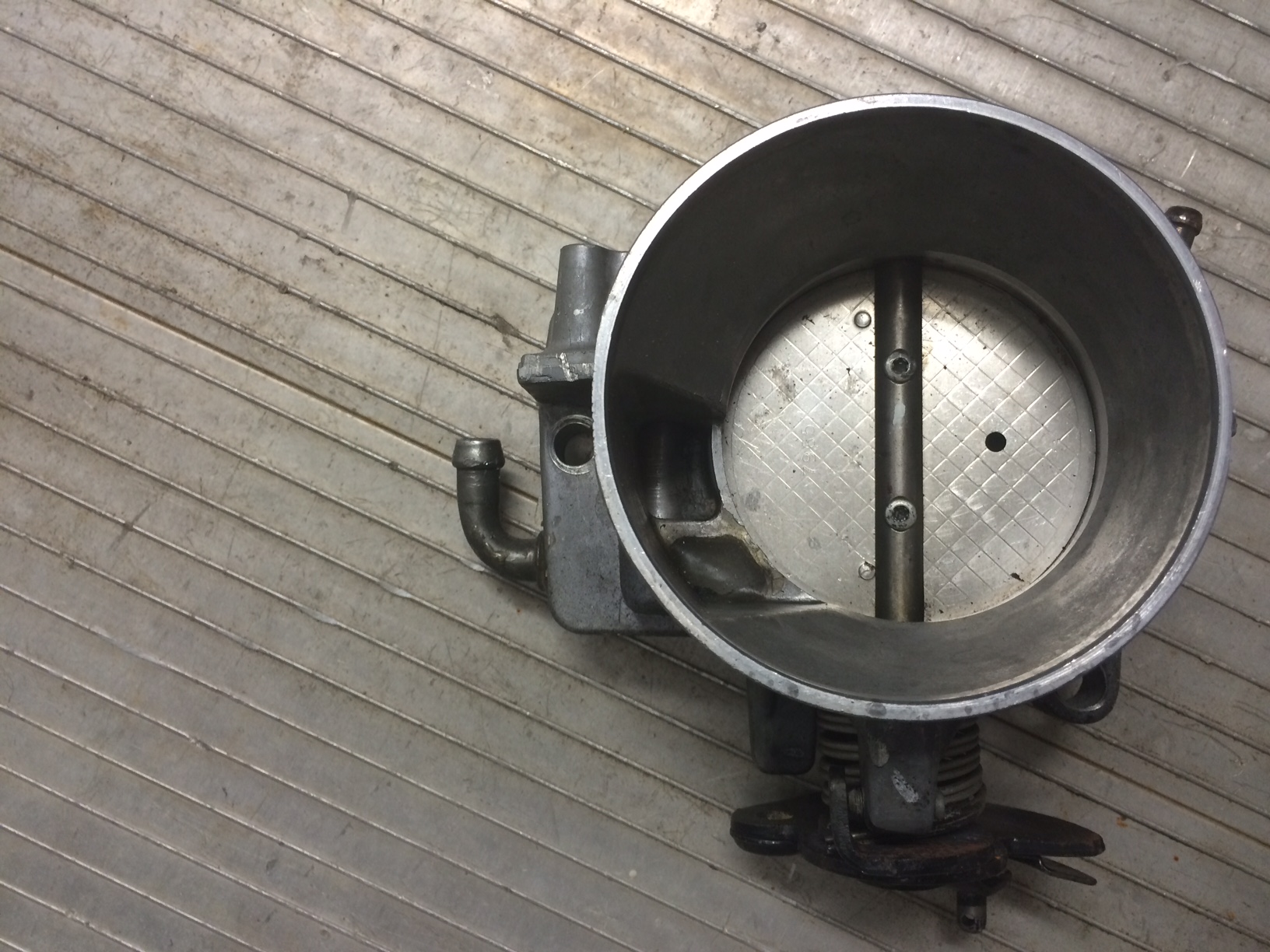

Different set up but I have an LS1 throttle body on my 5 litre. I just used the existing PSV connection on the throttle body near the throttle lever. I filled in the internal port that goes to the air filter side, and there is full vacuum to the connection now. I just used areldite to fill the port.
I actually had to move the 90 deg pipe to the top of the throttle body for clearance issues on my engine, so just drilled a new hole and plugged the existing one with a welsh plug.

Any chance of a photo Brindisi?

Here the inside of the old standard one I had. It also had the elbow moved to the top for clearance and I put a welsh plug in the original hole. Think it was a neat 10 mm from memory.
