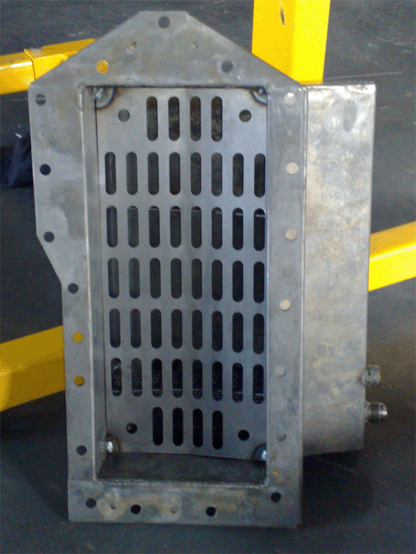

Are you guys talking about NOS Sprint which uses a stock vn-vp engine in a sprint car chassis.
I have a mate with two cars.

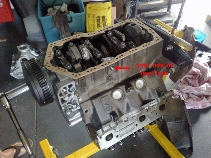

He gets junk engines from the wrecker pulls them down checks all the parts are the approved listed parts and reassembles them to go racing.
The only thing I know he changes is the sump and oil pickup, now goes in the side of the block.
The ecm and memcal can be swapped out at the track by officials at any time as they supply them to start with.

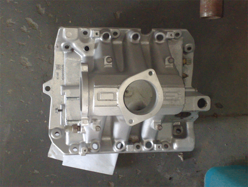

here are some pictures.
will try to get more.
