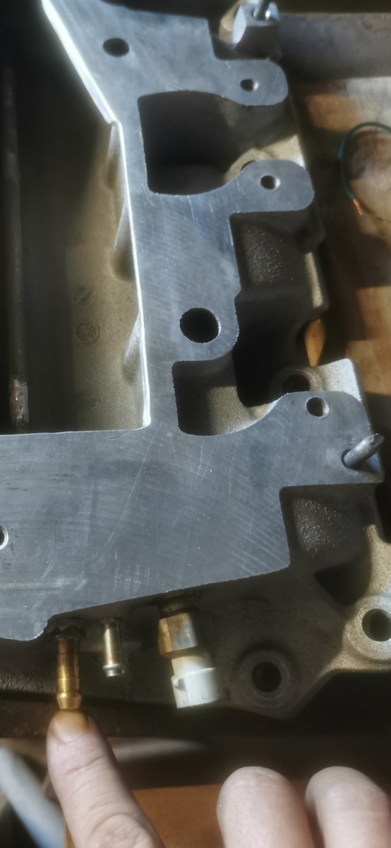

My setup is l67 with a blower swap
98 fuel
Intake air temp sensor in lower intake manifold.
Seeing around 85c at cruise and around 104deg c after a pull. Timing is pretty lazy have checked the plugs and looks like no signs of pinging etc

Where is it mounted? Just under the blower in the side of the runner for No1 cylinder? If so, same spot as ours is.
It's probably a bit cooler over here in NZ.
I've added another snorkel to the MACE CAI which seems to have dropped the intake temps quiet a bit.
Re: Intake air temp pulling timing help needed
Thats were its mounted. Have a 4 inch pipe from behind bumper feeding the factory airbox thats sealed of from any engine bay heat.
