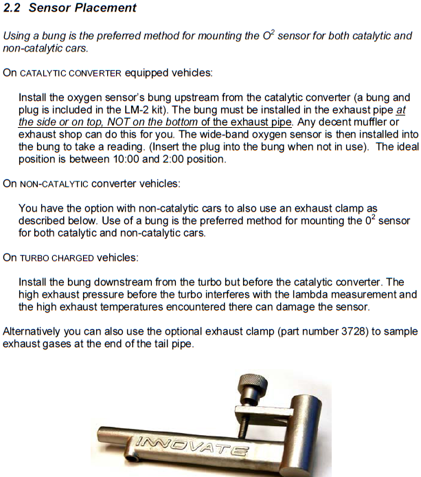

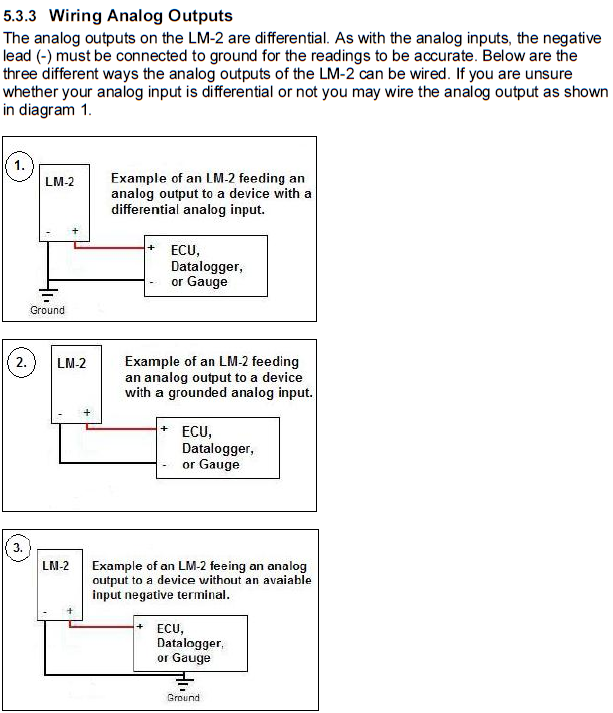

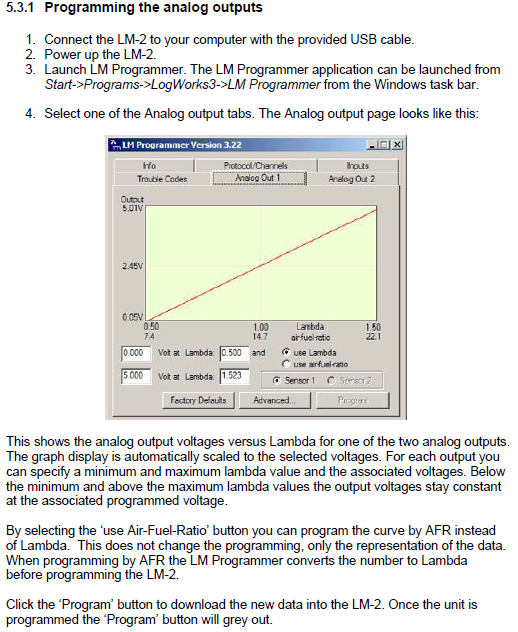

Just thought this might help with general settings with other widebands too...
- Innovate Sensor Placement.png (146.87 KiB) Viewed 9145 times
- Program Innovate Analog Outputs.png (122.52 KiB) Viewed 9180 times
- LM2 Wideband wiring output.png (160.8 KiB) Viewed 9180 times

Ive got the mtx-l and its wired up as in example no.2 which i think is correct.. TP5 and mtx gauge/logwork 3 seem to show the same values now. But im not sure if i can trust the wideband afrs.. they seem to be very lean and different to afr read by the narrowband sensors
