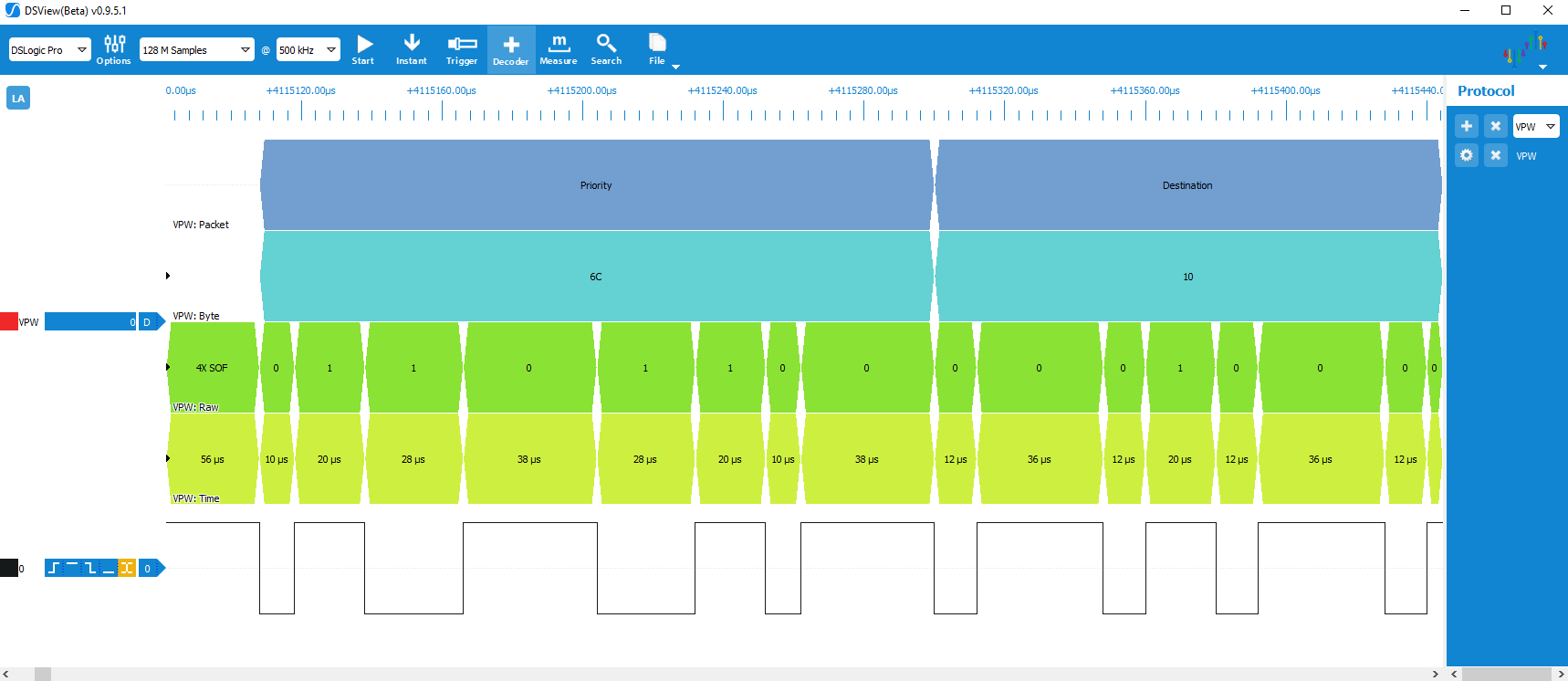

As I have been working on a VPW interface lately, I have had the need to see whats going on with the data bus. I have the vpw specs, but in reality there is differing timing between different devices, and I have found even the same device depending on low or high logic levels.
So I purchased a dslogic pro analyser which includes software based on the open source sigrok project which includes the ability to do software protocol decode in python.
VPW was not supported, so I have written and open sourced such a decoder. It is available at the link below which is directly to the main source file.
https://bitbucket.org/antuspcm/sigrok-v ... ew-default

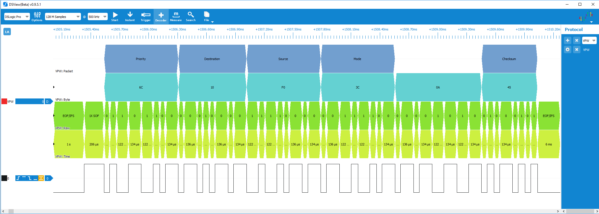

Below are some screen shots. You might need to click a couple of times to expand the images to see all the content. You can see it auto detects VPW 1x or 4x based on the duration of the Start Of Frame (SOF) byte, and then uses appropriate timings to decode the rest of the packet. It does this on a packet by packet basis, so it can follow whats going on even when bus speed is switched.
Most sigrok decoders do not display timing information like this decoder does, but I found the real world timings to be very useful for my purposes so I left them it in.
Update: The plugin has been updated to sigrok api v3 and is available with sigrok. As the dsview product is dead, this would be the way to get this, now.
Sigrok/dsview logic analyser J1850 VPW 1x 4x decoder
