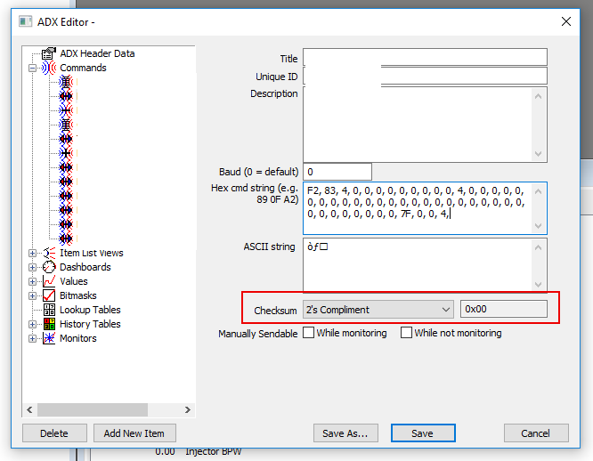

commodorenut wrote:
Ok this string here which i read from the tech 2 will move the fuel guage to half...
F2, 83, 4, 0, 0, 0, 0, 0, 0, 0, 0, 0, 4, 0, 0, 0, 0, 0, 0, 0, 0, 0, 0, 0, 0, 0, 0, 0, 0, 0, 0, 0, 0, 0, 0, 0, 0, 0, 0, 0, 0, 0, 0, 0, 0, 7F, 0, 0, 4, [ check sum ]
checked and works on the OSE tool
so with check sum should be 87
I've been using the method listed below and for the short lines it work fine eg F7,56,0A both doing it freehand and using OSE it comes out to A9 but your line I just worked it out at 0 so there must be a trick
MsgSum - 0x100 = X, X - 0x100 = Checksum
Posts: 9034
Re: C# Cluster Communication Help needed
The string as posted does have a checksum of '00', perhaps there was a type-o somewhere. The 2's compliment checksum is the lower 8 bits of 0x100-(sum of all bytes). You can also build an ALDL string in tunerpro and ask it to calculate the 2's compliment checksum and you can see what it has come up with on screen when you dont have any hardware handy.
cs test.png (22.66 KiB) Viewed 6222 times

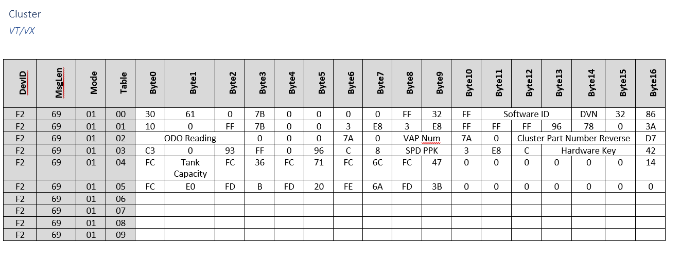

commodorenut wrote:Ok im going not bad here
Next step is to read cluster and populate Part number, Production Date, Instrument type, Fuel Calibration.. & READ ONLY Kilometres
Please Note: Anyone inboxing asking how to alter kilometers will be ignored..
have you worked out where it at all is in the Custer? I have a few bits from a vx cluster I can post if it helps out

megajuz3003
Posts: 74
Joined: Sun Aug 26, 2012 9:47 pm
cars: 2001 VU SS
Location: Brisbane
Post by megajuz3003 »
this is what I have worked out for VT-VX might be the same... not to sure but it might help
