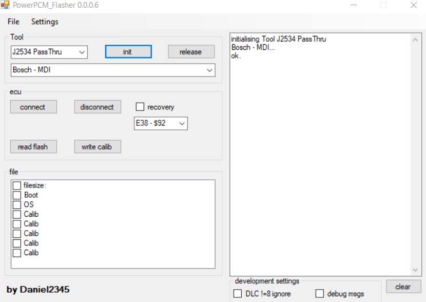

A quick tool connect confirms my Nano is recognized by the PowerPCM_Flasher app v 0.0.0.6, when GM MDI is connected from the J2534 device list. I am not close to test it with an ECM, but I will be later today and can confirm more from there. My VCX Nano is an original, not a clone. I did NOT have VCX Manager running, just plugged the Nano in to the laptop.
VCX NANO AS MDI A.png (50.35 KiB) Viewed 17700 times

BillNobody wrote:A quick tool connect confirms my Nano is recognized by the PowerPCM_Flasher app v 0.0.0.6, when GM MDI is connected from the J2534 device list. I am not close to test it with an ECM, but I will be later today and can confirm more from there. My VCX Nano is an original, not a clone. I did NOT have VCX Manager running, just plugged the Nano in to the laptop.
It will init just fine but error out when you try to connect to a vehicle/ecu. Look back a few pages in this thread I posted a log of the pass thru driver and what's going on.
