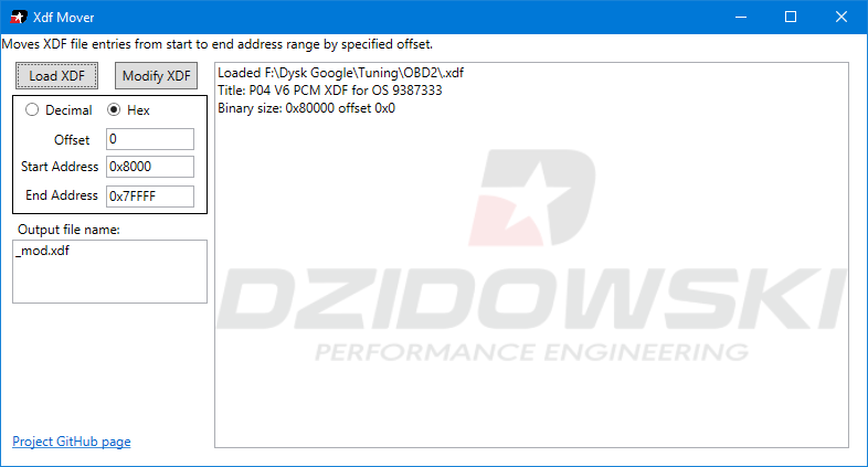

I made a small program to help editing XDF files, especially for OBD2 applications.
Many OSes have the same parameters but located at different addresses, usually whole sections moved an offset as variables were added in development.
This tool allows to offset addresses of all the xdf entries that are in specified address range. Simple as that.
I hope it will be also useful for you folks :)
The repository is https://github.com/dzidaV8/XdfMover
XdfMover_v1a.exe
(47.5 KiB) Downloaded 391 times
Xdf Mover.png (35.9 KiB) Viewed 5788 times
To use, you just load the base XDF, and edit the offset and range. Offset can be negative. The program will tell you if the values are out of range.
Select a name for modified file (it adds "_mod" suffix to the base file by default) and click Modify XDF.
You can also select the same name as base file, then it will update the file. Might be useful moving a few different ranges in one file.
I know that it's not much, as it's my first C# project, but it might be useful :)
[EDIT] If any of you downloaded XdfMover_v1 then delete it and get v1a. I uploaded wrong file and it did not process Xdf tables. Now is all OK.
