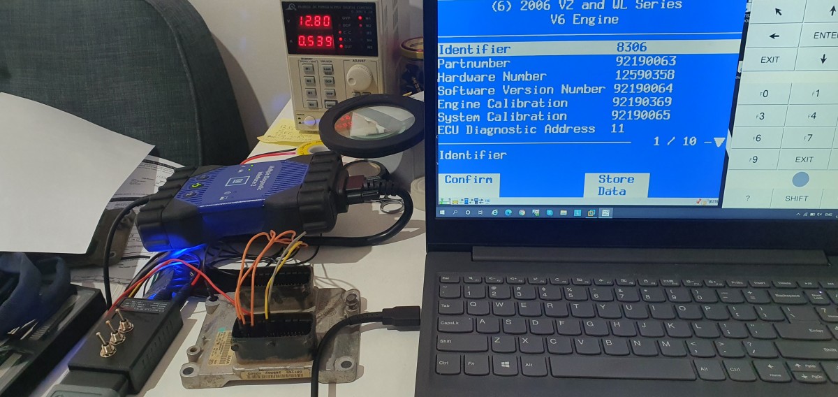

Ill give it a go over the weekend when I get a chance to setup an E55 on the bench

I've got a few here. I'll hook it up tomorrow and let them run.

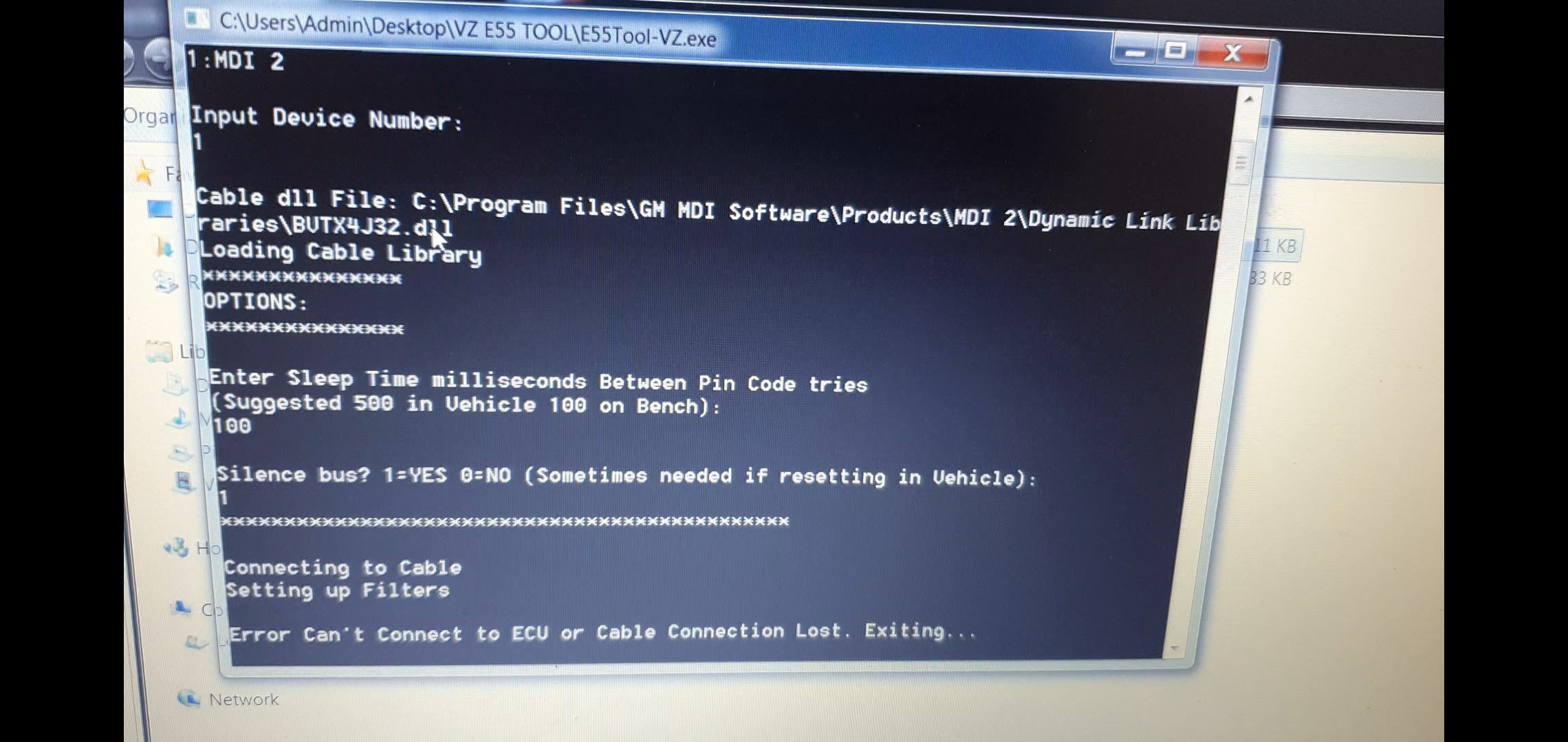

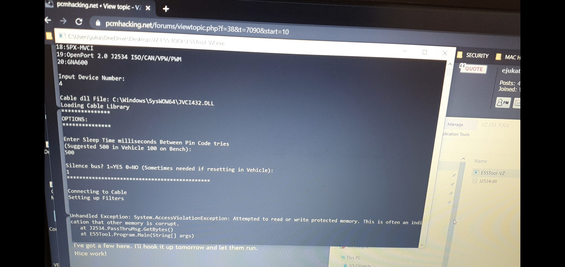

I just tried on 2 ECUs. It crashes after trying to connect.
Both connected on the bench, both have comms in t2w, 1 I know is timer locked and the other is not at the timer stage.
Tried on Win10x64 with MDI2, VCM2 and the Autel J box.
Tried in Win7 x32 VM with MDI2.
Anything else I can try?
Re: VZ V6 E55 ECU Brute Force Reset Tool
Thanks for testing.
Do you have the passthrough driver installed for that cable? It doesn't look like it's finding the passthrough dll driver.
You'l also likely need windows 10 with latest Runtimes installed, check here.
https://support.microsoft.com/en-us/top ... f26a218cc0
Im not sure that MDI2 supports passthrough like other cables.
This is my main machine I use for programming with the mdi2 and other devices everyday so it definitely works.
I'll try another PC and get back
