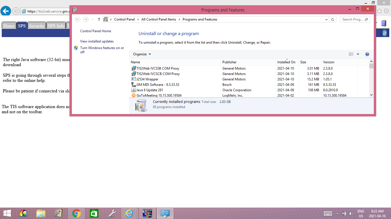

Ya I show the wrapper installed...version 1.05.1

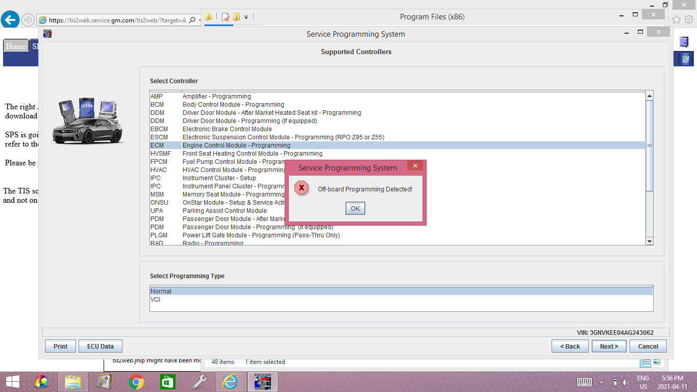

Thanks Tazzi, I very much appreciate that. I deleted the old wrapper in that location and substituted yours, And I was able to get farther than i have before, All the way to this :
Yes I am using a bench harness. Hitting ok on that window sends everything back to square Zero.
