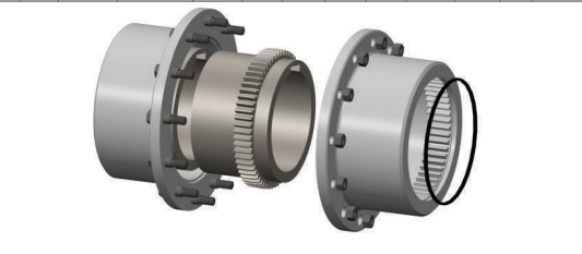

Speaking of which, to join the main hub shaft to the retarder we are using industrial gear couplers. Boy are these killer. In fact better then what i have on my dyno dynamics unit.
Coupler
Coupler
Bonus is, where the bolts go through the coupler is what holds the reluctor wheel for the speed sensor. So we didn't need to machine anything special up.

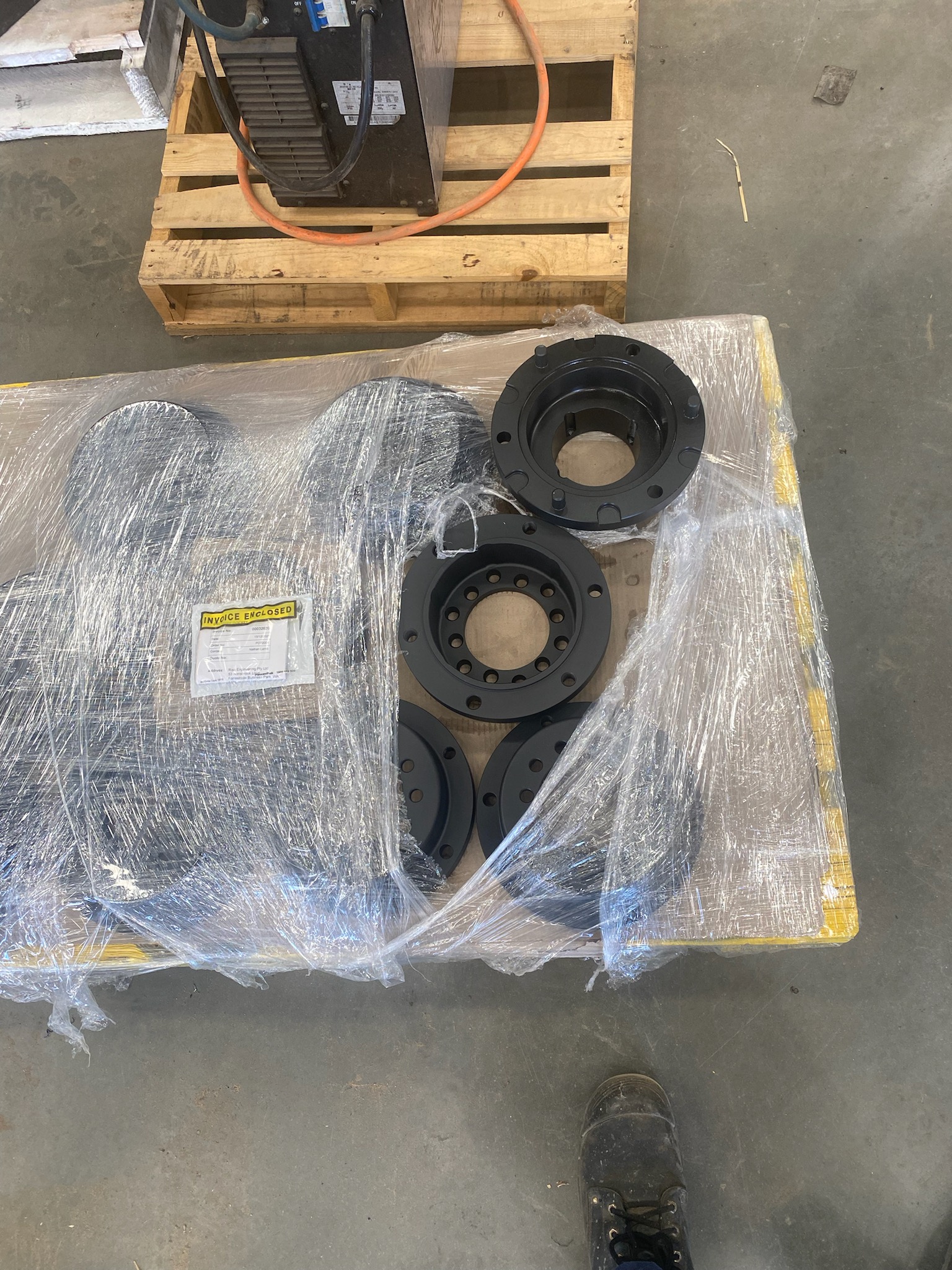

Adapters were sent off for hardening while i was away & have come back.
These boys won't be rusting any time soon.

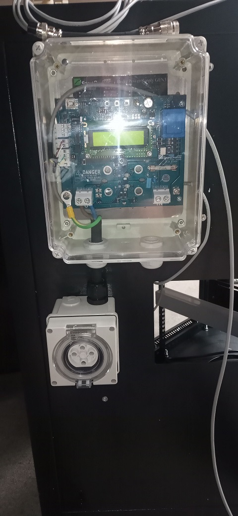

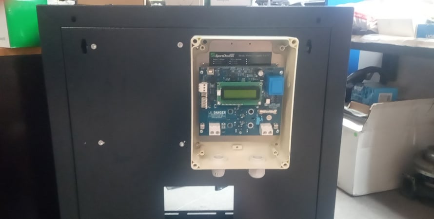

Today i got back into setting up the new dyno cabinet.
Cabinet was originally a standard 24ru unit that i fitted some wheels to, I will probably need to add another set to the rear swing door since the Retarder power supplies & connectors are bolted to & it has a tendency to want to tilt over when the door is open.

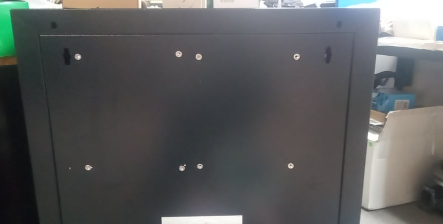

Anyway on to work, I pretty much eye balled all my drill holes & mounting, no measurements done, so if you suffer from OCD then this will probably annoy you. haha.
Drilled, then used 5mm nutserts for the Power supplies & sockets, Since I only had 1 of the power supplies at the workshop, i just used the same unit in both spots to work out best locations for everything.
Nutserts
Nutserts
The idea is I will be supplying the cabinet 3 phase power from a wall socket, then each retarder will get a power phase, along with the cabinet devices, i.e computer etc.
I'll be using sockets/connectors for the power to the retarders as I want to be able to wrap the cables up when not in use or for moving, which is why you see a 4 pin connector already wired in. The other side is the AC power in, which will come from inside the cabinet.
The other wires inside the PS, are the PWM signal for brake load & Canbus for PS diagnostics etc.
