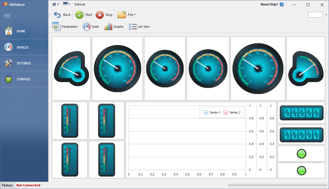

The data logging view has a few different screens to move between which include:
1) Dash - gauges and bars plus small graph view

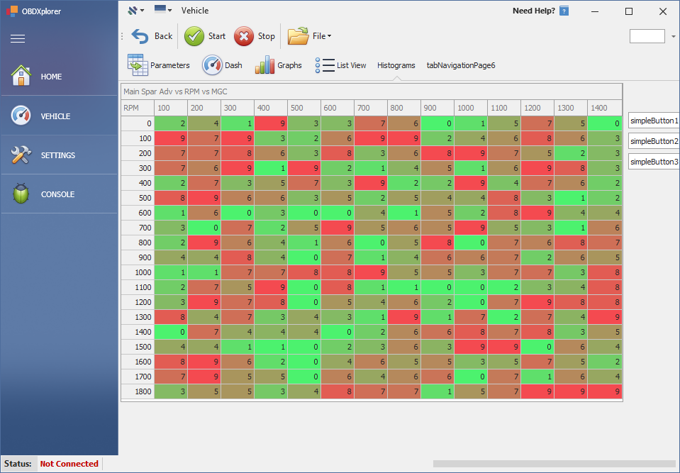

4) Advanced 3 param graph logging - 2 parameters with fixed values are placed on X and Y, and the third (Z) axis is logged to the actual input cells.
Just found out the hard way, that there is a dedicated heat map that I could have used instead of trying to make a datagrid color format, so a bit of wasted time, but least this will work out
much better and cleaner.

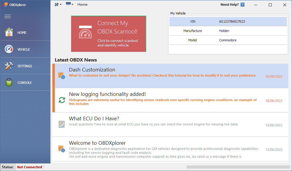

- obdxplorer home screen.PNG (77.5 KiB) Viewed 5496 times
- obdxplorer dashdisplay.PNG (268.52 KiB) Viewed 5496 times
- obdxplorer colourmap.PNG (111.36 KiB) Viewed 5496 times
