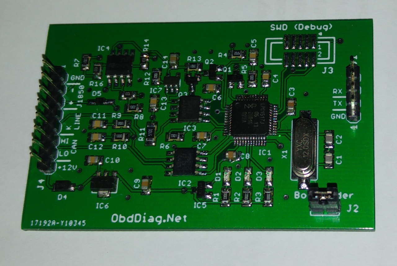

Im getting a couple of these made up to see what they can do. They arnt cheap to make, but the code compiles with no errors or warnings so will be interested firstly to see if it does what it says on the tin. Someone on the hack-a-day article said their fab shop complained that the suplied gerbers are missing the bottom silk screen layer in the zip, but i read that as no printing on the bottom. The fab house i use didnt have any problems with it anyway.

My boards arrived today, but so far no good. The manufacturer has installed transistors instead of 5v regulators. No smoke (it survived I think, but there was heat) so i'll need to source some replacement regs and repair by hand before I can try again. You can see IC6 is a BC547 rather than an L78L05... I havnt spotted any other issues yet, but there may be....
There was also some confusion at the manufacturers about the orientation of the main chip. It turned out the picture on the obd2 board shot in the first post was incorrect and they noticed and didnt duplicate the mistake! I reported this back to obddiag.net and today the pic they have on their site looks correct.
