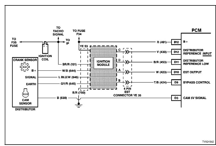

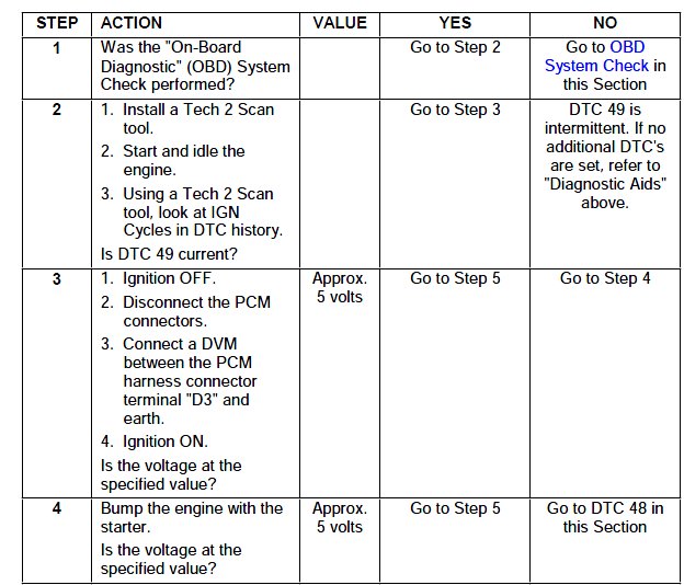

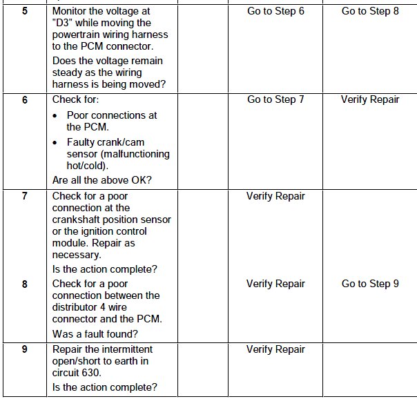

The Circuit is pretty simple, the fault WILL be in this circuit.
The hard part is being an intermittant fault.
all i can suggest is DO NOT fit new earths or replace wiring, chances are you will create more issues.
follow the diagnostic exactly, if it is not an int code you will find the fault.
dtc49 diag 1.jpg (73.28 KiB) Viewed 12314 times
dtc49 diag.jpg (78.04 KiB) Viewed 12314 times

Thanks Rob.. I can assure you that all the checks where done as per Holdens tech manual like you have shown.
But with the crank sensor, coil and Ignition module being replaced not once but three times with new units and the PCM, memcal and wiring harness being replaced with new items, it only leaves "to me anyway" the answer is either power or earth....Unless there is some wire from another part of the car that is causing interference or giving a faulse signal..
