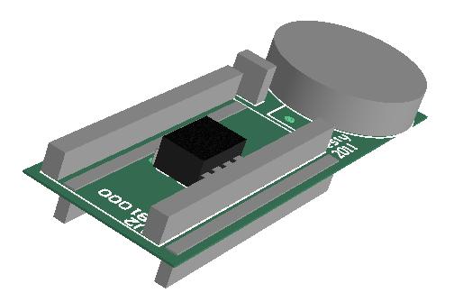

DS1245Y ICs too expensive? Then why not make your own? ;)
Take one 128k low power CMOS SRAM chip (681000,628128 etc), add a memory controller IC and lithium battery,
and you have a DS1245Y-70 compatible NVRAM for about $10.
It programs set as a DS1245Y device, and has the added advantage that you can change the battery when it's flat instead of binning it.
Here's my dead bug style prototype - don't laugh, it actually works :D
I might get a couple of pcbs made up - for some reason that one looks a little too fragile to stick in an ecu, but nothing a bit of hot glue couldn't fix :lol:

A slightly less dodgy looking design - it could also be done on veroboard easy enough.

Re: diy NVRAM
what does the height work out like compared to a nvram ?
festy
Posts: 1039
cars: Alfa Romeos
Location: Narellan, NSW
Re: diy NVRAM
Post by festy »
about 11mm, compared to 9mm for a DS1245Y.
Is height an issue with certain PCMs? I've only played with 808s...
