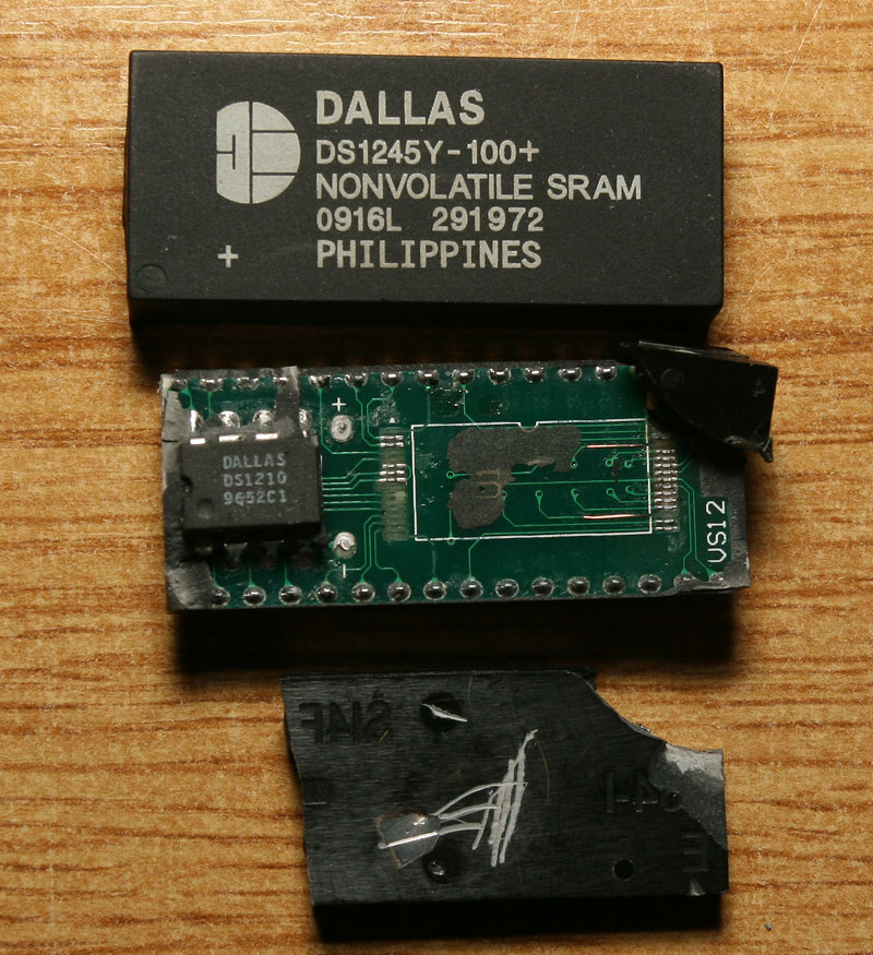

Here's a photo inside a DS1245Y, my fake one died, the battery was dead, unfortunatly the memory chip is stuck in the plastic, but you can see the rest of it, seems the top cap just pops off these and they have areas so you can measure the battery voltage, i tried to see if i could get the battery out but no luck.
- ds1245yapart.jpg (216.46 KiB) Viewed 10847 times

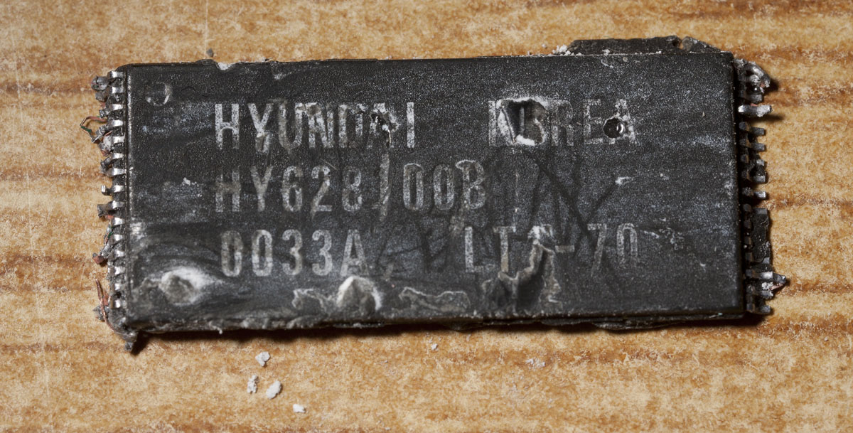

well i sat there for quite a while scraping the plastic off, so here's what's in it.
Henli Max CR1632 3volt battery Hyundai HY628100B 70ns 128K x8 bit 5.0V Low Power CMOS slow SRAM (Perhaps why they have corruption issues rated at 5v?)
Re: diy NVRAM
So are you saying this one was a fake?
That would explain why it had a build date of 2009 but the SRAM IC was made in 2000
Also, that battery is more than double the capacity of the one in mine - probably because the SRAM in yours is the cheaper "high" low power version, which needs twice the current to maintain data retention. Even so, that battery/sram combination is only good for ~6 years data retention, well below Dallas's 9-10 year spec.
And that battery in yours is a CR, not BR - the BR chemistry makes them extremely safe (but expensive), they're approved for use in everything from guided missiles to the space station - unlike the cheaper CR range.
Also, I'd be very surprised to see Dallas/Maxim still using an 8 pin DIP package in 2009 - and a non-RoHS 13 year old IC at that!
Haha, I just found the "datasheet" for your fake - http://chaiper.com/vossel/VS1245a.pdf so answered my own question about it's fake-ness.
They've just copied the Dallas datasheet and changed DS to VS everywhere, including very low resolution copies of the original tables and diagrams
