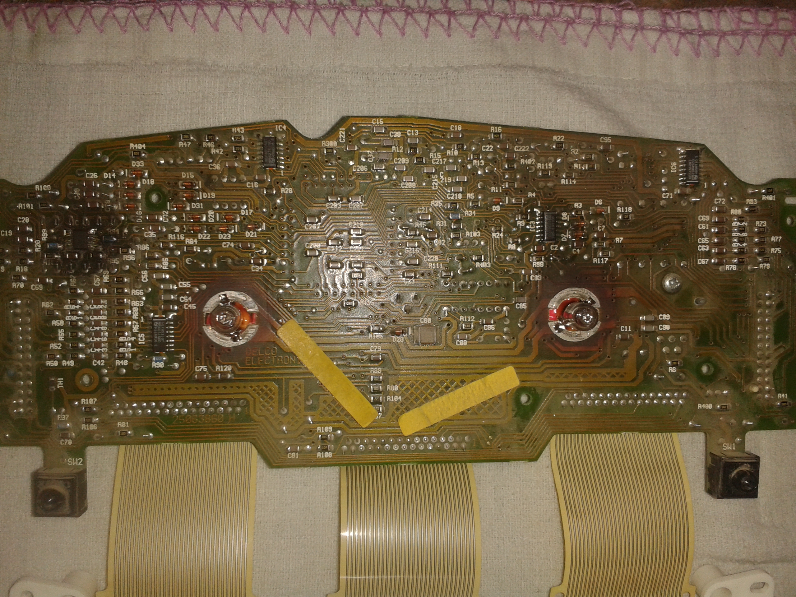

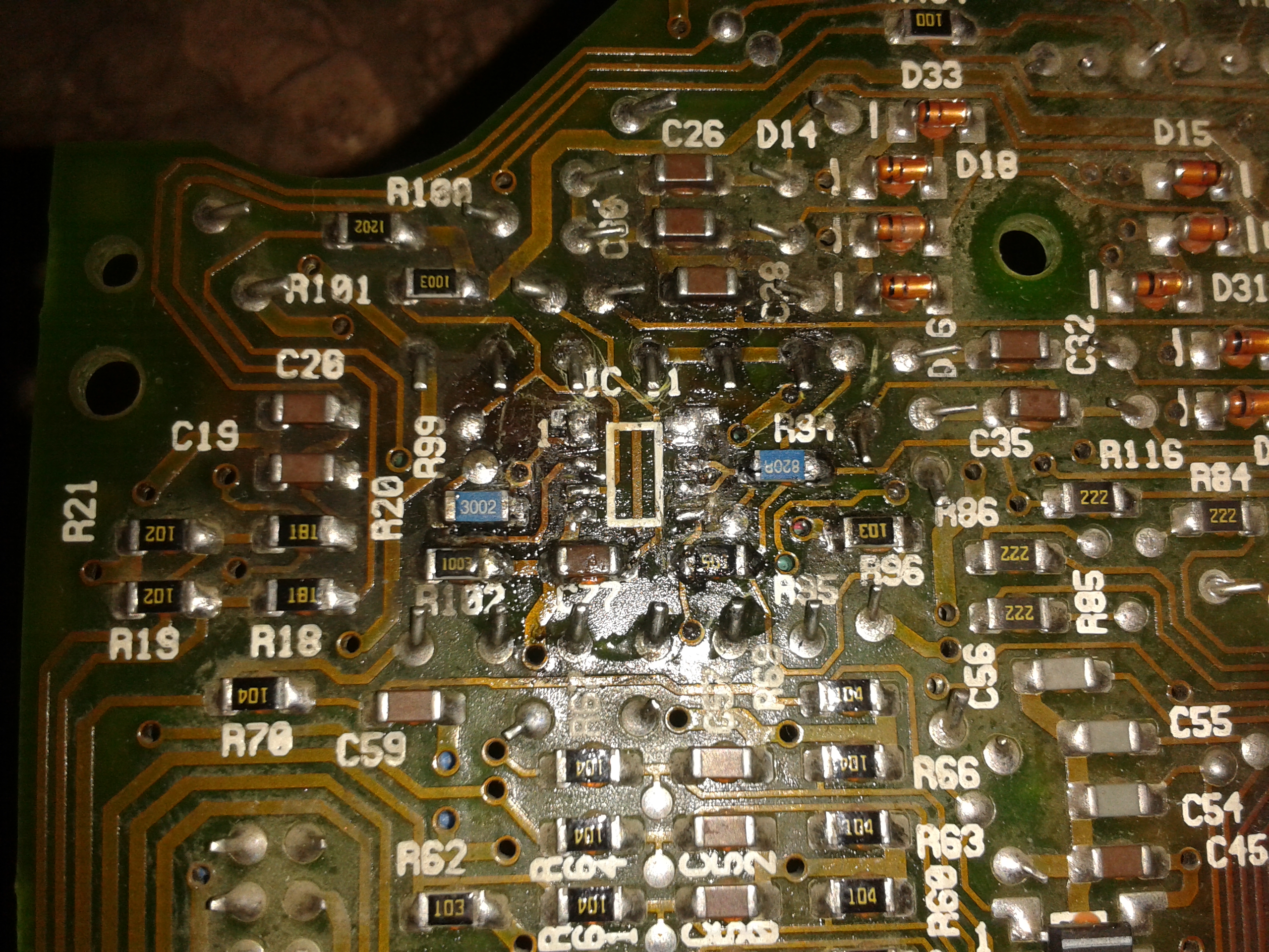

- a close up of the soic in question
- 20130417_211735.jpg (3.74 MiB) Viewed 8572 times

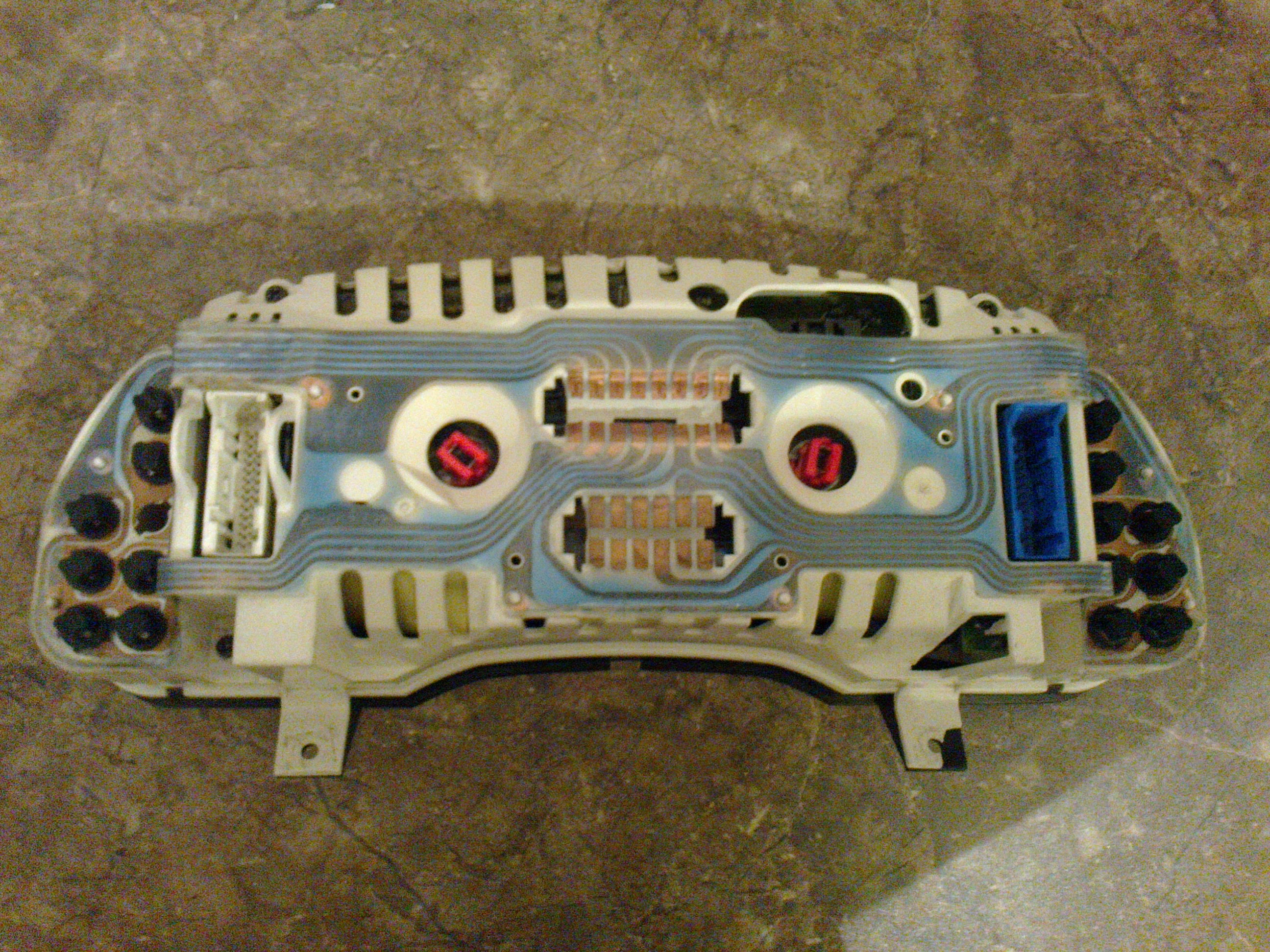

- the rear of the cluster
- 20130417_211707.jpg (3.7 MiB) Viewed 8572 times

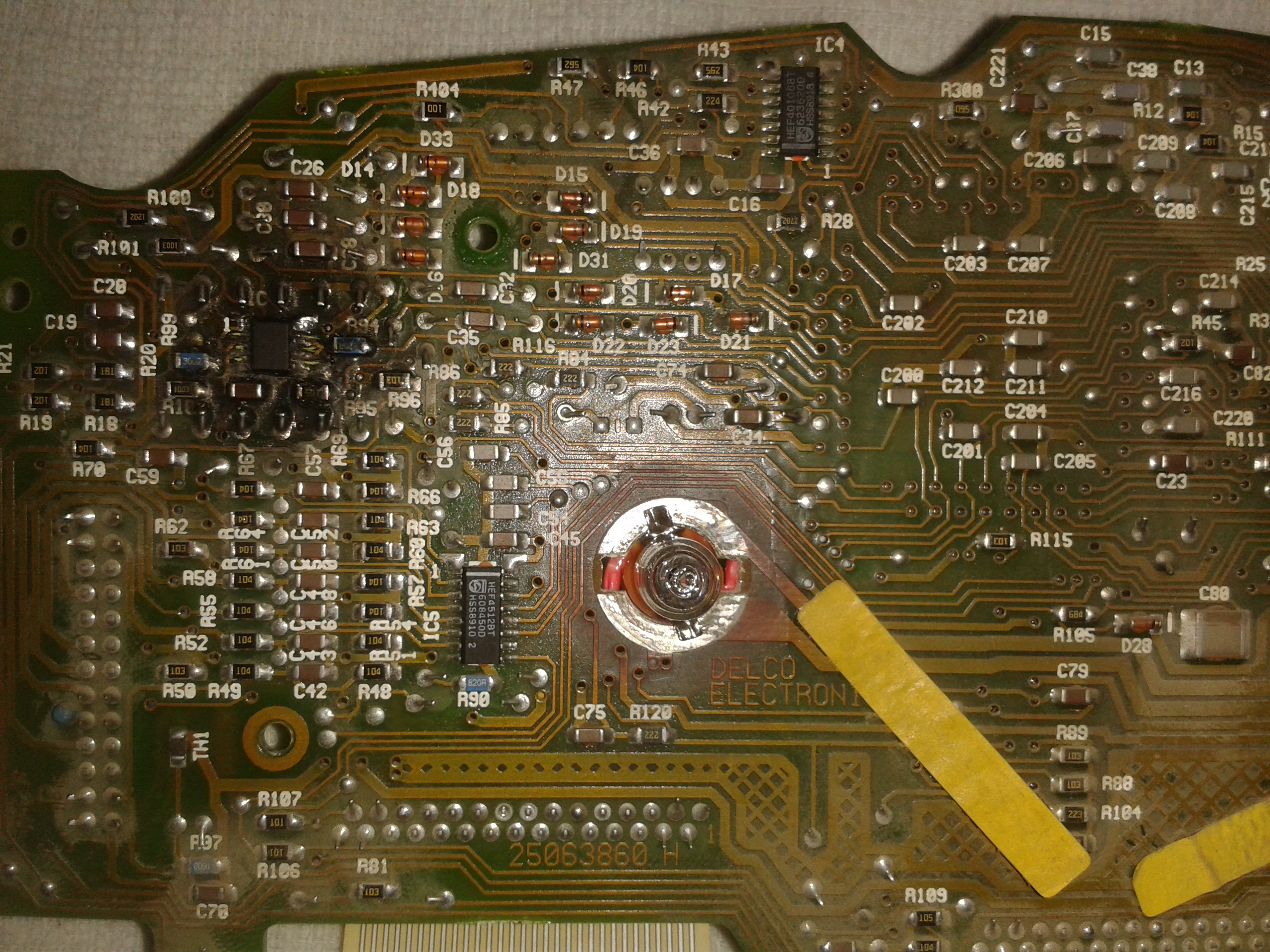

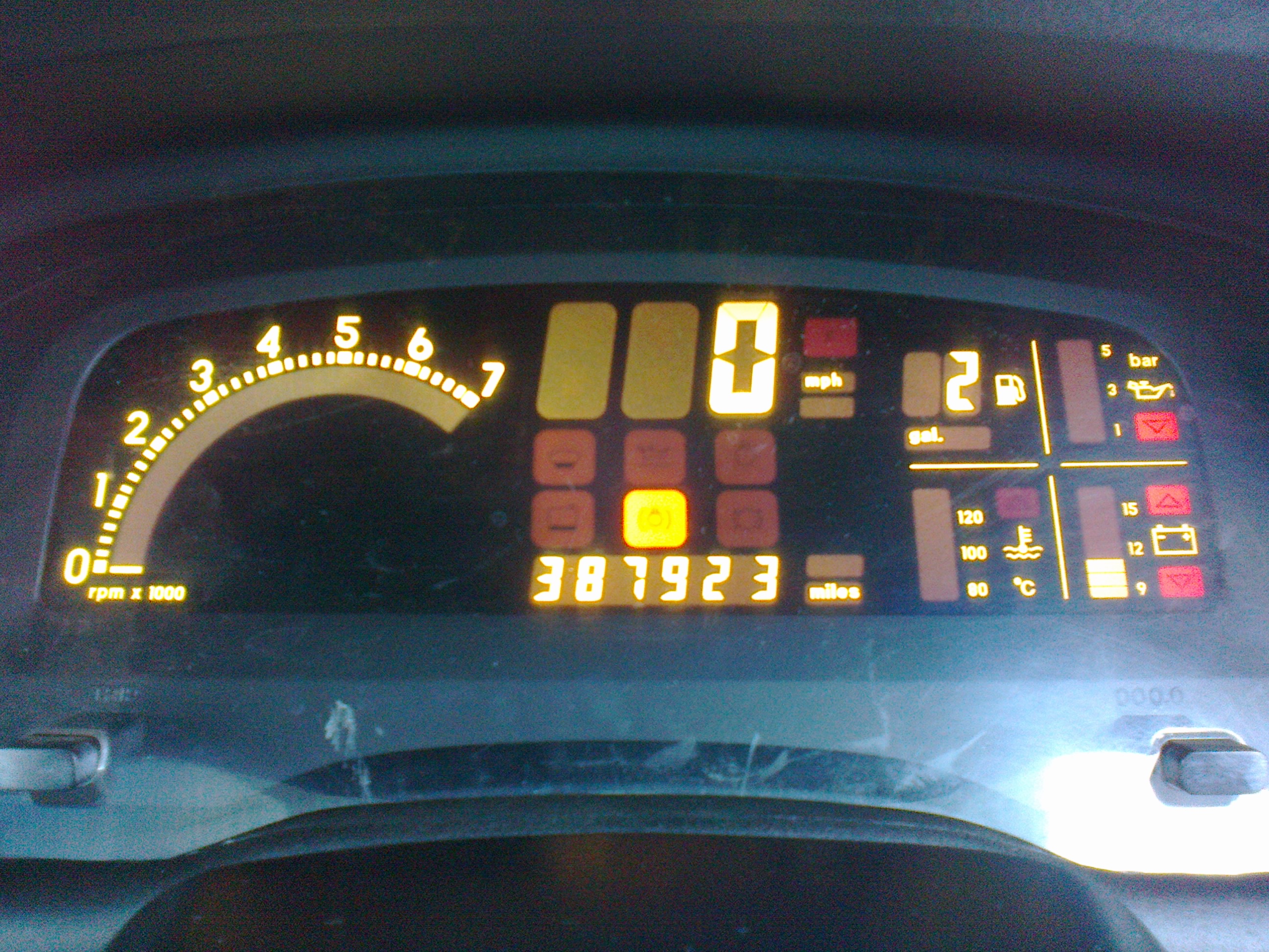

- vectra a lcd dash installed
- Photo0108.jpg (1.69 MiB) Viewed 8572 times

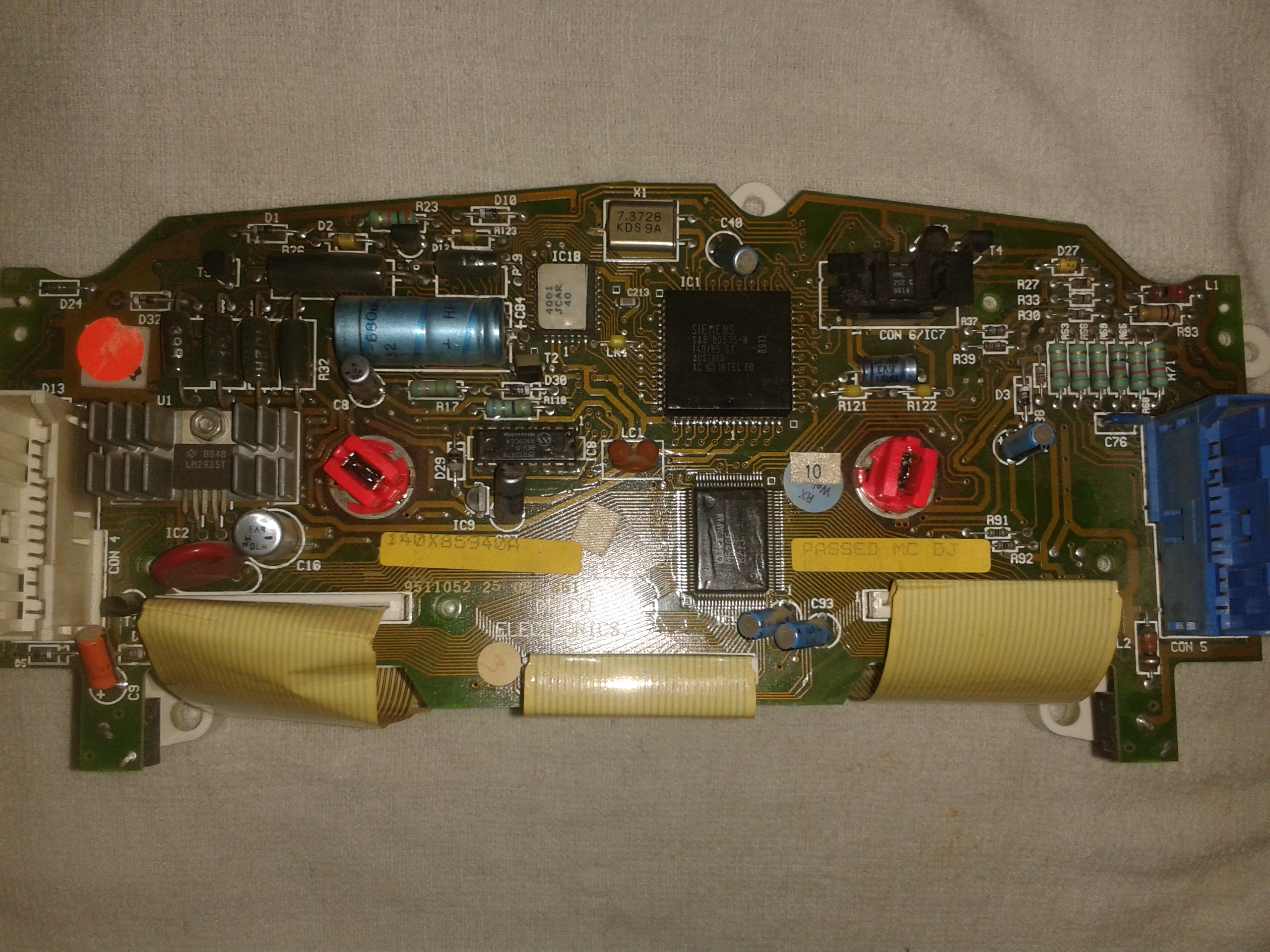

Do you have a photo of the other side of the board? I'm guessing the mcu will be on the back, possibly something like a PLCC packaged HC11 sort of thing, right in the middle of the PCB?
The only ICs I can see on this side are inverters and multiplexers (plus the unknown SOIC-8), so I think the interesting bits might be on the back.
It looks like apart from the MCU there's at least 2 DIP packaged ICs on the back, but taking a wild stab at it I'd guess towards the top middle of the board there might be an 8 pin SPI eeprom, like a 93LC46 in 8 bit addressing mode? I know it won't be a 24cXX at least...
But I guess you've already looked on the back at some point, so what has made you think that this SOIC-8 holds the data? I can't make out the traces around it, but the 6 high wattage resistors/diodes/whatever directly over it on the back and it's general position on the board would make me think it's probably not?

Hello again guys just thought i would add some more pics of this dash cluster. I thought the small 8 pin soic would be the chip that stores the mileage basically because mo matter what car has a digital odometer its nearly always stored n the 8 pin chip plus this chip was blank on the top and covered in some type of plastic glue as if to say its in here but were not going to let you get to it that easily. naive of me to make this assumption but ive got to start some where. the reverse of the chip says KF9658Ki if anybody has an idea of its pin out or a data sheet.

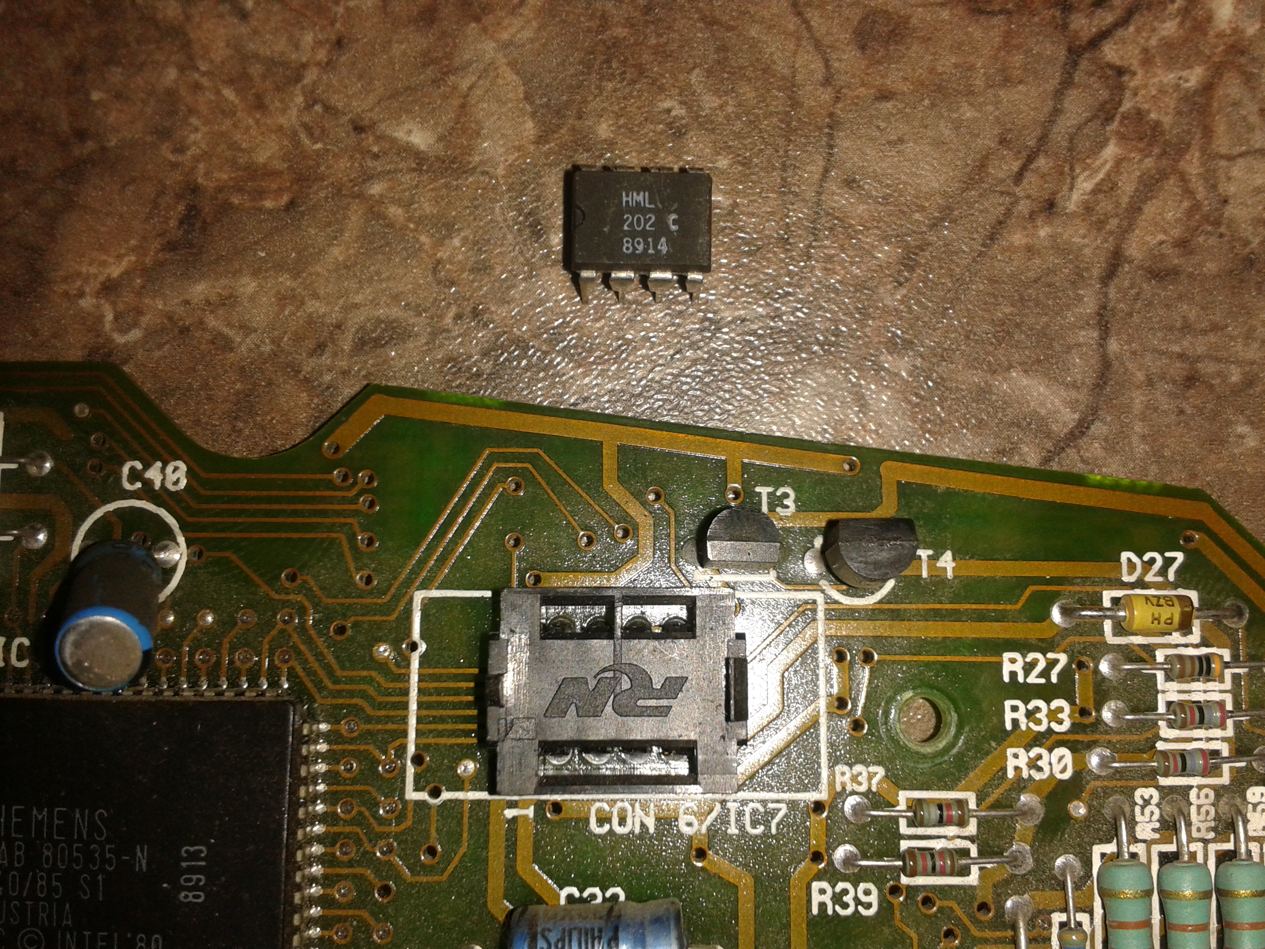

Please note the removable chip IC7 does not store the mileage the cluster will still display the mileage even with that removed or replaced with one from another cluster, cheers
- the reverse of the cluster assembled
- Photo0110.jpg (2.07 MiB) Viewed 8531 times
- The reverse of the PCB
- 20130417_211813.jpg (3.39 MiB) Viewed 8531 times

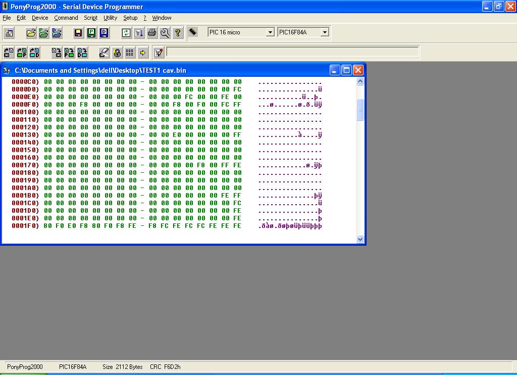

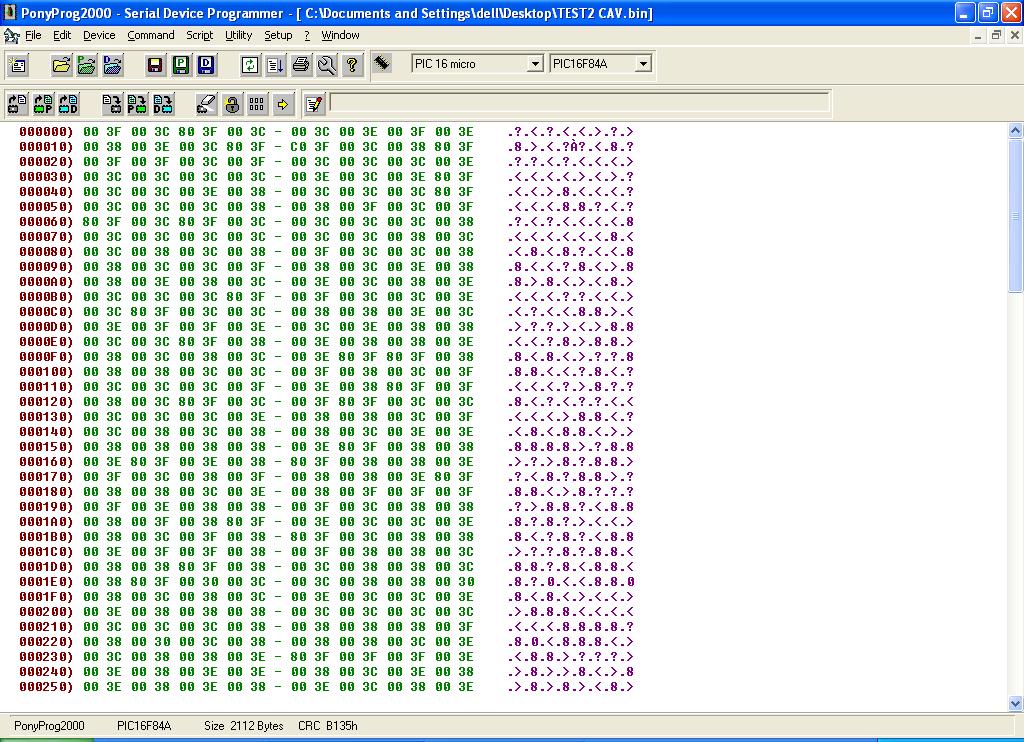

Just to give everybody as much information as possible to date right or wrong i have desoldered said chip and had a read of it using pony prog on different settings, thought i would let you guys have a look to see if you can make any sense of the data.
Im hoping its either correct and somebody can understand or even if its wrong but helps identify the chip so we can rule it out as the odometer store.
Anyway any help what so ever greatly appreciated.

Re: OPEL VECTRA A LCD DASH MILEAGE CORRECTION, HELP!
screen shots
- testcav2 screen shot.JPG (221.89 KiB) Viewed 8528 times
- test cav1 screen shot.JPG (132.63 KiB) Viewed 8528 times

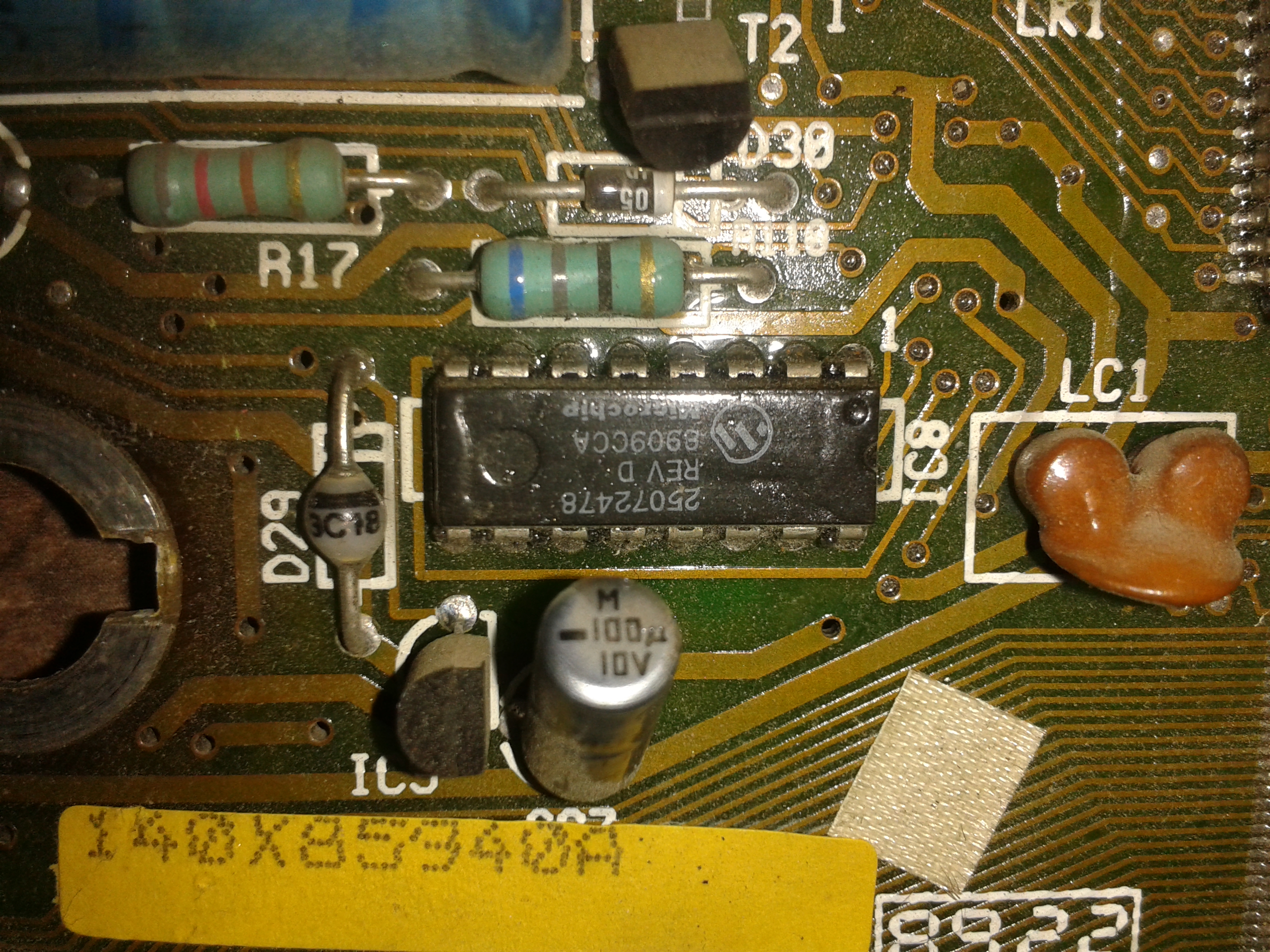

- close up of IC8 on front of PCB
- 20130503_233052.jpg (3.84 MiB) Viewed 8525 times
- close up of con6/ic7 removed (just in case)
- 20130503_232956.jpg (4.04 MiB) Viewed 8525 times
- IC11 8pin SOIC kf9658ki removed
- 20130503_232716.jpg (3.84 MiB) Viewed 8525 times
IC1 = 8052 mcu (i was close...)
IC1B = ROM for mcu
IC8 = PIC I think, I'd bet money on the odo reading being stored on that.
Which means your only real way of doing this would be to reverse engineer the 8052-pic comms and write your own pic code to replace it with - either use a logic analyser on the serial lines between the two, or dump the ROM and I can probably tell you what it's expecting...
Probably simple enough if you happen to be familiar with both 8052 and PICs
Oh - you could try dumping the PIC, but I would be fairly sure it would be protected. It will be a masked ROM with some eeprom which is where the odo reading lives I think.
IC1B = ROM for mcu
