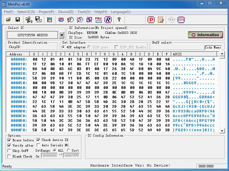

The programming software is in english, and is pretty straight forward to understand, though the help files are in chinese.
The program software does the usual EPROM programmery things.

I have blanked, written, verified and read $12P to several SST27SF256 EEPROM's with no problems.
I have not tried ofsetting the program, as I would have needed a bigger EEPROM.

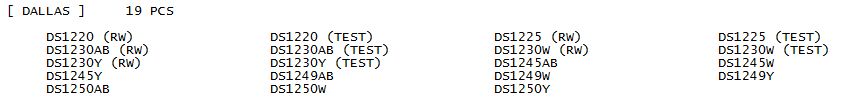

The supported devices list does show the DS1245Y

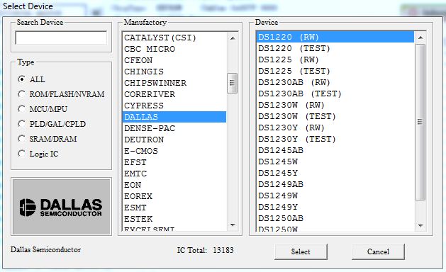

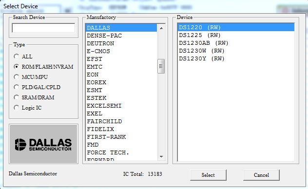

But the programming software device selection does not
You may be right about selecting a similar device.
