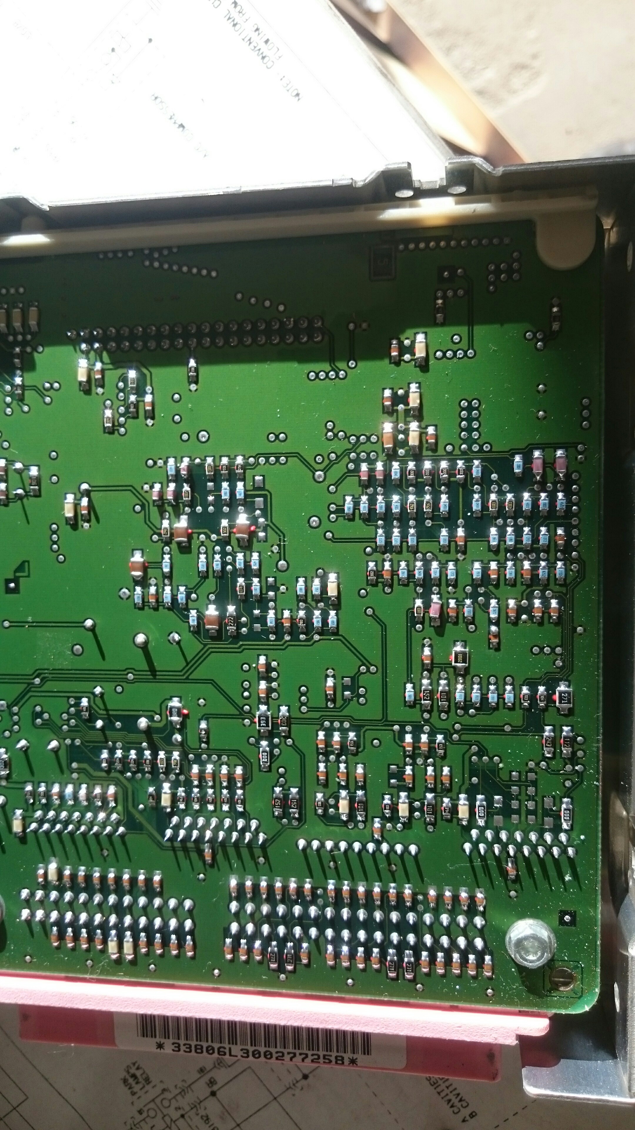

It's a the factory pcm to match the series 2 vs l67 (pink plug barcode starts with 33806L), so according to this site it should only have the hardware to accept the auto signal?:
http://www.kalmaker.com.au/phpbb3/viewt ... ?f=4&t=800
Behind it I'm putting a T5 manual box and having a new speedo cable made to have vss output and a mechanical cable output. I've been told merely changing the tune won't be enough with my pcm, since the computer will still think it's auto (if I use a sine wave generator for the output)>, so I should use a hall effect signal generator and have my pcm modified?
I want to retain the factory vc speedo, so I'm trying to work out what the best way to match up the T5 transmission, and get the memcal tuned, etc.
If I've missed anything or more info is needed let me know please.

Open it up and see if the parts are installed .. https://pcmhacking.net/forums/viewtopic ... =728#p6018
Need to add these if not .. viewtopic.php?f=7&t=1377&p=15740&p15740#p15740

Righteo, thanks for all the replies guys and sorry for the slow one. Finally got down to the shed today and popped the ecu apart. Judging by this pic and the links you've supplied it looks like I've actually got the bits on the board I need for a the manual input, yes?
So I should only need to tune my memcal to delete VATS and check the manual flags yes? If I get this done will I need to get a Hall Effect signal generator? Or will the computer be okay with a sine wave VSS and manual flags checked? I've been told it chucks a hissy fit doing this.
Thanks all, if I've missed anything please let me know.
