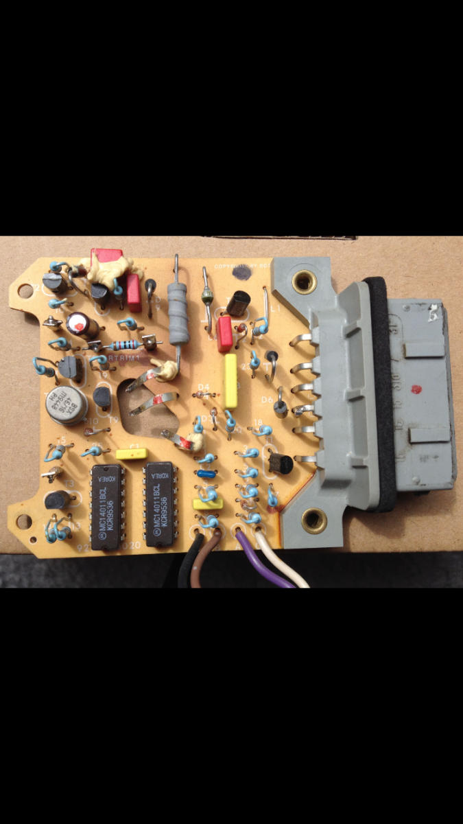

I've got a faulty one dismantled and set up which has now mysteriously started working again
I was going to try and work out what was wrong with it but I've been lazy.
See my post here: https://pcmhacking.net/forums/viewt ... =31&t=5406

I believe the fault with mine was the transistor that drives the main power transistor (silver round metal case on LH side of my photo - BSX 46/16) but haven't been able to prove it because it started working again.
That small metal case transistor is driven by an even smaller transistor (LH bottom of photo) which is driven by the 2 logic gate IC's (2x DIP IC's at bottom of photo)
