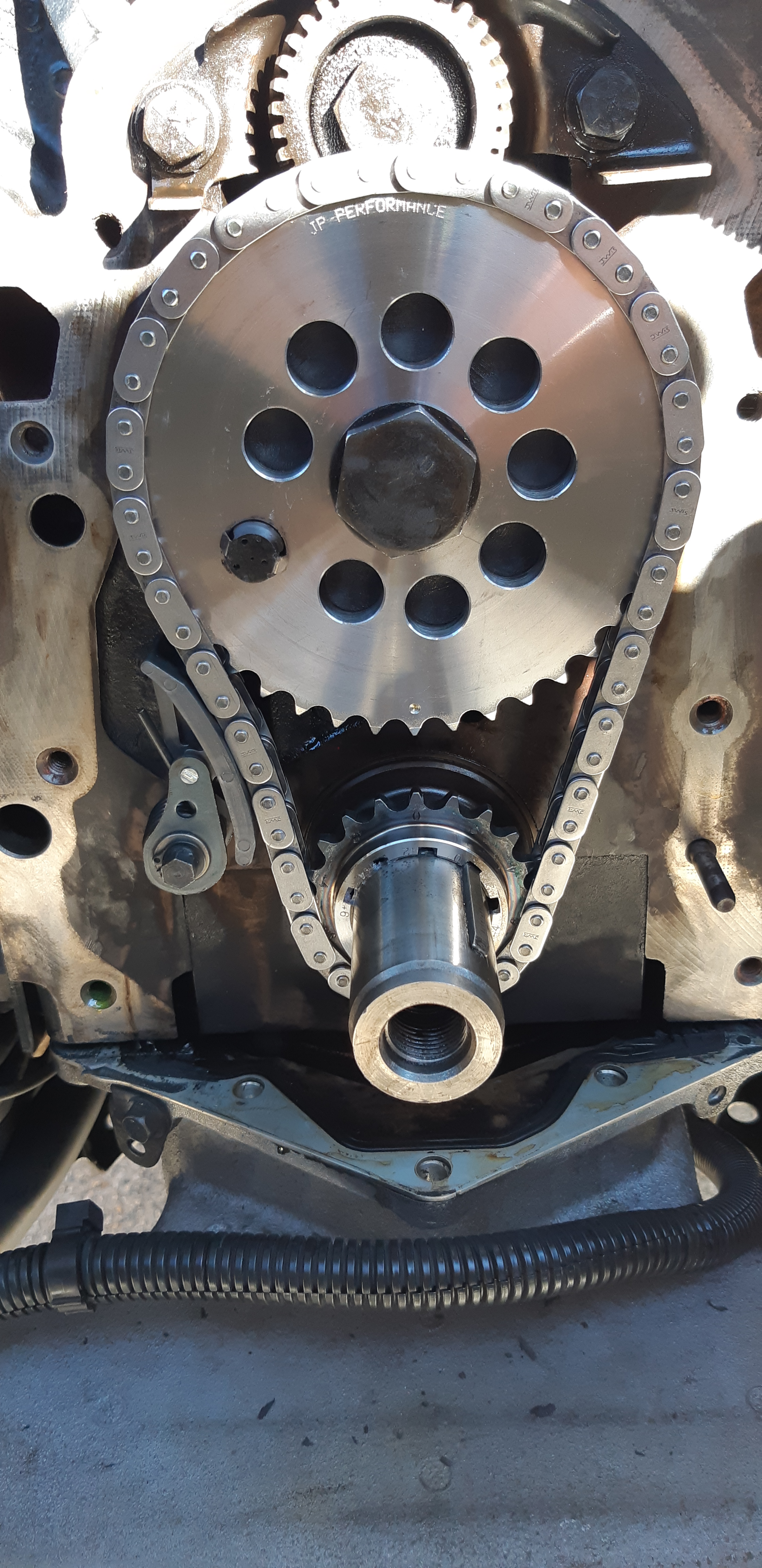

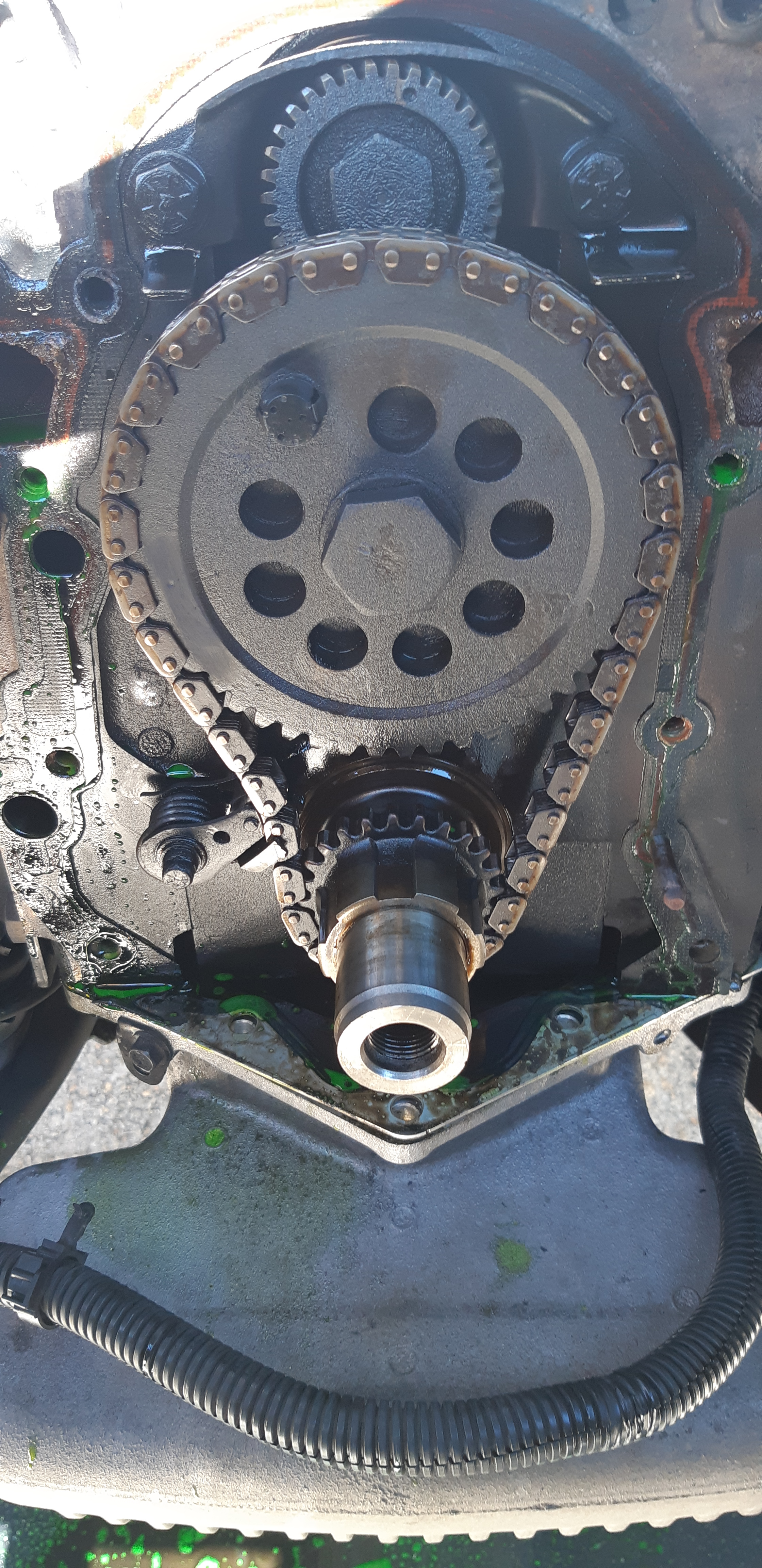

Finally managed to set aside some free time to do the timing chain. Well the tensioner guide is completely gone. Fitted the new crow timing chain and new tensioner. Sprocket says JP and I wonder if crow uses their stuff but package it under the crow name. The gasket the factory ecotec uses on the timing cover and oil filter housing is really good, can't seem to find that style anymore, all paper stuff.

The tensioner was certainly well worn.

That tensioner is about what to expect from a high mileage engine. Intense and ZZP do original gaskets.

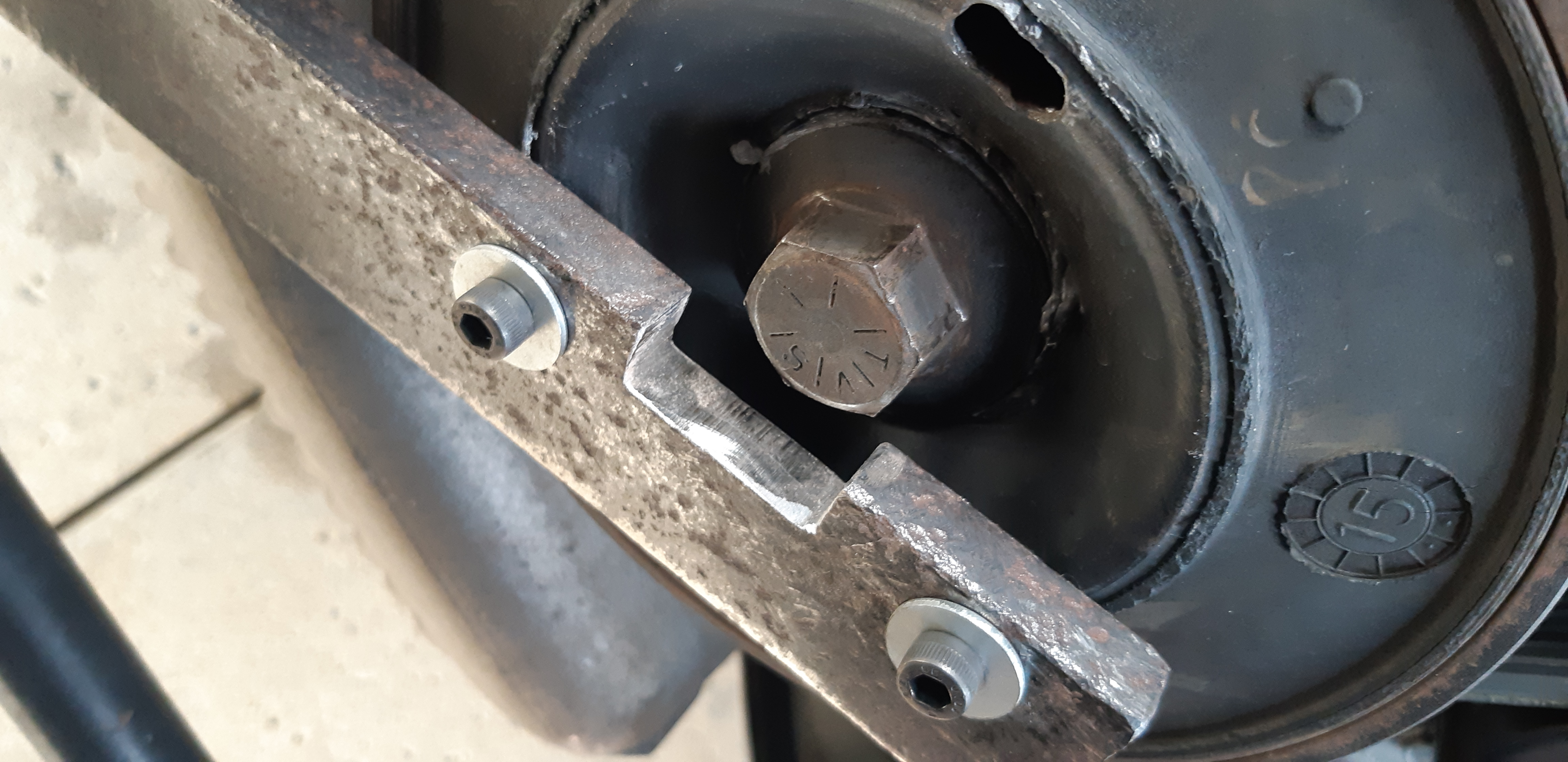

The harmonic balancer bolt, what is the red stuff under the bolt flange on the inside? Thread sealant? It's like a orange/brown color to stop the oil seeoing past I guess.
It has a small amount of rtv in the balncer keyway from someone who removed it before.
Posts: 6518
Re: VS Ecotec Timing Chain
Postby vlad01 » Wed May 29, 2019 8:55 pm
Thats a pre applied dry sealant.
Just add a very thin coat of RTV or loctite flange sealant under the head of the bolt and torque to 300Nm.
If there is RTV on the keyway then someone has been in there and incorrectly applied it. It should only be under the head of the bolt.

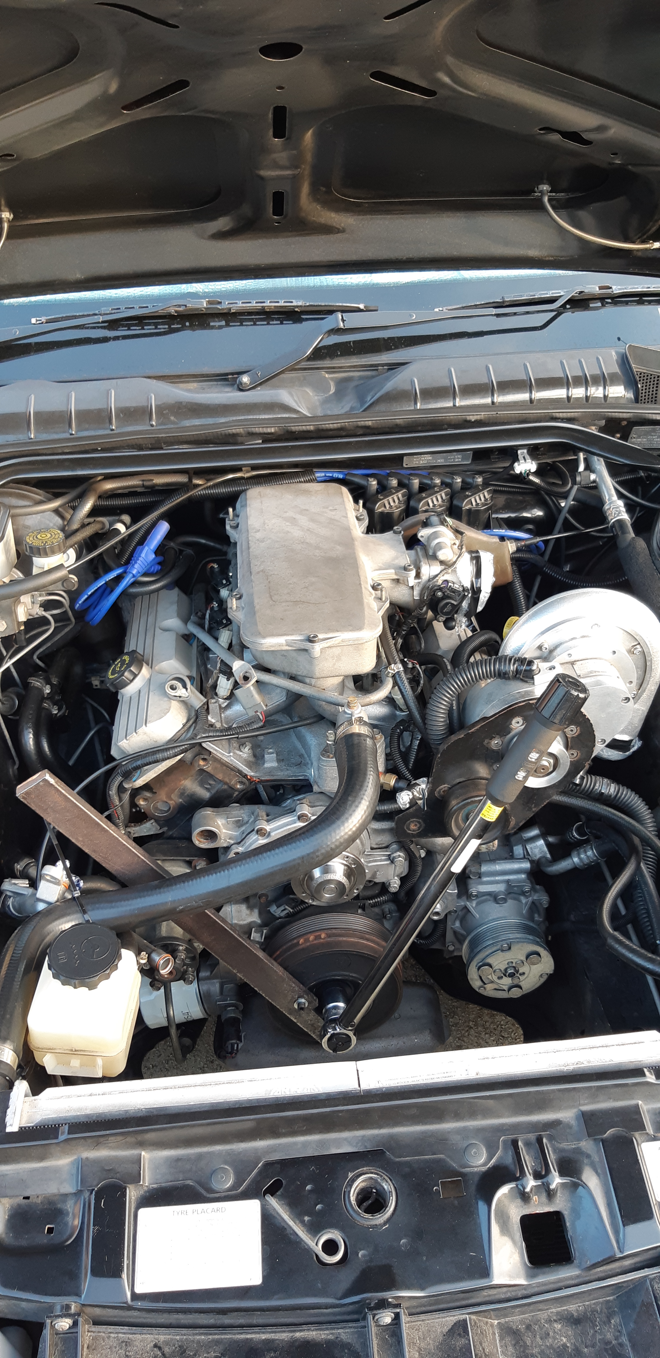

I did put a very small amount rtv under the bolt flange where that factory stuff was. The rtv in the balancer keyway is perfectly shaped to the key on the crank, no excess rtv protruding out of the edges nor any on the crank key or shaft at all, looks like it's been put there when made from the factory. There is no other rtv inside the balancer bolt hole.
Made my own bar to hold the balancer to torque it to the 300nm spec. Makes life easy.
