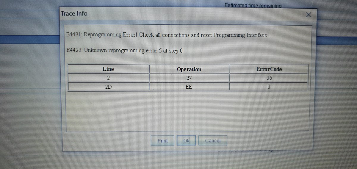

Thought I'd try a subscription....no good :(
