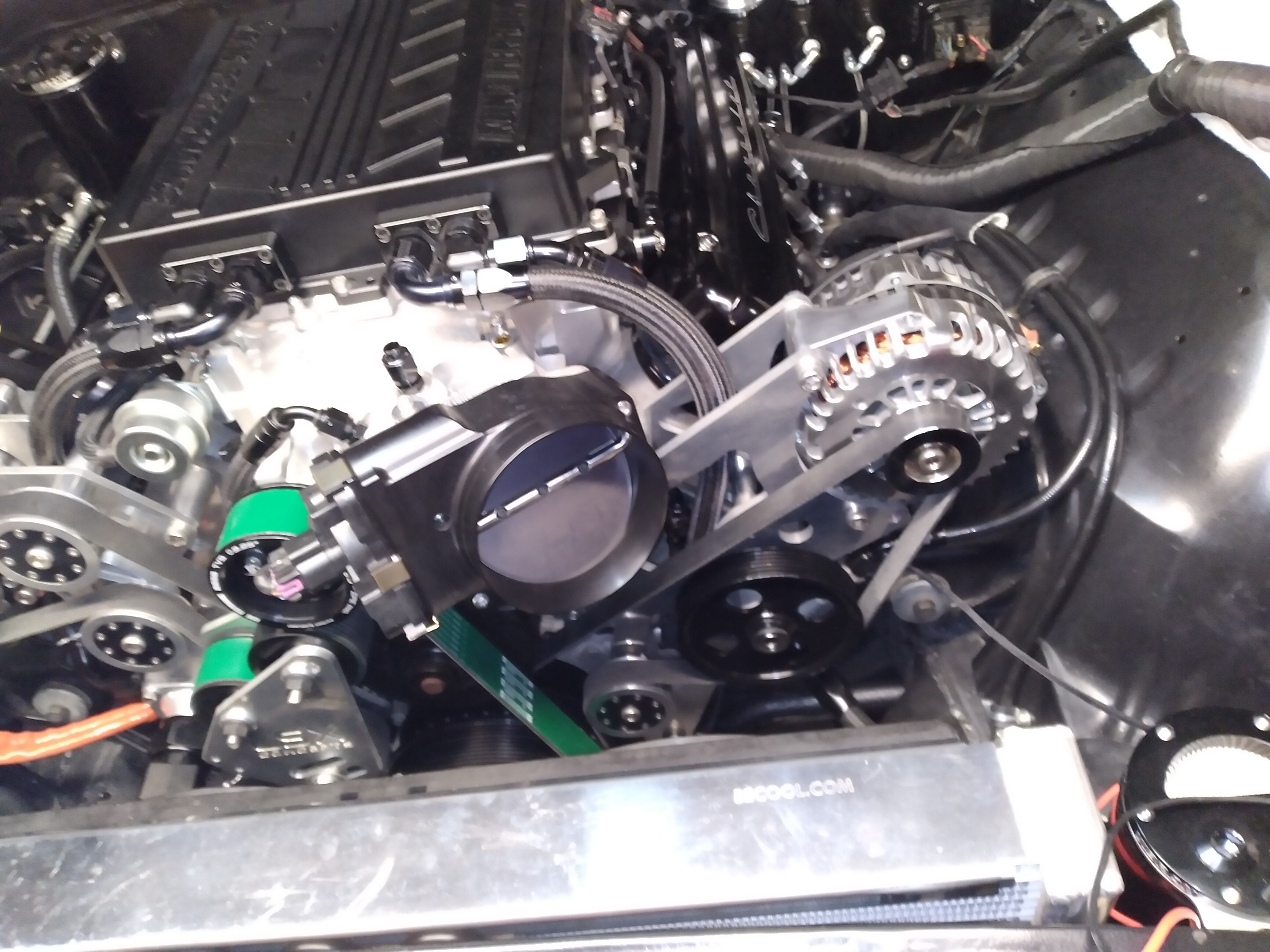

I am out of town(Vegas) working on a 69 Camaro RS/SS Convertible LS swap with Kong 2650 supercharger. This thing has a G8 pedal so I assume I need a G8 file for the ECM(I do have the slave modules for it) The only file I have, I think is corrupt somewhere. I have Tazzi's wonderful software so a full clone usually works great but I'm thinking my file is fookered, it was a download from the net
If any of you have a stock .bin file or two or ?, I would sure appreciate it. I can check the cvn's to make sure file is stock if you are unsure. I think '08 is 6l and '09 is 6.2l, doesn't matter to me as I have to make major changes anyway. I just want to start with known good
btw, sps file doesn't have the parameters section, need a full flash read from ecm.

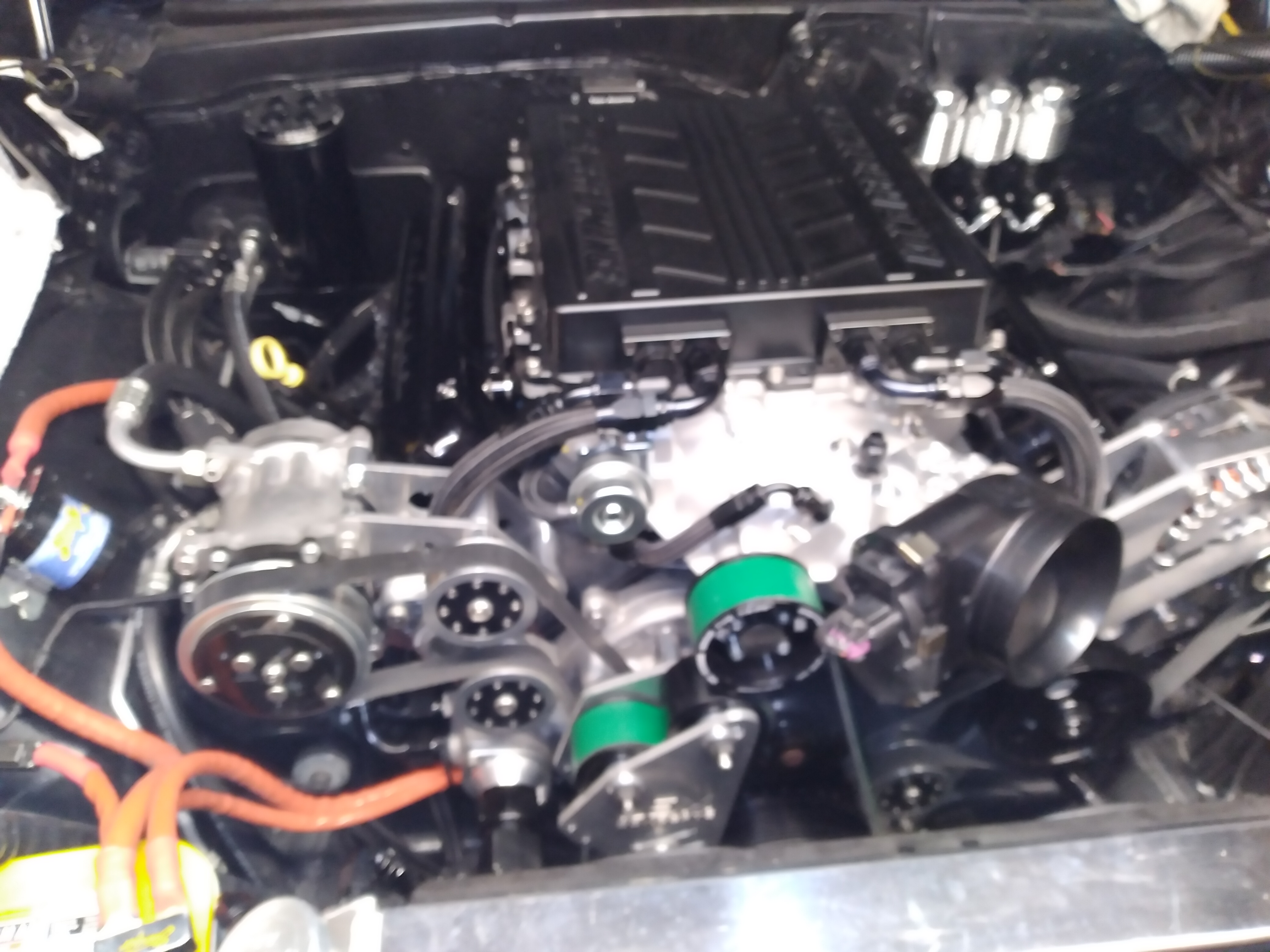

Just a quick update since I having been fighting many many wiring issues(not mine). I appreciate all the help and when I get home and can try many more things on the bench, I think more will be discovered. As of last try, I still cannot do a full clone with any of these G8 .bin files. Meaning as soon as I shut off for a period of time, The seed/key vin and serial goes fubar. Right now I have it running well using a cloned(stock seed/key vin and serial and the rest of the damage in the parameters, lol) 2011 camaro stick OS and cal changes. I am still using the G8 Slaves and pedal stuff, all works well. Learned a lot on this road trip
This guy needs to get it to the a scheduled out of state upholstery shop and I need to get home to take care of a lot of fires It runs pretty good on speed density VVE and I will work on the 5" MAF transfer function the next time I see it. Again, 69 SS/RS Convertible LS3 swap, supercharged, 112mm TB, 5" cartridge MAF tube.

Man, Bro... I feel ya. I just get flown in to fix crapola.
Pretty much done with the wiring, the IAT has the wrong transfer function and the VSS no worky, but should have that corrected today. Probably next trip we will put an AEM infinity in, start over, do some traction control stuff, etc, etc. Of course all of it can be done with GM stuff but we might as well do it all with one box. Pectel box is nice too. Dunno yet.
