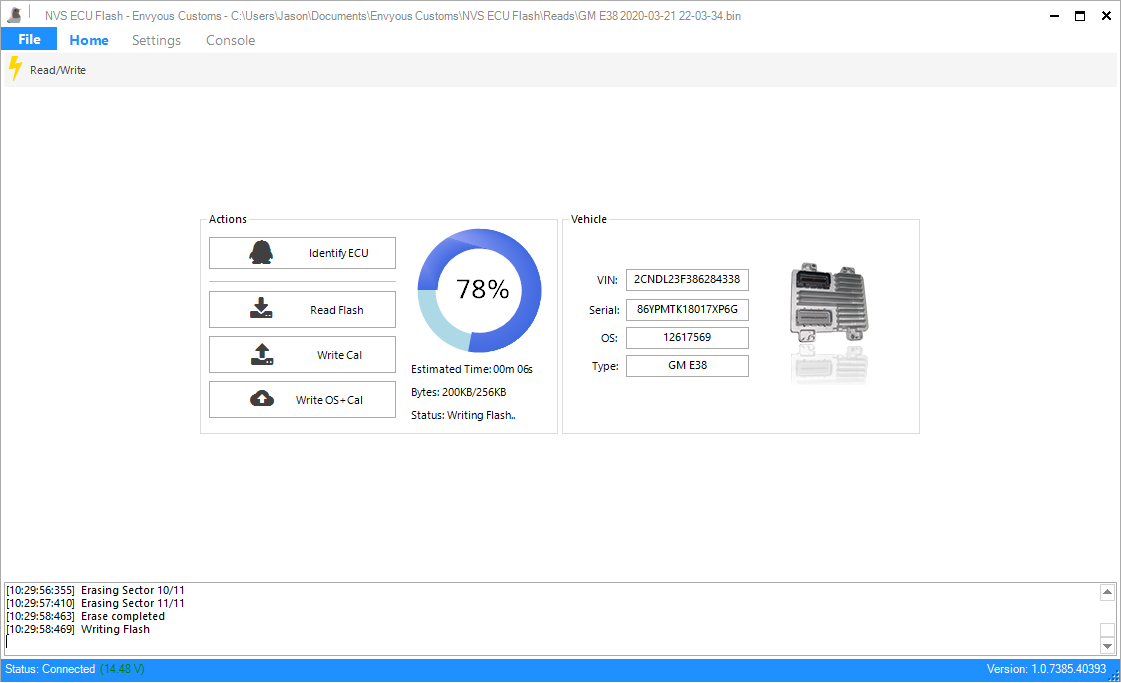

Ok so.. ECU identification for both E38 and E67 from opened bin files implemented.
It will check the bootblock part number for the initial identification, then proceed to check file length, operating system and also CRC/checksum to ensure file is valid.
The CRC/Checksum I haven't 'fully' got in. I did a bit of a hack and force set the segment locations. I dont 'think' these actually change locations for the E38 or E67, but its not good practice to assume they are always in the same location so will read from the boot block and process.
Read files will also be scanned and validated, unknown operating systems (for now) will be prevented from writing and same for any with invalid CRCs.
Things left:
1) Validate the ECU connected is compatible with the opened file. This is just a simple check of ECU type and OS.
2) Fix custom tuner lock key. I didnt await the user form result which caused an infinite loop of 100+ forms opening until it crashed the application :lol:
Cosmetic changes include docking the log box to the bottom, and a little image of detected ecu on the right.

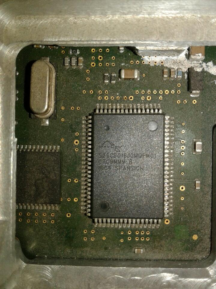

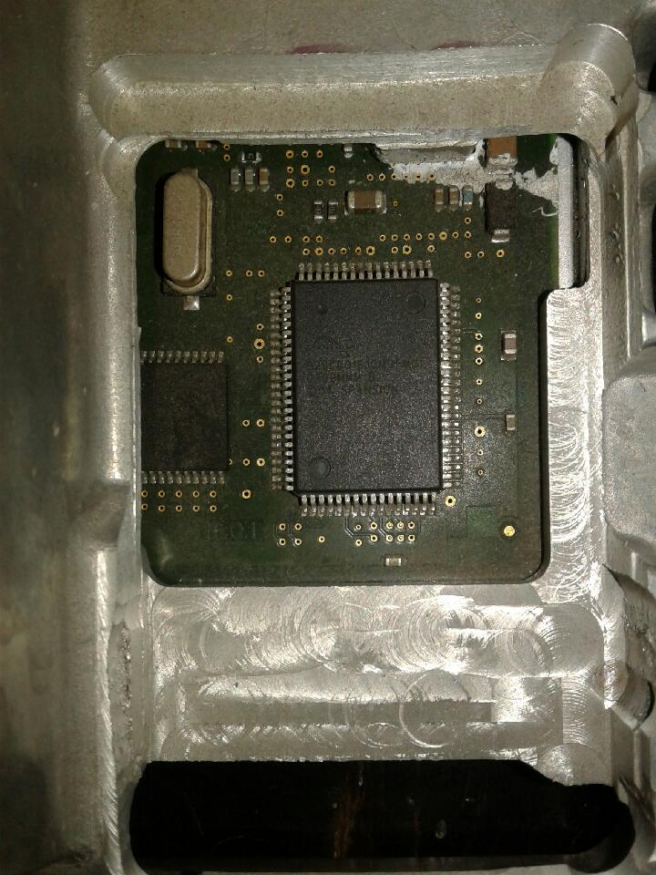

Curiosity got the better of me so I put one of these E38's in the mill. Do I need to keep going or is this the flash? Looks to be a Spansion s29cd016j0mqfm01. So, where's the "reset, boot mode" pin? :lol: or is it accessible from the bottom removable cover?

Thats the flash there!
Iv tried pulling pins down low ect but it never goes into a 'recovery' state.
Interest bdm document through, havent seen that one before
