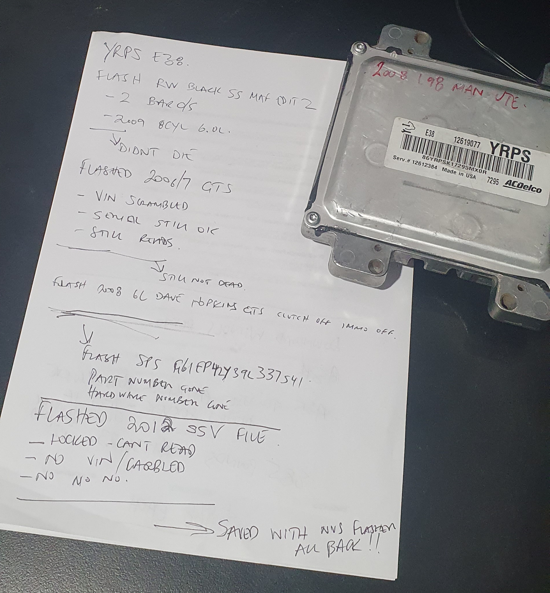

Tried and tried to rebrick one of the ones here. It was a lot harder when you're purposely trying to do it haha
Check the notes
