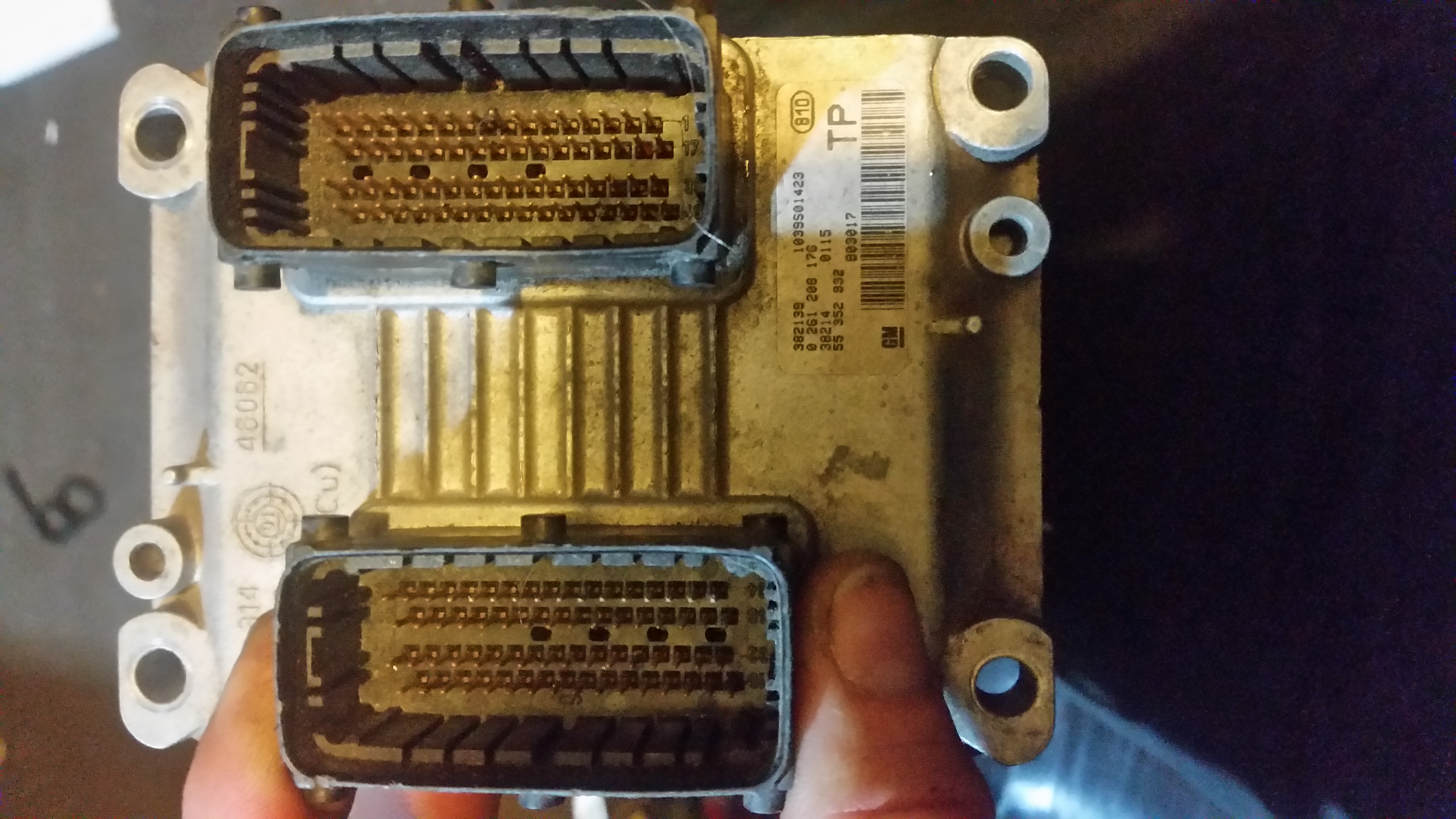

Isnt that an me1.5.5 ? I have the exact same ecm on 3 ts astraG turbos z20let
I thought the AH astra had either simtec 71.6 for the 1.8l early and simtec 75 1.8l direct
Bosch motronic me 7.6 was on the turbo ones as they use can instead of K line z20ler z20leh
They look the same externally but the ts on that one
Tells me thats not from an ah.
Anyways carprog will do the me1.5.5
But doesnt do me 7.6 so I will give it a try on my z14xep
That has a hybrid me7
Ill let you know how it goes
Ill use mdi2 and tech 2 win to see if it unlocks and relinks

Postby TEN_K » Thu Nov 19, 2020 5:42 am
Ahh I seem to have made a mistake. The ecm on my ts have TP on it not TS lols.
Btw the z14xep ecus that I have all say qy and qm
Anyways ....
Whos been reading the the ME9 function manual from trionic? I've been trolling over it and the command that requests the download of the memory sections is the routine which Im sure will finally have this mystery solved
Me1.5.5 ts astra turbo

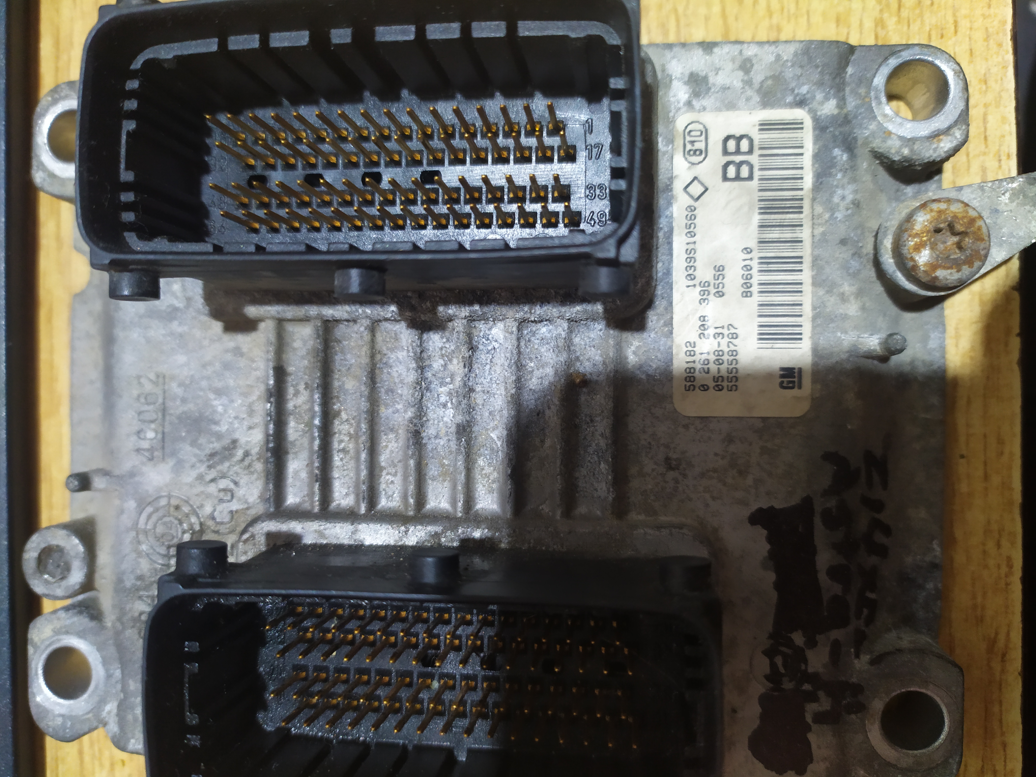

Posts: 4456
Re: Astra H E55 ECU Pin Reader
Postby The1 » Sat Nov 21, 2020 11:23 am
sorry the photo is a internet rip one, here's the one i have here on my test bed from astra H with Z14xep.
